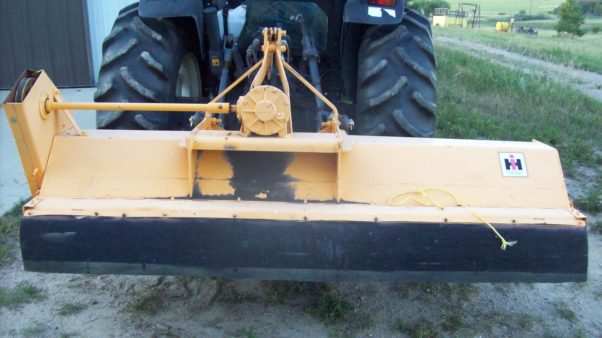

Hello everyone! Brought home a 90" wide (roller) flail mower. It is highway yellow, a 'bit' worn, and has an IH sticker on it. It also has IH and part numbers stamped into the pulleys.
That is the only markings on it. One belt drive. Other than moving the pulleys back in (they are working there way off the shafts), everything seems to roll correctly and the flails (the typical v type) look ok as well.
Here it is (more pics later): International Harvester Flail Mower - eBay (item 190429190393 end time Aug-16-10 10:24:00 PDT)
I haven't found the magic Google term to figure the model out. Any ideas?

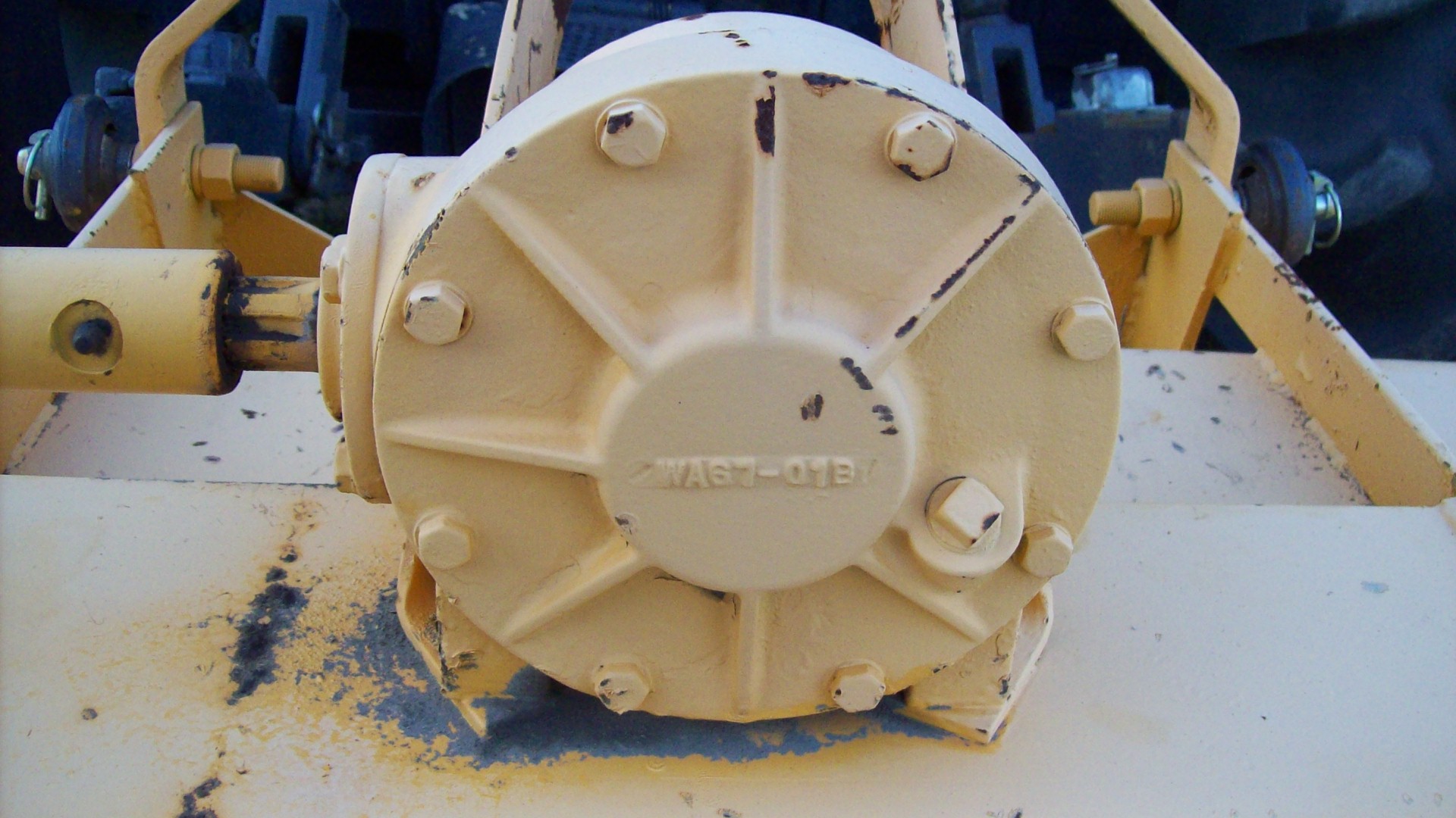

You have bevel gear and ring gearing set on this one by the looks of the round gearbox.

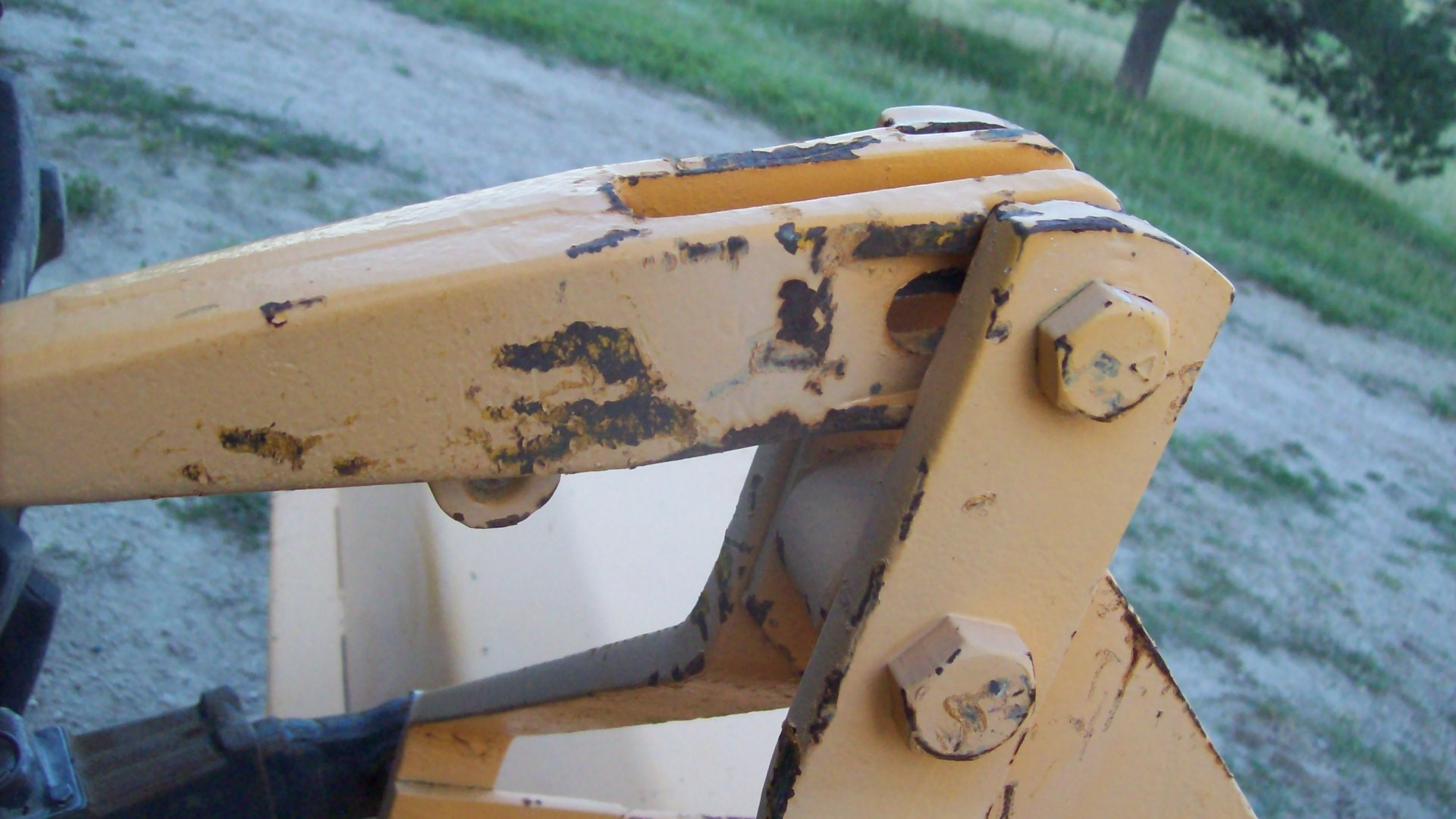

If you have top link on your tractor I would remove the one already on it as it will only complicate things.

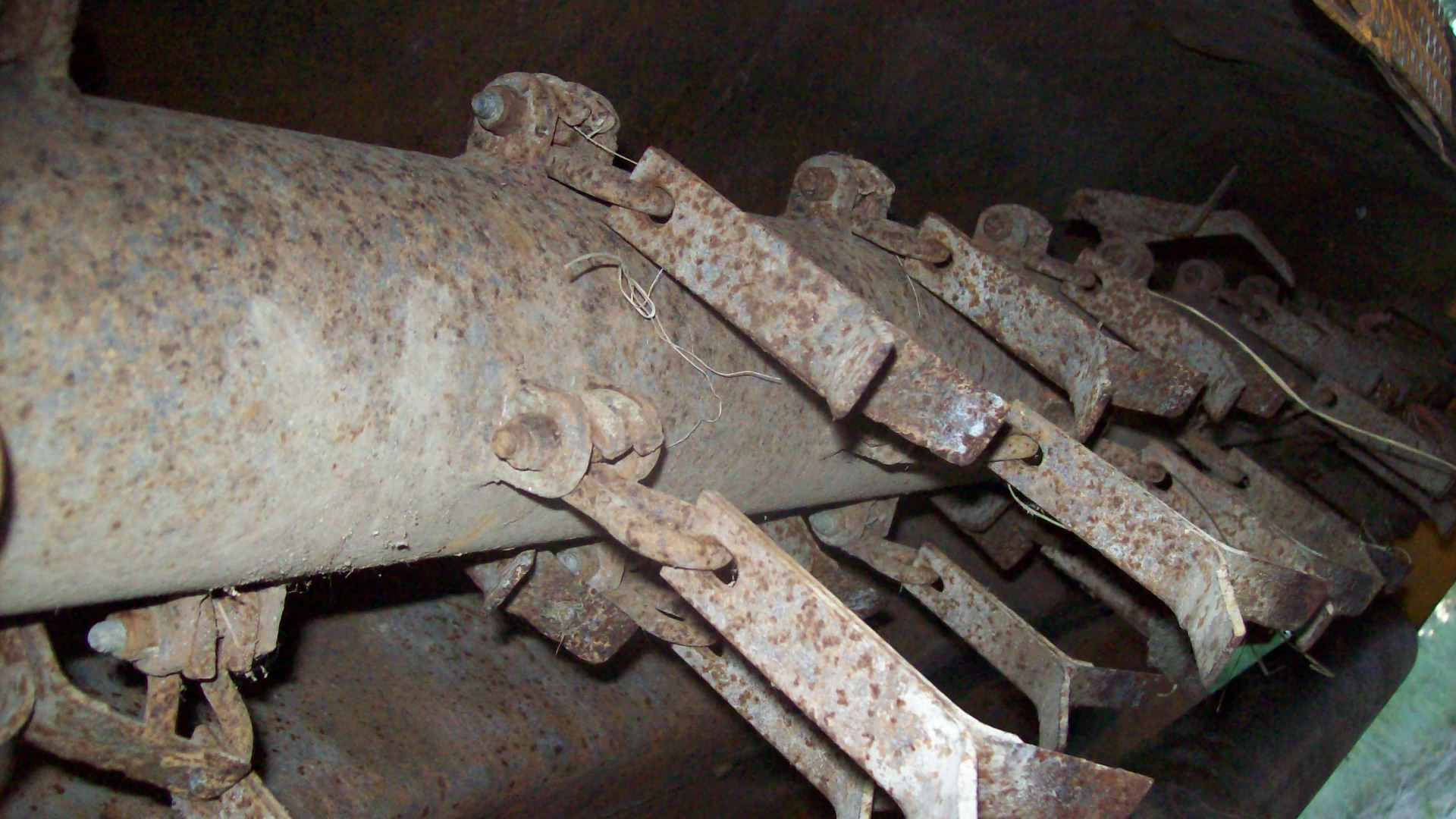

The grass slicer knife blades are referred to as a Y blade as they look like a capital Y when paired at rest.
Are they the small grass knives or the very long ones?

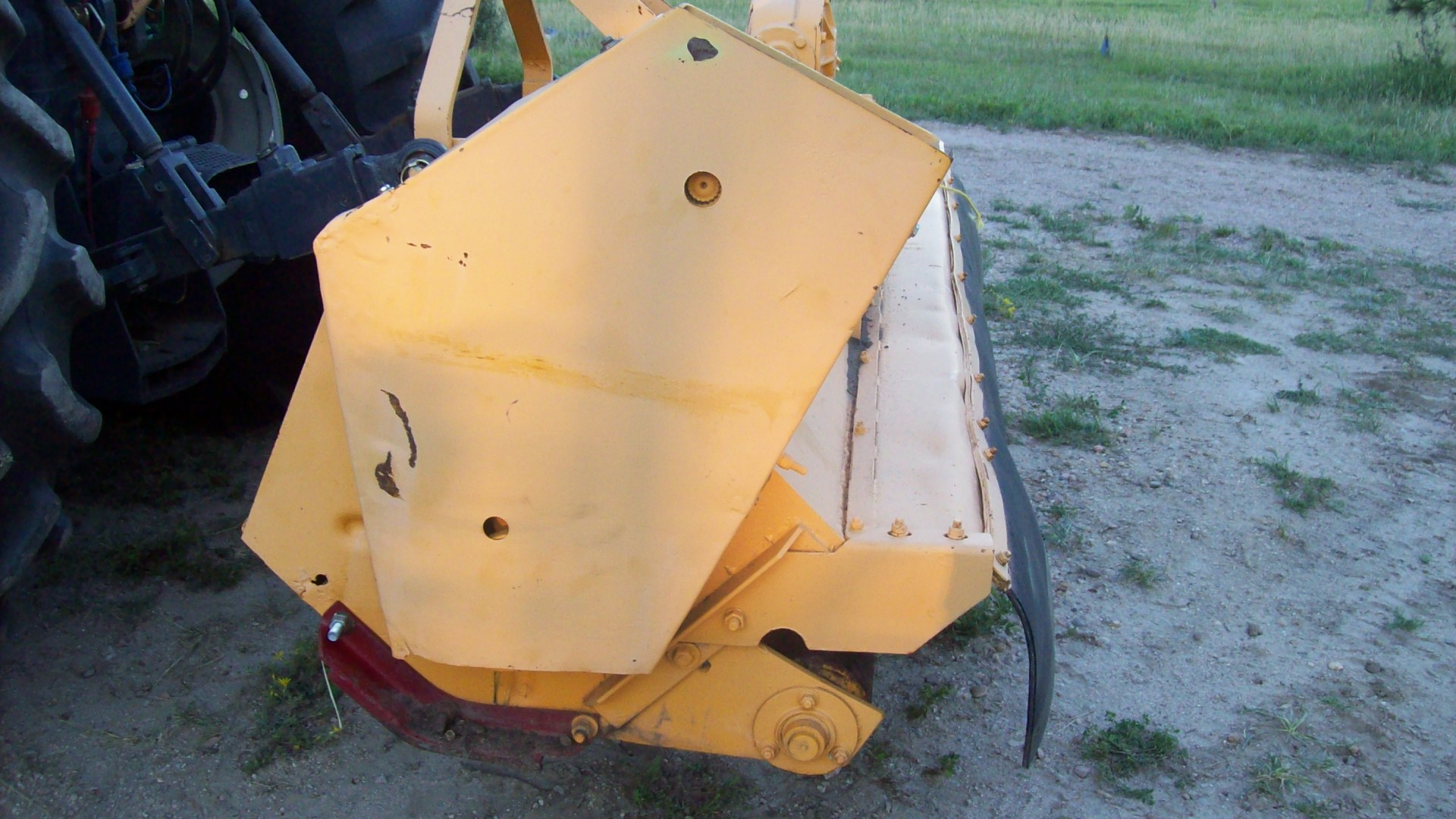

The belt pullies will need second look- The set screws may have backed away from the key stock if set up that way.
You may need to drill a hole at the point where the set screw contacts the rotors stub shaft and that gives it something to grip to. you will need new set screws anyway for piece of mind and be sure to use a singledrop of blue Loctite on the set screw threads.
a. if the belt loses rubber when you hold it with your hand the belts need to be changed as the they are worn and the rubber molding is weakening.
If you can by the web belt for that size locally should do that, or if not buy the gates green belts and be sure to buy them with the same lot number on each belt.
On the belt guard side of the mower there are grease fittings and they are usually buried in rubber chaff and dust and need to be exposed and greased.
The end bearing which supports the first driven pulley from the gear box will have a grease fitting and need to be grease when you mow as well.
be sure to check the oil level in the gear box too- if it looks milky it has moisture in the oil and should be drained and replaced.

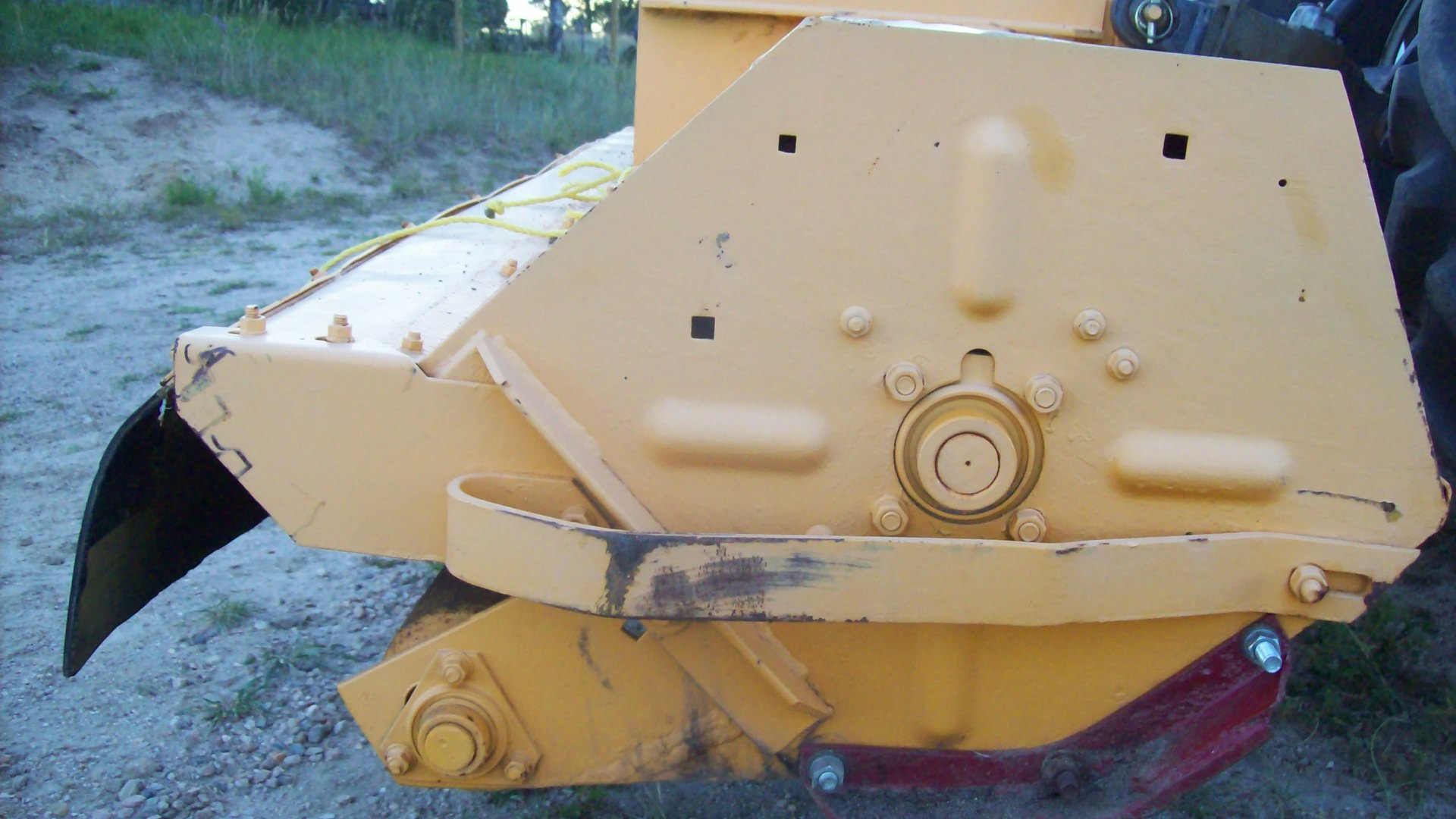

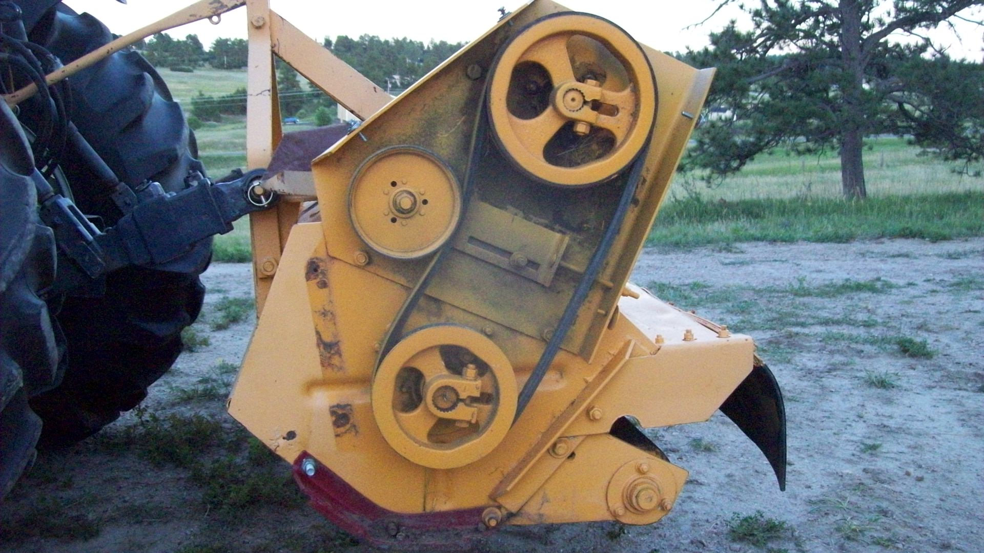

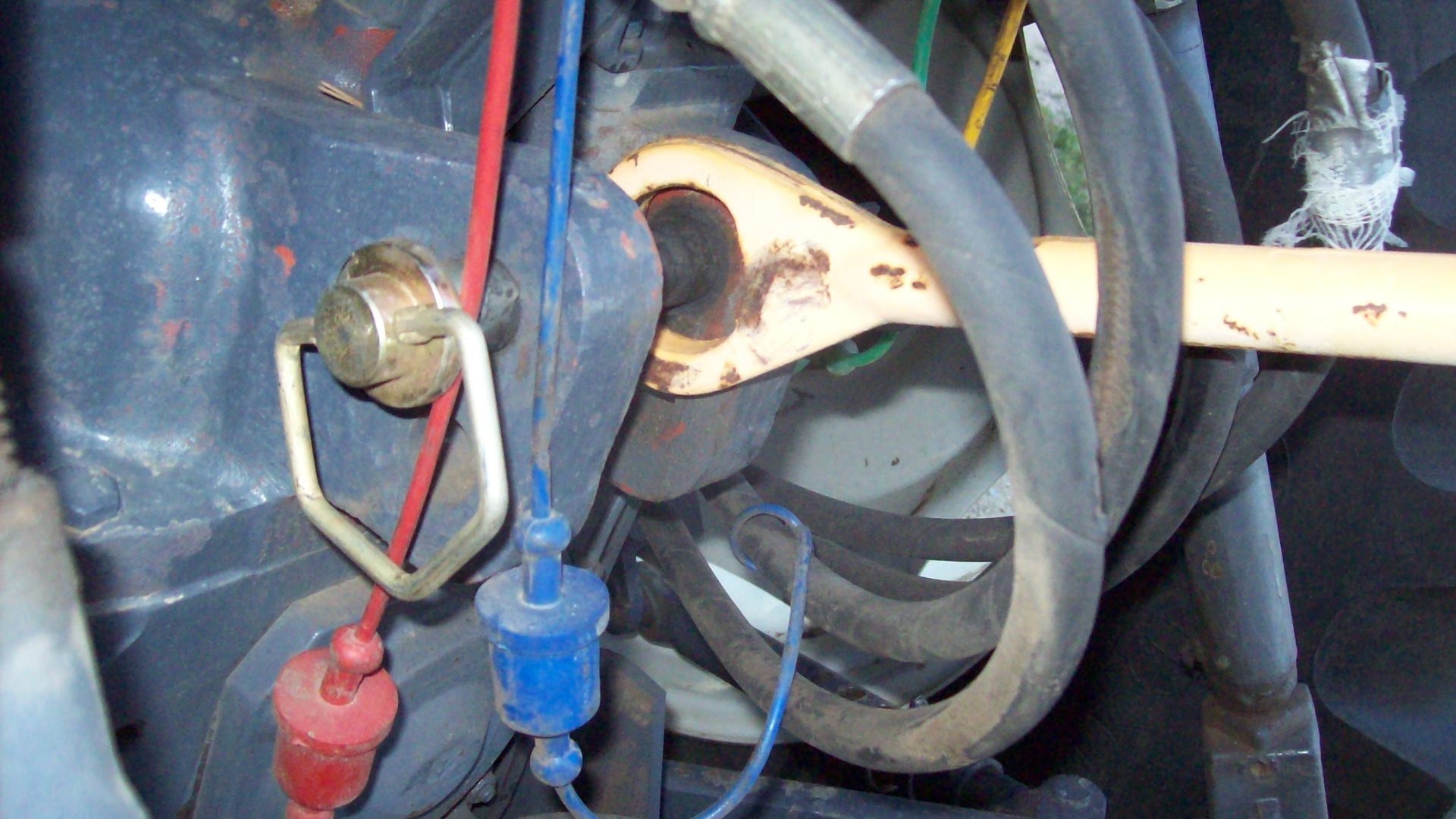

Finally - pics!

thanks for the pictures;
1. you need a new top link for the tractor unless you have one for the tractor already for the adjustable top link.
2. you need a new belt for the mower.

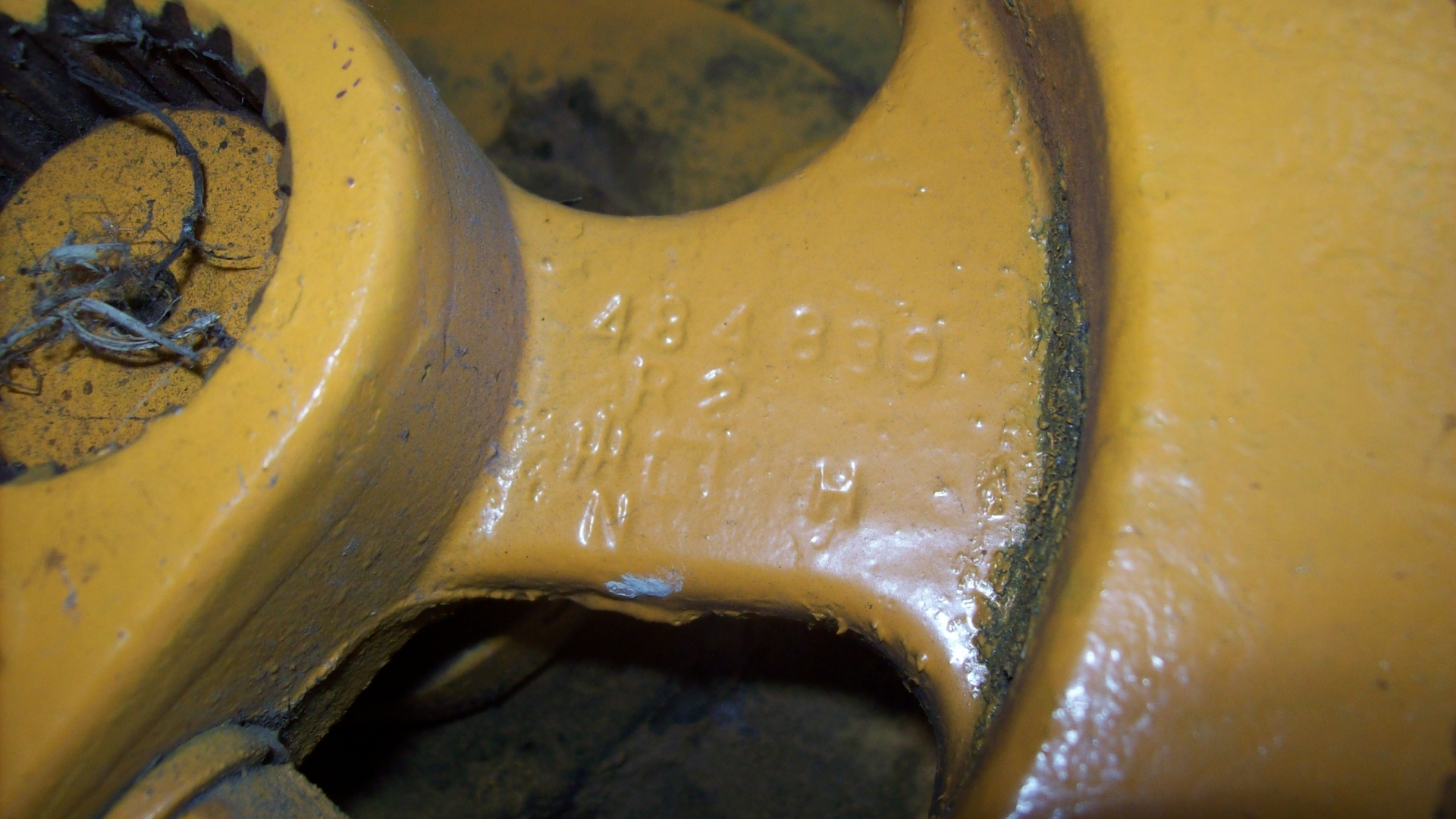

About the belt pullies-
1. you need to remove them completely.
2. clean the male and female splines to the point they have no grease or dirt or dust-no emery cloth but a wire brush, tooth picks if needed, and DL hand cleaner and then some alcohol to finish cleaning with blue mechanics paper towels.
3 . replace the each of spline tensioning bolts with grade 8 fine threaded allen bolts, two allen head split lock washers for each allen bolt(hex head capscrews)and two nylock nuts for the allen bolts.
a. make sure the pulleys are in line with steel straight edge if you have one as all is lost if they are not!!!!
b. the the fine thread allen bolts and nylock nuts keep it from loosening, bashed knuckles etc. and you will not need the blue loc-tite. it will be easy to properly torque the nylock nuts to a low dry bolt torque value and they should not back off the splines at all.
It looks like you need a new skid or two and it should be easy to obtain form Alamo or have them made locally.
The grass knives look fine other than being a bit rusty and use a bit of fluid film on the knife hangers to loosen them up before mowing.
the grass slicer knives are still available from several suppliers so thats not an issue.
let me know if you would like to change the mounting to a spring tensioned
knife hanger and I can tell you where to obtain them if you like.

Thanks for the help Leonz. Fine thread is a good idea.
The blades and hangers all hang free, but what do you mean by a spring tensioned knife hanger?
The skids have had the shoes rebuilt (relined -- maybe 'resoled' is a better term).
It looks to me like the top link is set up for a much larger pin on the tractor side. I like the implement end having the slot in it. Probably easier to do something that is hinged like some brush hog style units have (more movement allowed to follow the ground).
Still would like to know what model it is (not that there is much special about it, bits and pieces wise).

I looked at the Flailmaster web page and the hammer hangers look like the Jacobsen hanger. Don't have any other ideas, but figure IH likely didn't make everything they sold, even then.

Tonight, while trying to put on a "C57" 61" belt (which will not fit), I found markings on the pulley wheels indicating IH.
The upper wheel had IH 404838 R2 and the lower had 484038 (with a IH logo next to it). The gear box had a number WA67-01B. I'm a new member here and if I can figure out how to do it, I will post some photos.
