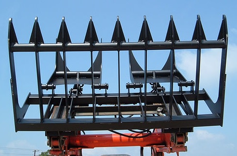

I have a OBG-2 grapple from W.R. Long. When I bought it from the dealer no one asked if I wanted any extra tines added to the bottom, which I later found out is an option from the company. The normal spacing is 8" apart which works great for picking large rocks, but allows plenty to fall through for my tiller to eat. I didn't know if anyone made a conversion kit or had any ideas how best to go about it. It would be nice if I could take it on/off for picking rocks and leave it off when doing normal grapple work to reduce the weight. It wouldn't need to be perfect, just good enough for the amount of times it is needed. I don't need a full-time rock bucket sitting around. Here are some photos from their site. It probably needs sides and spacing down to at least 3" from what I've seen on other buckets.

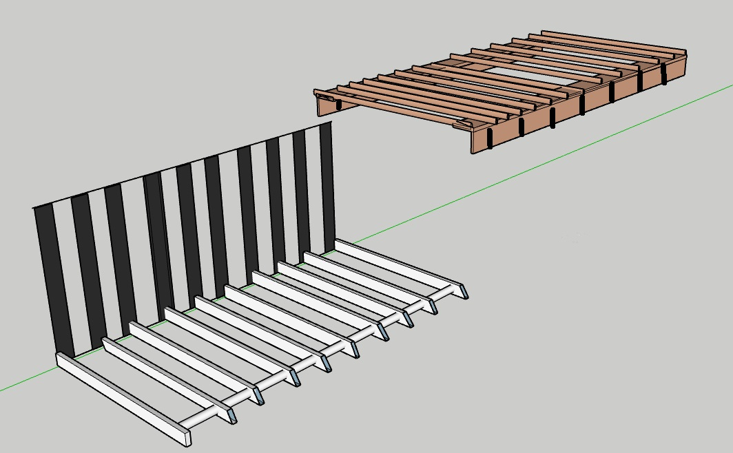

I was thinking something like this. Just was thinking some angle notched to fit down on the existing tines, add some ends to help collect the rock and keep it on with a few welded nuts and bolts to tighten the add-on portion to the frame front/rear. Would rebar hold up to this as my extra tines?? Maybe use the angle upside down to add some strength. I am not great at what material size is needed for what yet. I am just learning.

Looks like I better plan on making something. Would a piece of expanded metal hold up vs. rebar. I may have this in the wrong forum.
