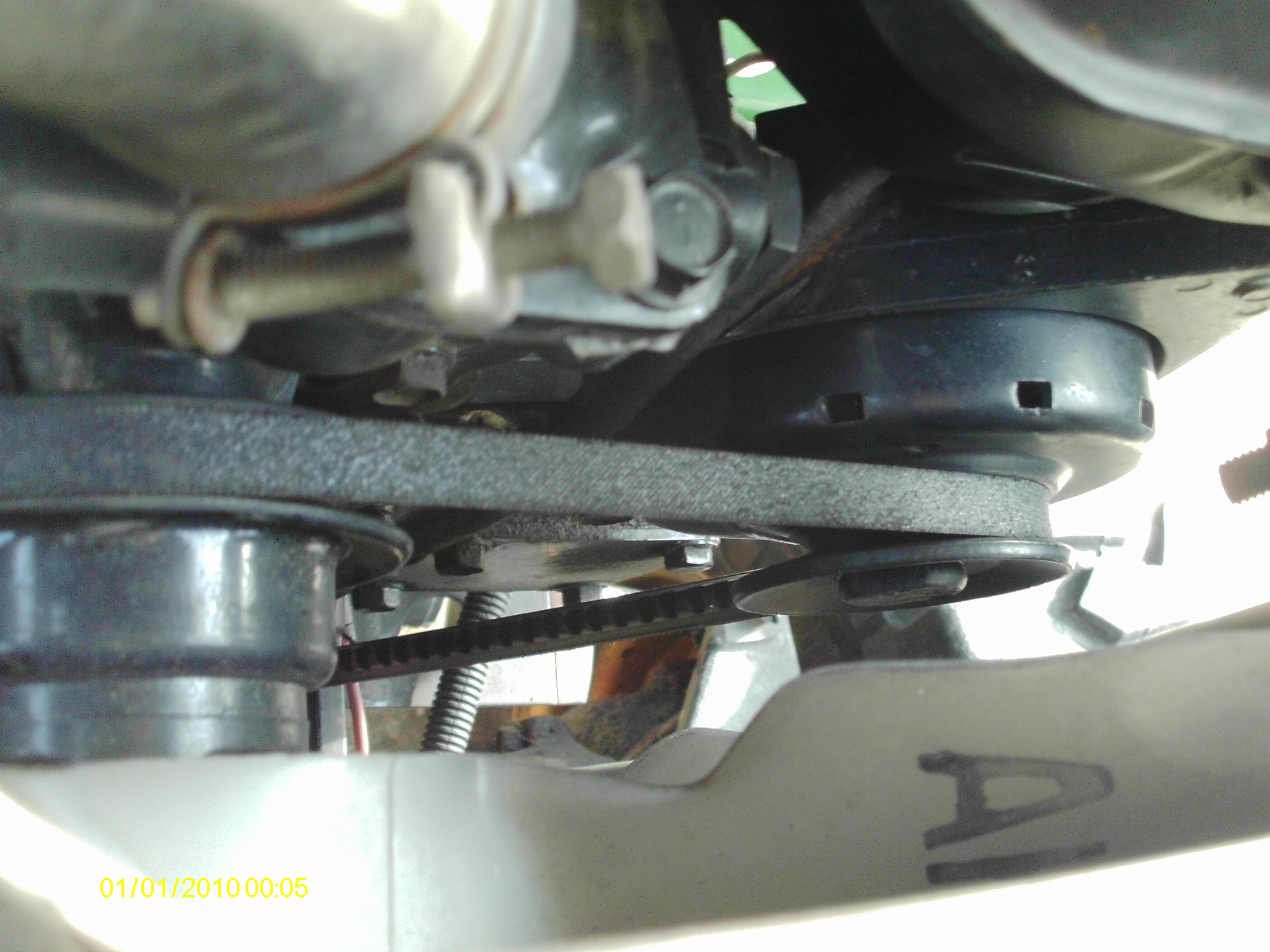

Is alternator drive belt tight?
   / VR...working or not?
What would I be looking for on the alternator? I read ac volt within spec. I ohm checked across alternator pins and pin to ground like I would on my harley even though deere has no such test seem to match those specs. I also tightend the belt obviously its old thats original part too.
   / VR...working or not? #9
Is back of alt belt above,even or below sheave on alternator?
TX Jim its a notched belt belt just looked and it rides deep in the larger alternator pully but sits slightly above water pump and engine pully
