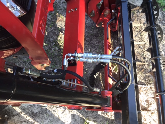

Different tractor and different loader but here are some pictures of mine. Maybe it will give you some ideas.
Please do take pictures and share your experiences.

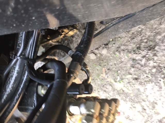

In short, the power beyond is disconnected from the loader valve. That hose is extended to the third function valve to a marked port. A 3 foot (a little too long but better too long than too short) hose then connects from a second port on the 3rd function valve back to where the original power beyond hose went into the loader valve. That port on the loader valve has a 90 degree fitting on it. I turned the fitting to face outwards instead of inwards. I had to do that as the power beyond extension hose would only route one way which put it in the way of that fitting. A slightly longer extension hose would help with that.

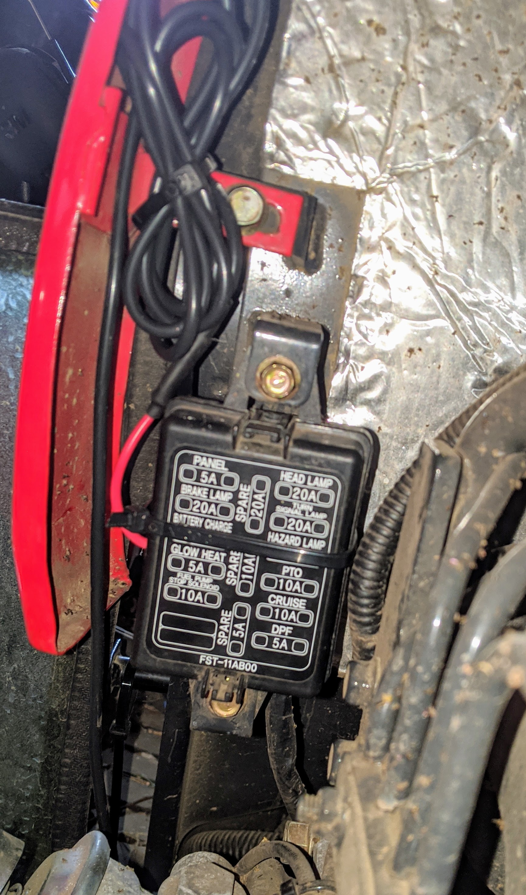

The replacement knob they supply seems solid enough but is hard plastic instead of the nice, softer "rubber" feel of the original. It fit with no issue. It has a three-position switch in the knob. The kit has two electric wires pre-installed in the valve body. One is a three-wire that goes to the control knob. I ran it under the tractor and up through the housing for the control stick, through the rubber boot and up to the knob. Wrapped the exposed control stick with electrical tape and I'll see how that looks and lasts. The second wire is a hot wire for power. The valve kit mounts on the right side of the loader mount and the Branson fuse box is adjacent to it just inside the engine hood so that seemed the best place to get power. I used a fuse tap I got at Tractor Supply and used the turn signal fuse. Littelfuse Holder Mini Add-A-Circuit 16AWG Card at Tractor Supply Co.
WR Long supplied a 10 amp inline fuse holder but it was cleaner to use the add a circuit. I did have to wire tie the fuse block cover as the added bulk of the add a circuit kept the cover from securely latching.

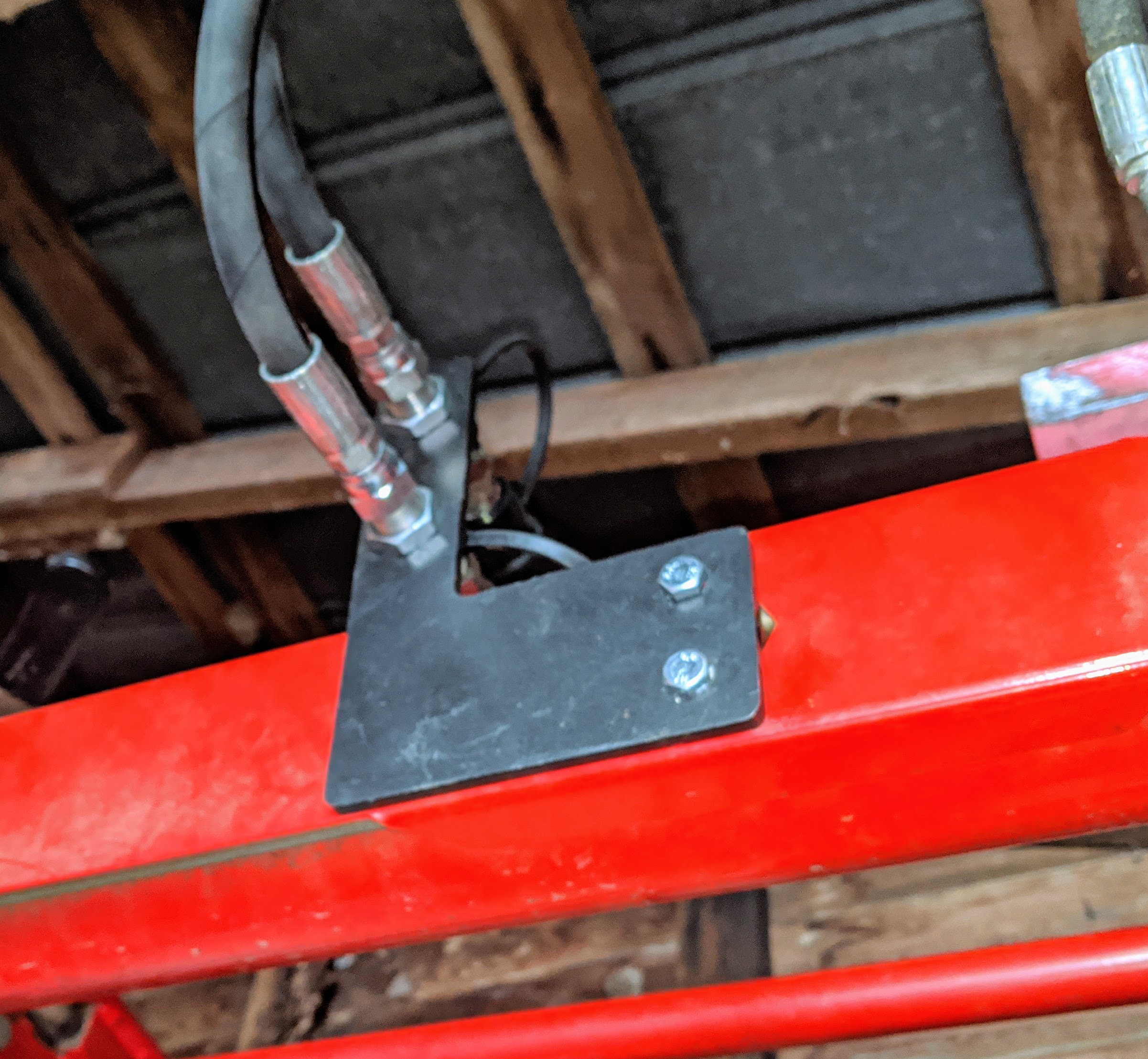

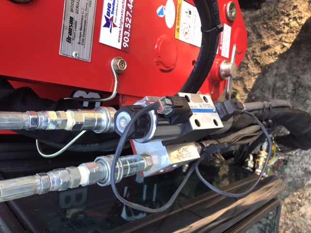

The valve unit comes with a mounting plate and bolts to the loader mount by removing the bolt holding the wire loop hose retainer. The original bolt can be re-used as it is just long enough for both the mounting block and the wire hose holder. One note is that the valve block mounts at an angle pointed towards the rear so as to clear a bump-out on the loader mount.
The hoses leading to the front of the loader were generously long and the male/female ag couplers come mounted in a bracket. This bracket is pre-drilled accurately to use the two bolts holding the protective cover over the solid hoses on the loader torsion bar. But, again, nitpicking, the existing bolts weren't long enough with the added thickness of the mounting block so another trip to the hardware store was needed.
