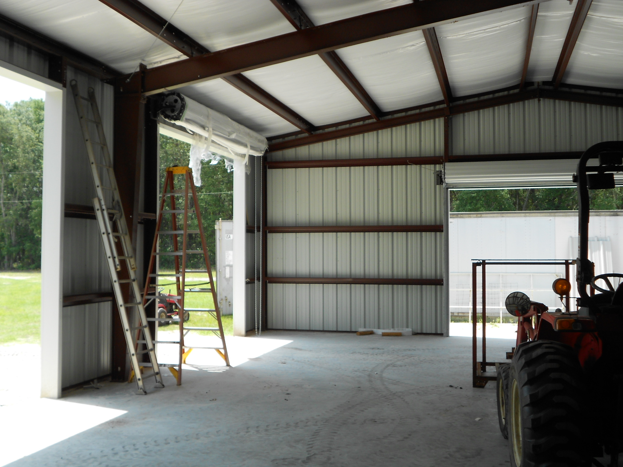

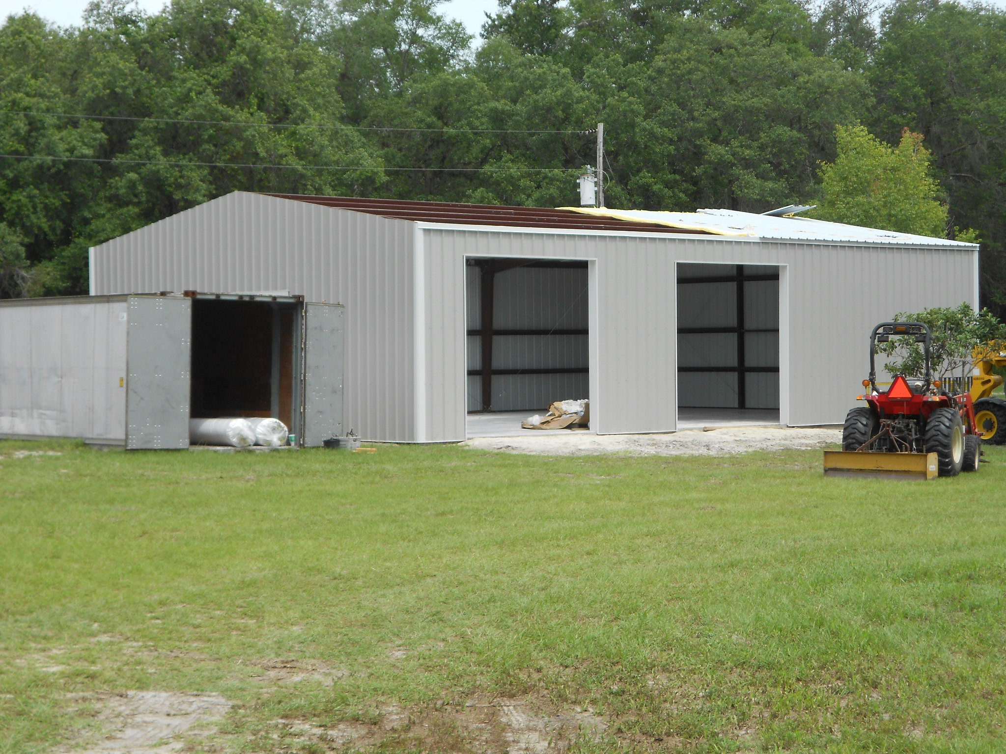

I had a 40' X 60' red iron put up a year ago and had the insulation put on the ceiling only.
That type of insulation seems to be standard.

Do everything if you got the money. If budget is to small then do the roof first. Then walls that you can. South perhaps for summer heat or north for winter cold depending on your needs. Walls can be done at a later date much easier than the ceiling. The vinyl backed type of insulation is fine, way better than some. At least it creates somewhat of a moisture barrier for condensations problems. Blown in paper insulation can actually rust the metal in some areas due to humidity. Not to mention spark / fire issues. Expanding foam works great but cost more and for some reason its not on your preferred list :)
