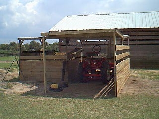

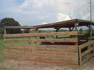

Do your tractor a favor and put up a shade structure for it. I just picked up a 1966 international cub, and threw up a 8x10 structure for it.. went up in 4 hours by myself.. and that included the trip to the store.. doesn't have to be fancy.. just 4 2x4's to go into the ground for corners, and then 2x4's for 4 sides, and then 1 or 2 2x4's as runners down the middle.. attatch some 5V roofing tin, and there you go. If ya want a wall or two, use the 16'x6"x1" fence boards and cut them down to size.. that's what i did...
The whole deal worked great... I added on to an existing shelter I used to cover round hay bales. Now it covers my extra tractor and the hay.. here is a pic. It is easier than you think.. and will add years to your tractors life.

2nd pic
