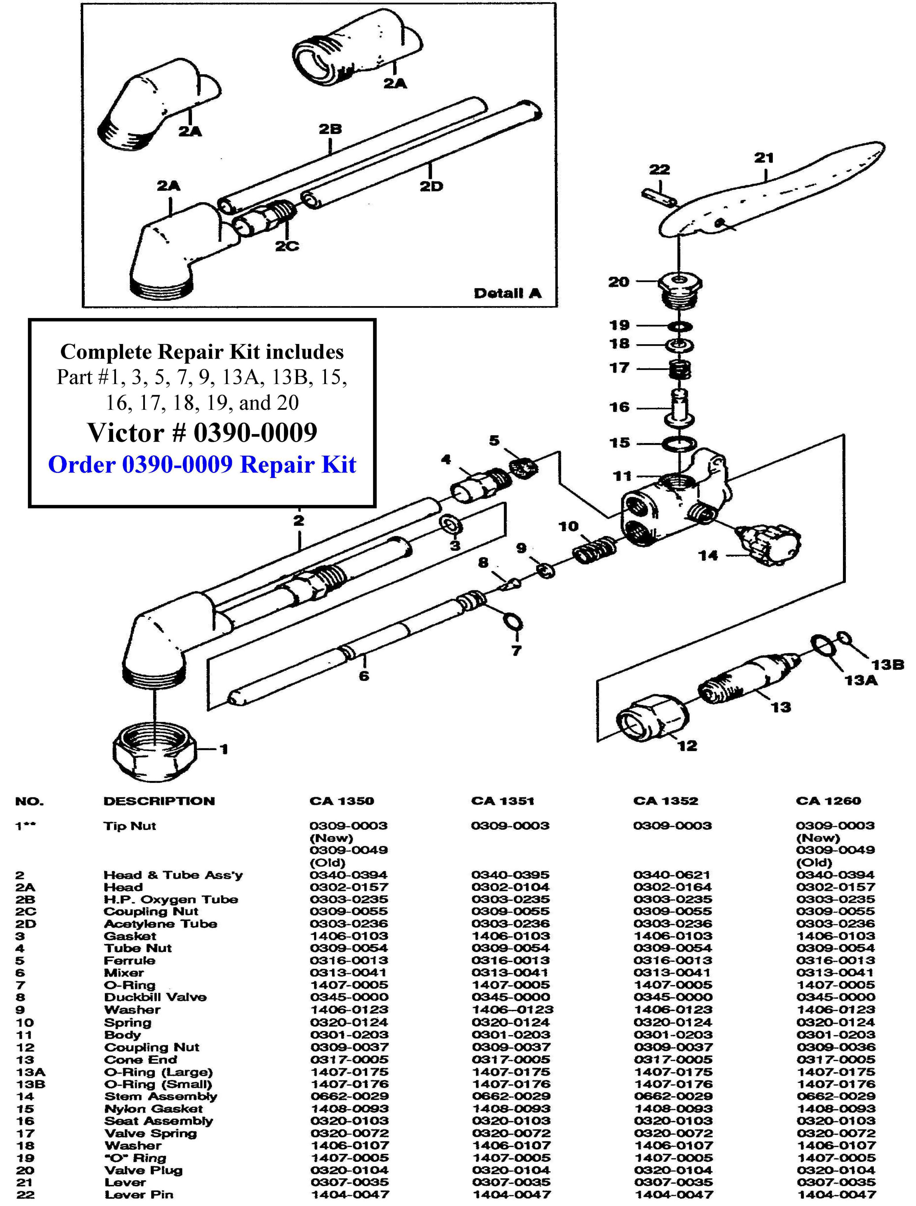

I bought a kit for my cutting torch and was wondering if I should be able to get a wire thru the mixer tube from end to end. It has the orifices in the middle also. It's part 6 on the drawing

Call 800 426-1888, option 2 then wait for Victor Tech option. Best to ask them although I believe you should be able to.

I put the kit in the cutting torch and it's working again. I just turned my brain off and put the various gaskets and orings in and whatever was wrong it's ok now.
