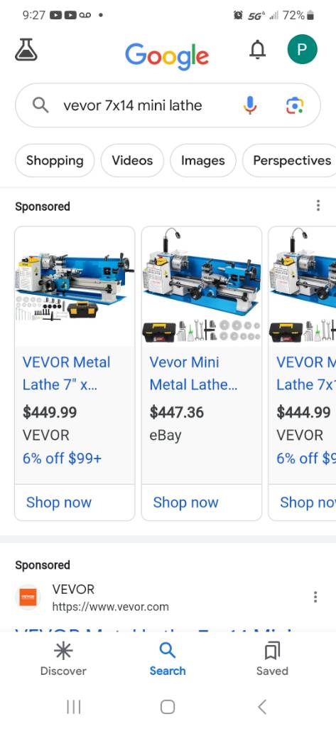

So, I should mention, currently the same machine is more than $280. Looks like $450 or so. Also, I sold a Craftsman micro (109.xxx) lathe, like 6x12, maybe smaller, that was basically just a bed and head/jaws, from the 1950s, no motor, no tool post, maybe a partially complete tail stock, for around $200 (paid $80 for it), to help fund the toy budget.
