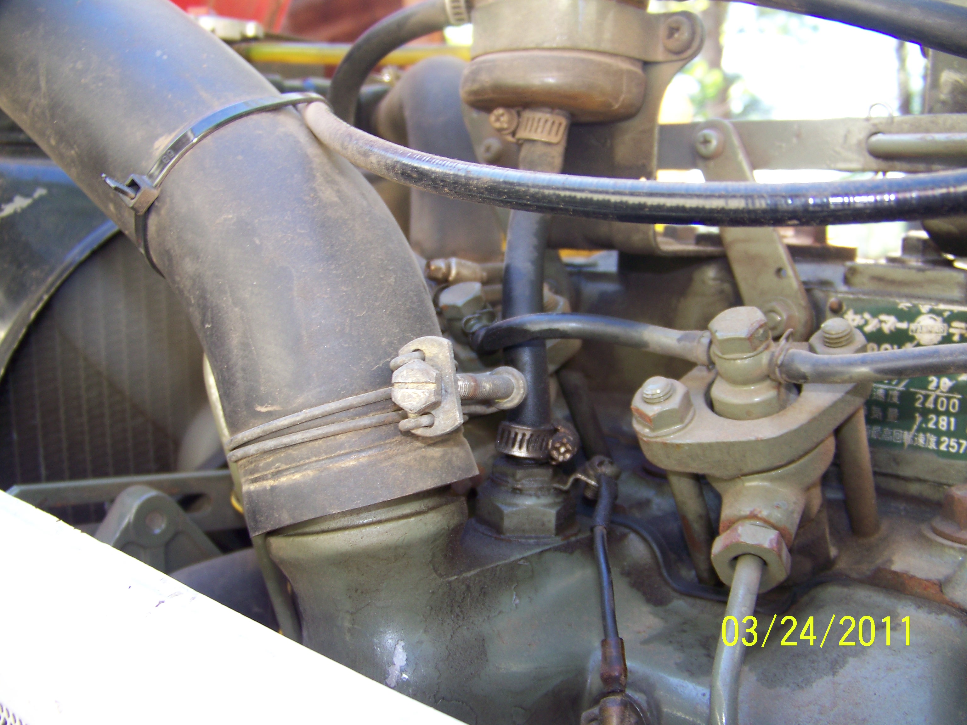

This Yanmar Tractor Thermostart Plug will help explain it. The best way to know if it is working is to hold your key in the thermostart position for 10 or 15 seconds, then feel the intake where the thermostart element screws in. It should be warm to the touch. If not, it is not working. You have a little bottle similiar to the one I am attaching. Make sure it has diesel in it. Some are self filling from injector bleed off and some have to be hand filled. I don't know which one your 155 has. You can see the bottle at the top of the picture and the thermostart element where the hose is connecting the two.

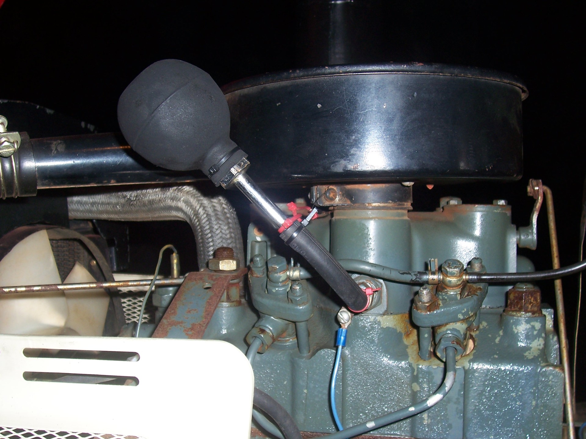

If the Thermal plug is there. My Plug was but it didn't have power to it. I just ran power to it Pos. from the battery at first and it Worked:thumbsup: Then I wired it to my Ign. But my Bowl wasn't there so this is what I did for it. I Rarely have to use my TS. here in Ga. so I made a Quick Fill and Connect. This was just an old Antifreeze Tester I had that I took the Ball off of that works Great. Just give it a squeeze stick it in the tank to fill it and plug it in. Put it this way since the last post I ran out filled it and hooked it up. It's still 55Deg. here so no need for it yet.
Ah! getting better at this PC. stuff my pic.worked :D

Winston, thank you for the pic. I was never sure where the heck it was:confused:. Now to see if it works.
