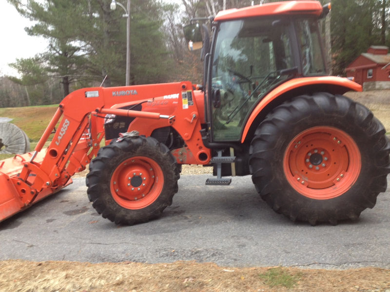

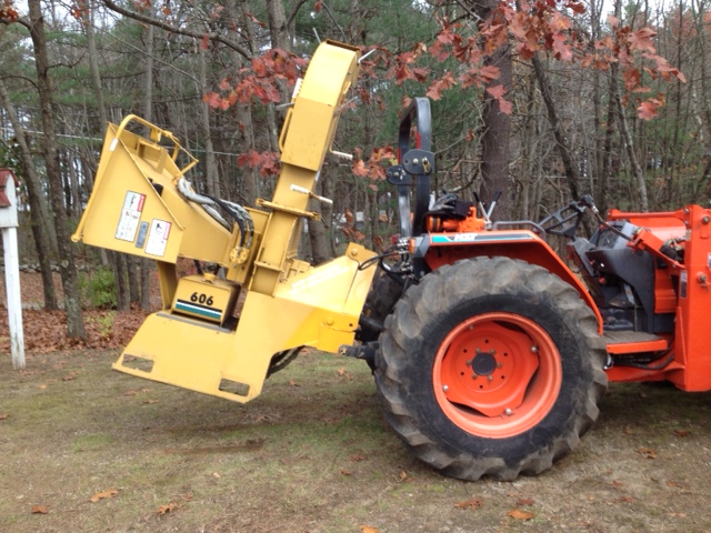

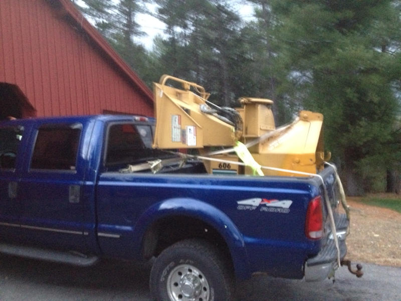

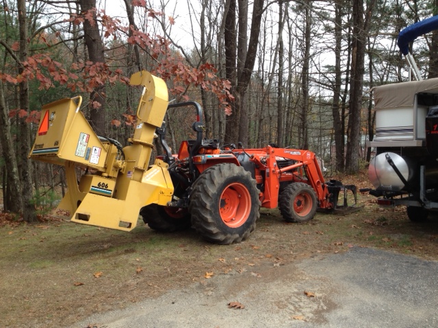

Here are a few pics of the chipper.
My dad picked it up for me as I had to go back to work and didn't have time. Now I wish I picked it up as the owner told him to load it himself since he wouldn't be around. He loaded it with the guys crabbed M9540! My dad was in heaven running that tractor and I know I would have been too!

The specs for the 606 say it is a 6" capacity chipper and lists the weight at 1350lbs! This I a pretty beefy unit! I'm a little concerned that it is too much for my tractor but I think it will be fine. I handle my 6' 1200lb rotary cutter just fine and this isn't much heavier.
My 39PTO HP is right inline with the range they recommend.
The chipper has an adjustable hydraulic feed. It is self contained to the unit and doesn't have any hoses going to the tractor. Is this typically how the hydro feed chippers are setup? I thought they usually plugged in to the tractors hydraulics but like I said, I don't know much about these!

Little late to ask questions now.... its in your garage. Vermeer is a premium name in the chipper business. I would not worry about their quality. Generally chippers do not get anot of usage and look in the condition of this one. What was the asking price on CL ? I have a 8" Bear Cat PTO gravity feed. I don't see a huge task in lowering the intake and adding two hydraulic motors, flow control and direction control to make it automatic. What HP are you using to power it ? I have a 55hp New Holland and the chipper could use more for larger material. Knives must remain sharp for proper operation. Next will be a stump grinder. better start looking now !
Reading your post more closely 39hp may work for small diameter limbs but it really takes power for the larger diameter wood. There has to be a hydraulic line to the tractor to power the feed. Look closer... maybe the line is capped off. There is no other power source and it doesn't work by itself.
There is a filter on the side of the chipper, so I'll bet that there is a pump that runs off of the PTO shaft...
Aaron Z
That's what it looks like to me too...the pump and hydraulics are integral to the machine. I suspect this chipper requires no hydraulic hook up to the tractor.
Looks like a great chipper and very robust!

As for the hydraulics, I believe Roy and ACZlan are correct, the hydraulic feed is self contained and run off the PTO shaft. Unfortunately, I am away at work right now and won't be able to use the chipper for another 3 weeks, so I can't answer many questions on it yet. I'll give it a good test when I get home after I go through it. I'll have my wife take some more pics for me and I'll post a few more.

My father unloaded the chipper, read through the manual, went through the chipper, and hooked it up to the tractor. He sent me a couple pics and videos of it in use. He said that I am going to love it! He put a few pieces of brush through it and he said the tractor handled it fine, never hiccuping at all, although he didn't put a 6" log through it either. I'll see if I can attach a video, never done that before. :D
