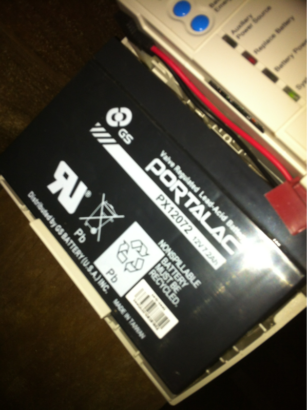

Got the Verizon bundle about 3 years ago. Have since pared it down to just Internet. No tv no phone with them. They installed a battery backup that is mainly for the phone. Now the battery is dead and it is beeping. Remove battery it's still beeping. They say it's my responsibility and want $45 for it. I only want to shut the beeping off and don't want to pay for that. Anyone dealt with this? Just looking for info before I go clipping wires.

Do you have a picture of the battery? Do you have a Battery + store near you? They might have one.

I did a quick search and I think one can be had for $30. It has a silence button but it only last 2 days and it is in the cellar. Too many things going on before christmas. I'll do a better search next week. There is also a batteries unlimited on my way to work. I think you are right about leaving their equipment alone.

If you are just doing internet with them do you really need their battery backup? You should be able to just unplug the UPS and plug the FIOS thing in the wall. One of my accounts received a UPS from ATT UVerse. It is just a UPS, nothing special that makes the UVerse work. It is just to provide power to the adapter so their phone can work with a power outage.

Are there any surplus stores in your area?
I cant tell the dimensions from the pic, but Princess Auto had the same brand (and similar size) batteries as surplus... Cheap. They were time expired from medical equipment.

$12.50 at Amazon
[ame]http://www.amazon.com/GS-Portalac-PX12072-Replacement-Terminals/dp/B004ALBUYU/ref=pd_cp_p_1[/ame]

try a 9 volt battery to supress alarm a 9 volt battery will keep the memory on car radios. The original battery is 12 volt. A 12 volt battery tender from harbor frieght will do it too just wire it to the battery connections $5.00 on sale
   / Verizon fios battery backup #10
Geez that is a simple 12 volt 7ah gel cell. Every emergency exit light in the nation has one in it... the Amazon price is a good one.
