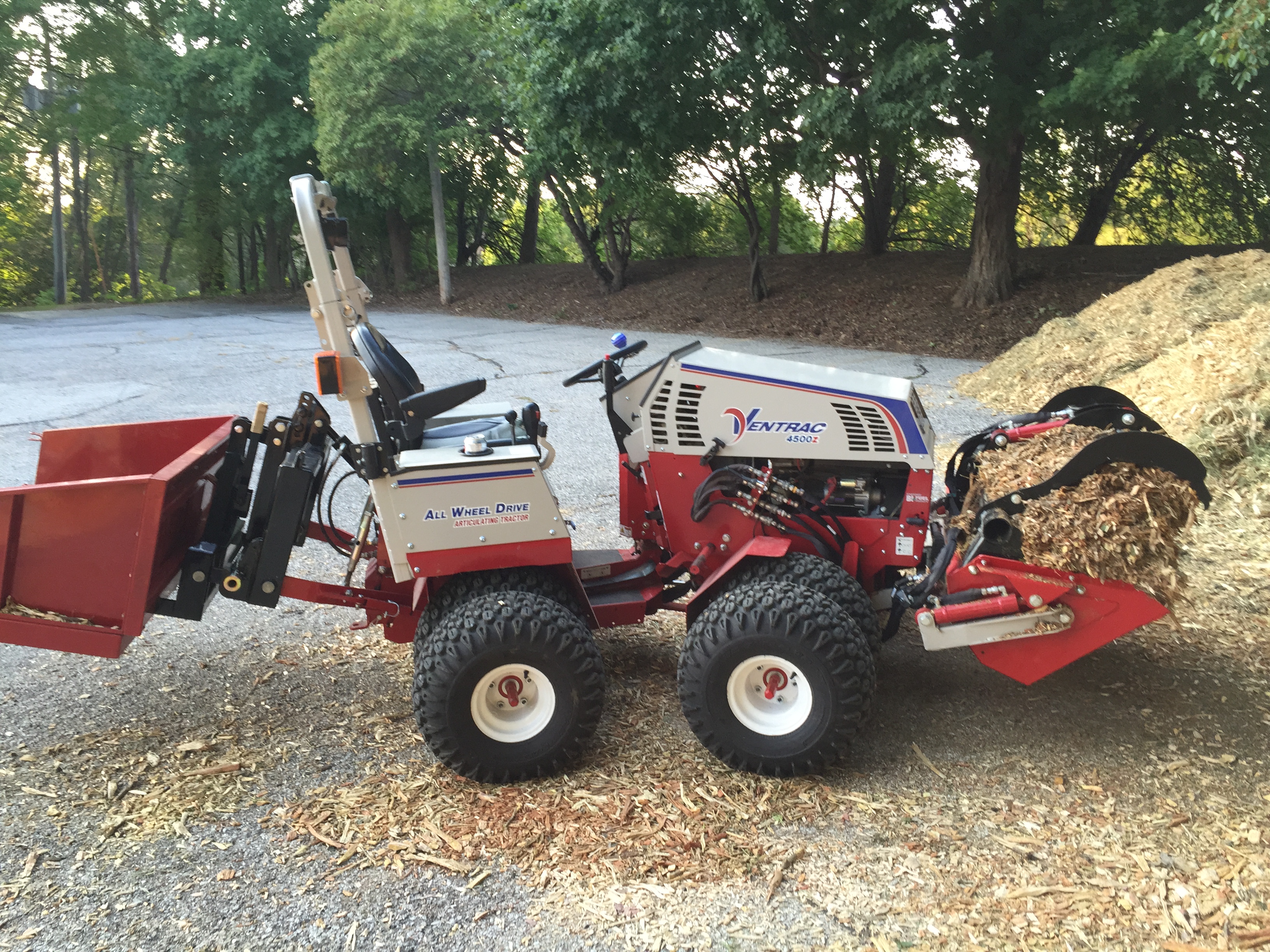

The grapple works as shown on the Ventrac videos, and works well for my applications. It works great for increasing the amount of mulch that can be loaded and carried as shown in the photo. The teeth are intended to loosen soil to aid in filling the bucket. They are not sharp, so I doubt they would do much for root cutting. Maybe the Piranaha bucket teeth would do better for that purpose.
Bxpanded.com
Also, the grapple reqires the installation of a kit to provide a second set of hydraulic couplers for the front.

Sharp has little to do with digging but location and spacing does. No teeth on the outside corners is a killer...... jim
