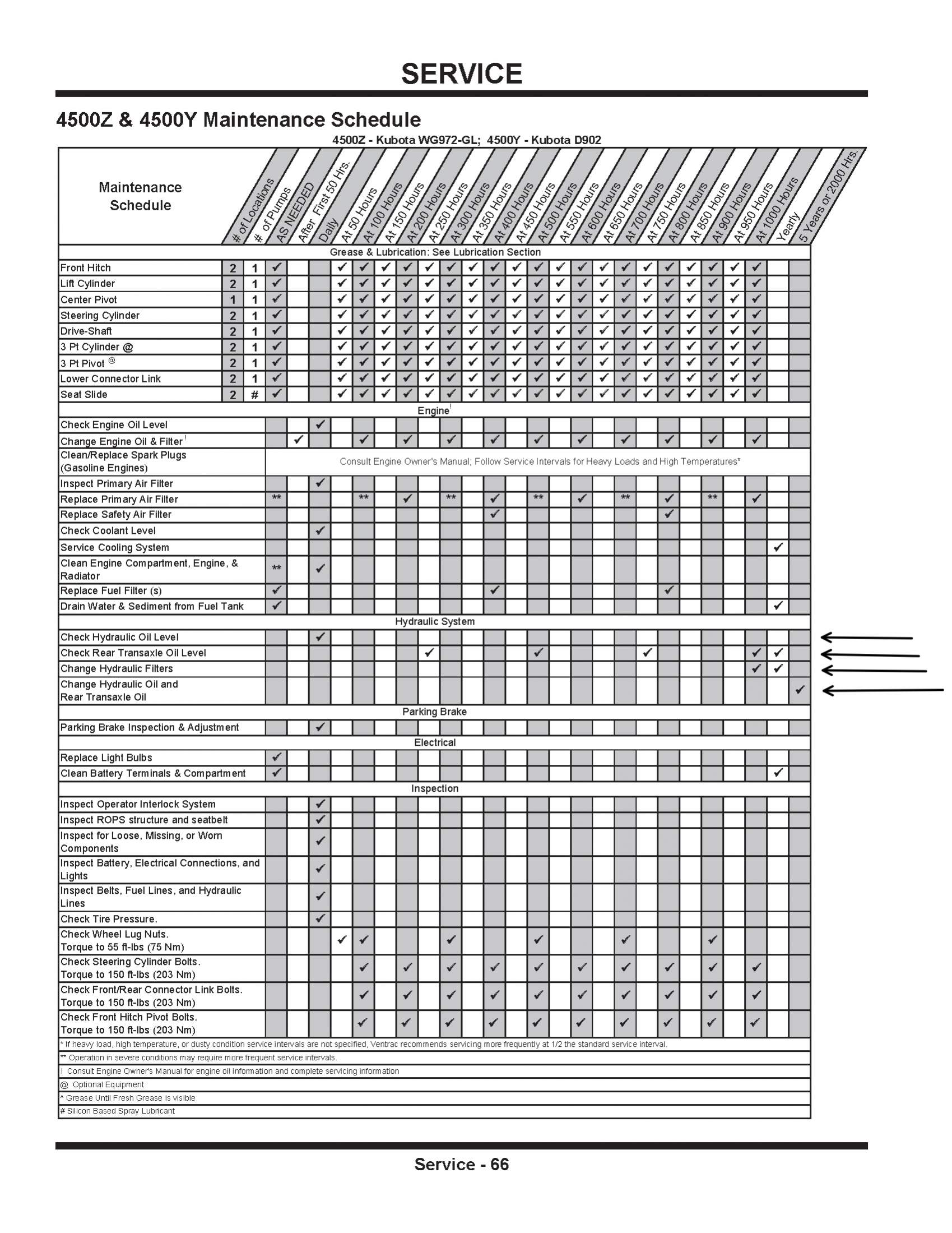

My downloaded version of the Operator's Manual (0910081_KN4500_Operators_R05.pdf, Revised 06/12/14 09.10081 Rev. 05), at Page 66 of 88, states that:
-- one should Check [the] Hydraulic Oil Level daily;
-- one should Check [the] Rear Transaxle Oil Level every 250 hours, and yearly;
-- one should Change [the] Hydraulic Filters every 250 hours, and yearly; and that
-- one should Change [the] Hydraulic Oil and Rear Transaxle Oil every 2,000 hours, or every five years.
My printed manual, supplied with my Model 4500Y, says the same as the above-specified PDF version. I have added arrows to the image of Page 66 for the sake of clarity.
Best,
JJM
   / Ventrac branded oil and fluid
JJM, the downloaded version I have is more recent. 09.10081-REV7 02/18/2015
The odd thing is. for our Kubota motors, the second page of the service requirement is not marked at all. I see no reason as to why that part of the schedule would differ from engine to engine, but..........? For the 4500 models were the second page is completed, the hy-tran fluid interval is shortened. I down loaded from Ventrac site. I will check the paper copy in my canister when I get to it.
