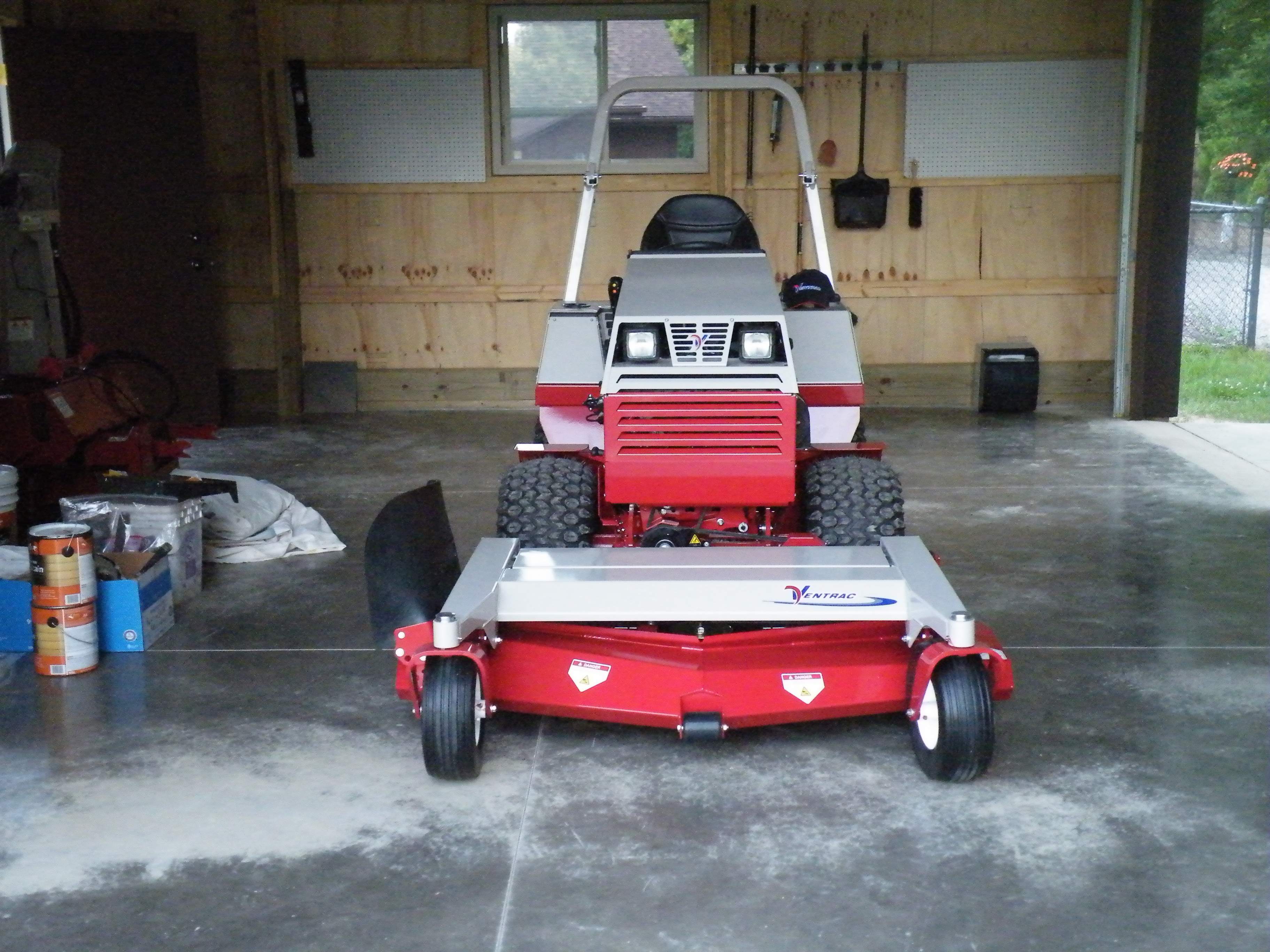

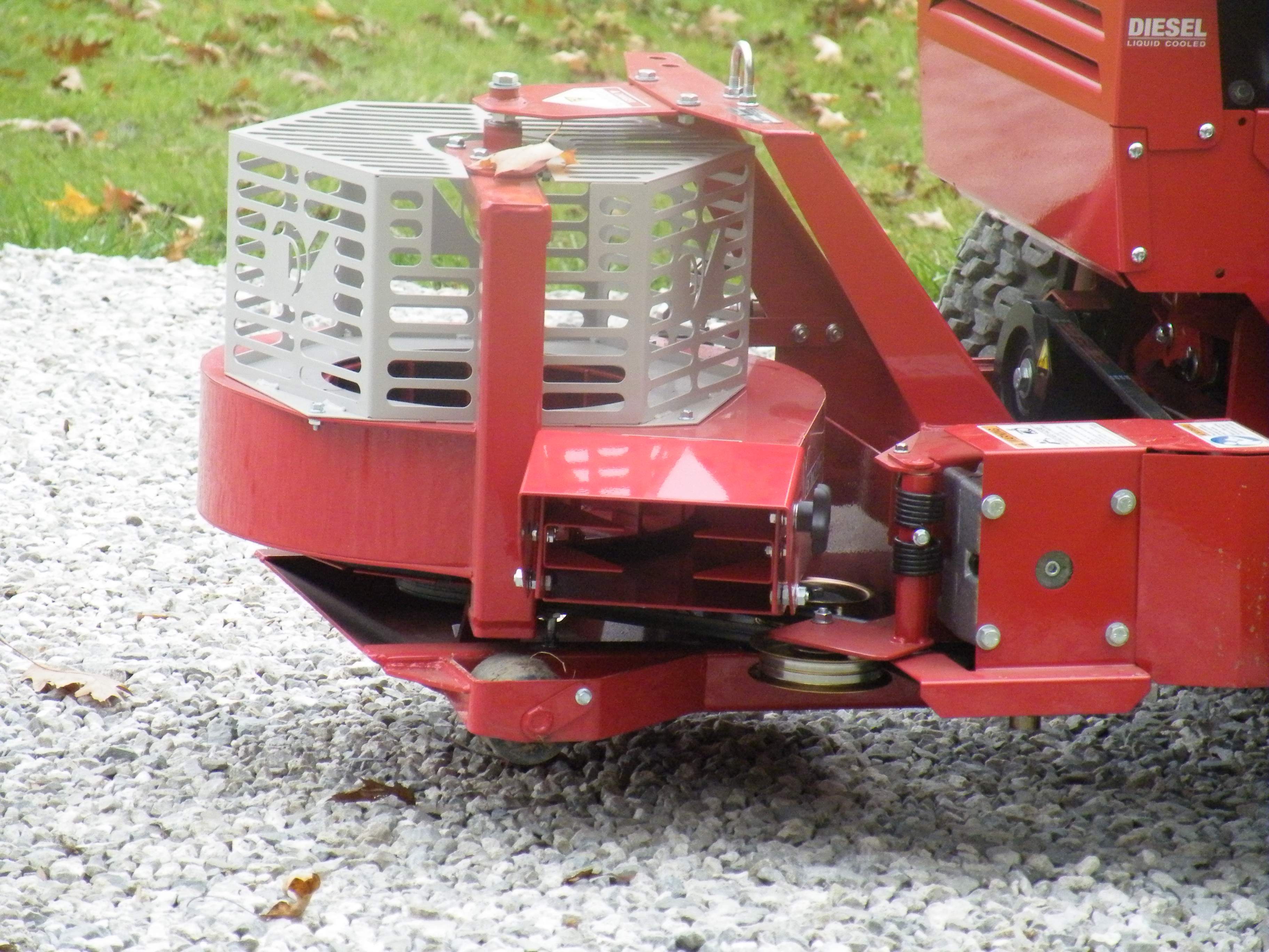

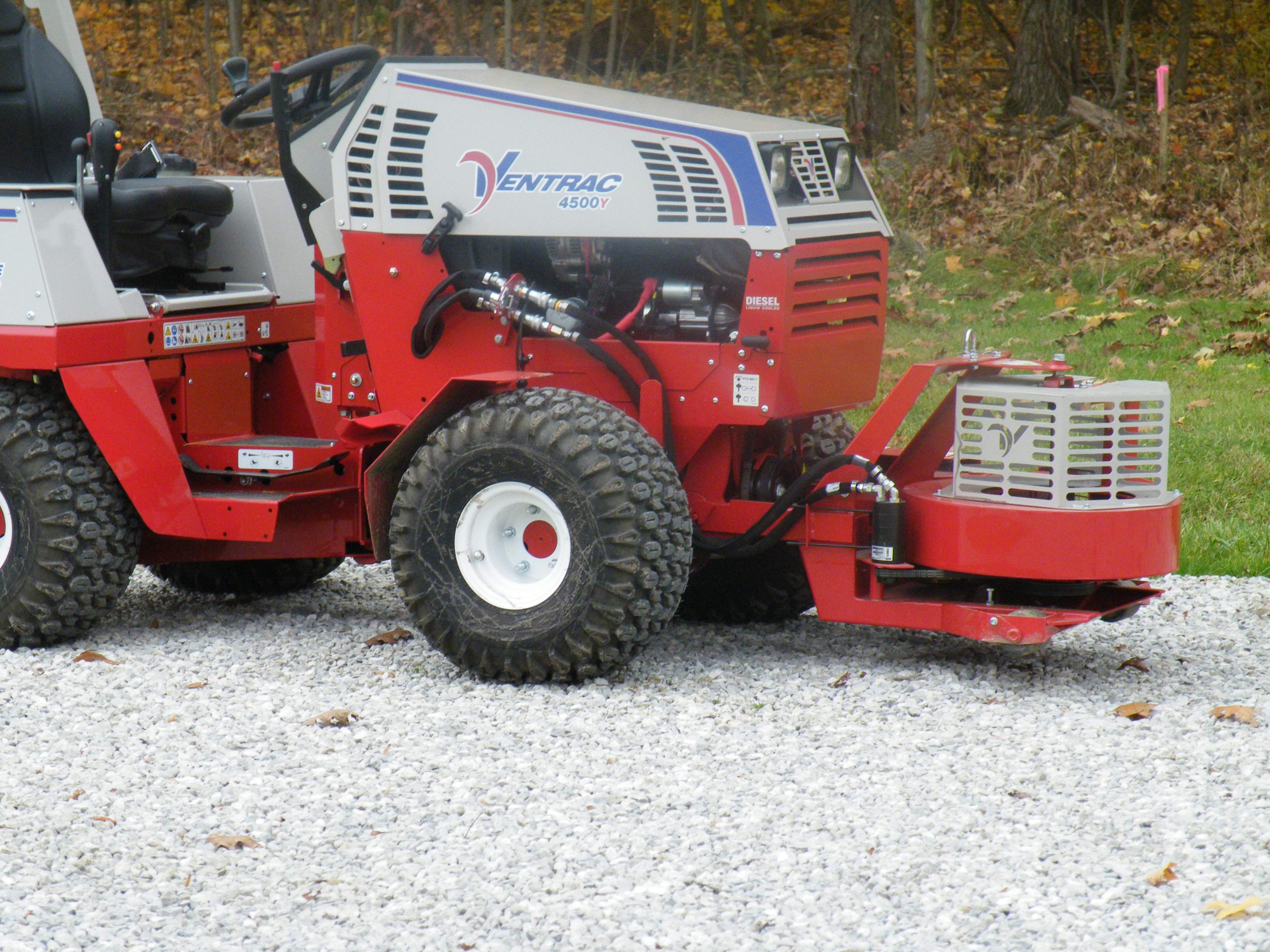

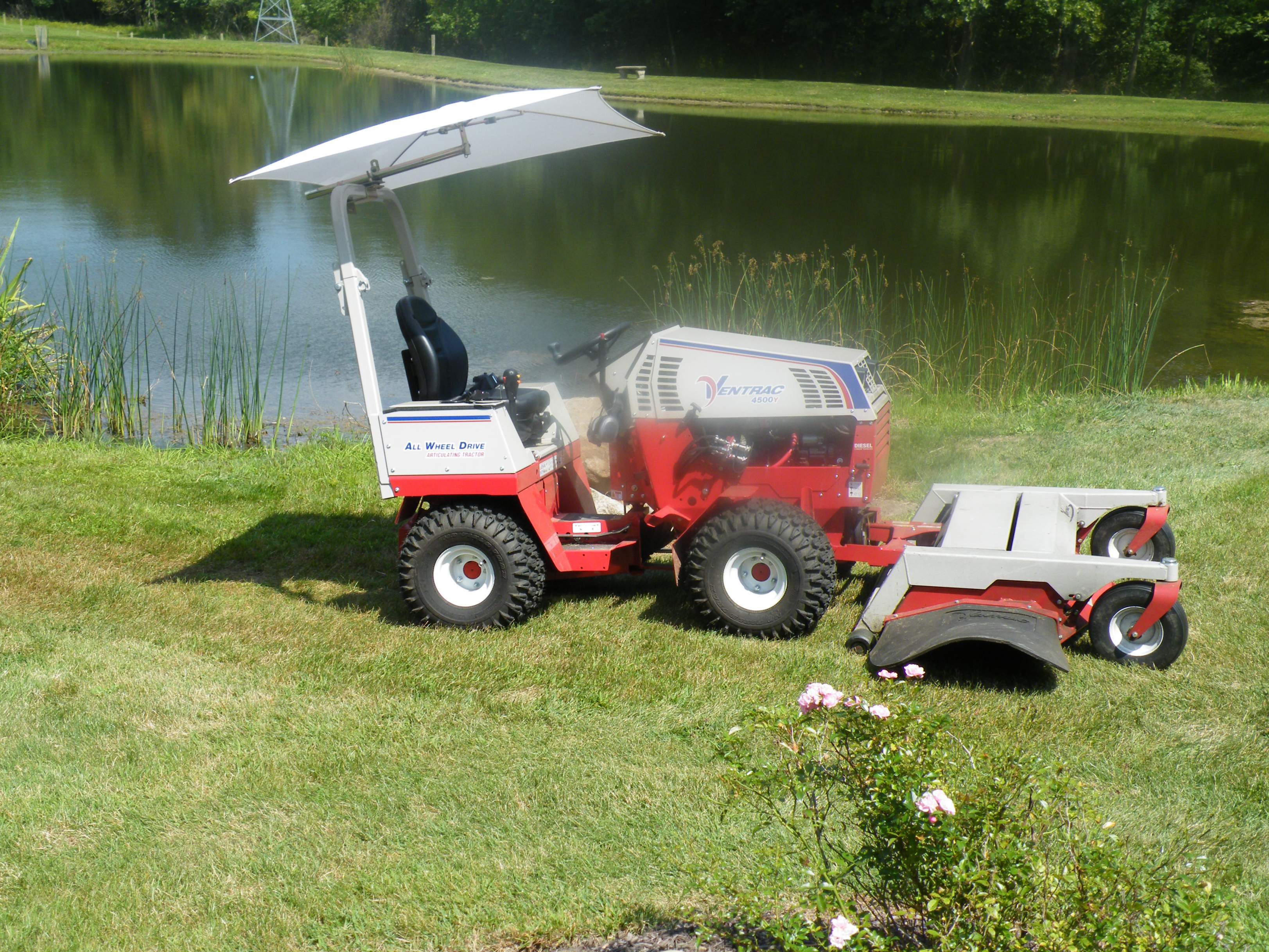

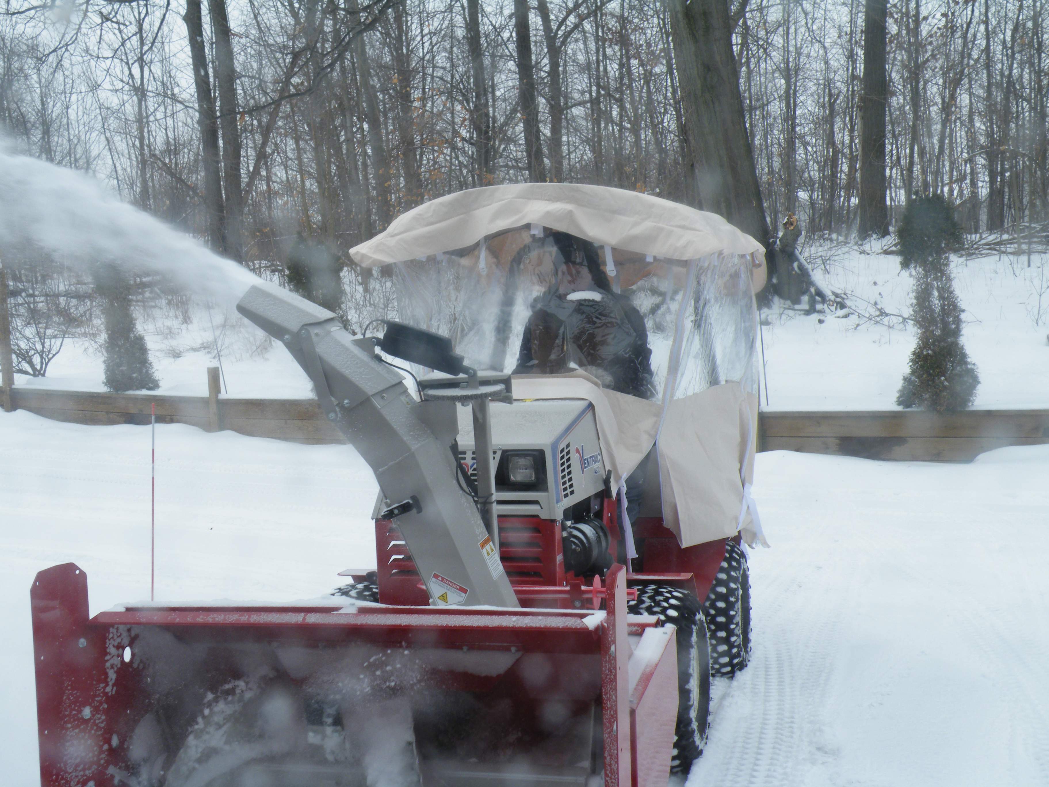

I have the "under powered" Kubota Diesel and I have yet to find it lacking. I use the Snow Blower and shoot snow 30' easy. I cut 5 acres of grass weekly with the 60" side discharge mower. I have no complaints on this machine at all. I was lucky enough to test drive them both as my dealer sold both. Steiner was having control problems at that time. If I was to go gas I would go with the Kawasaki engine.

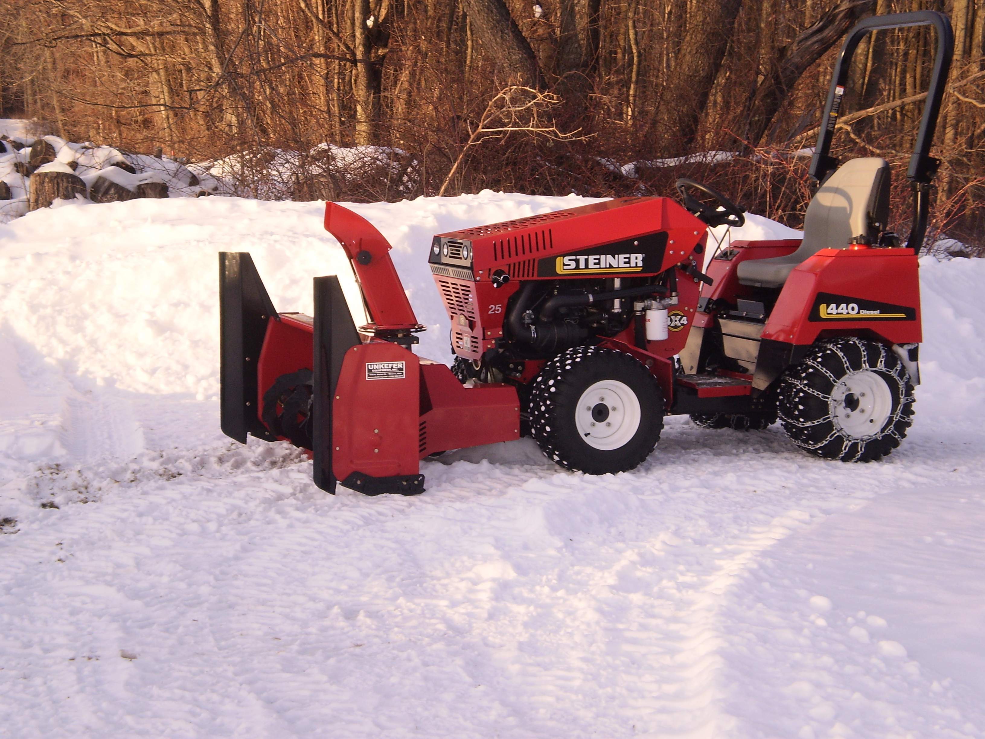

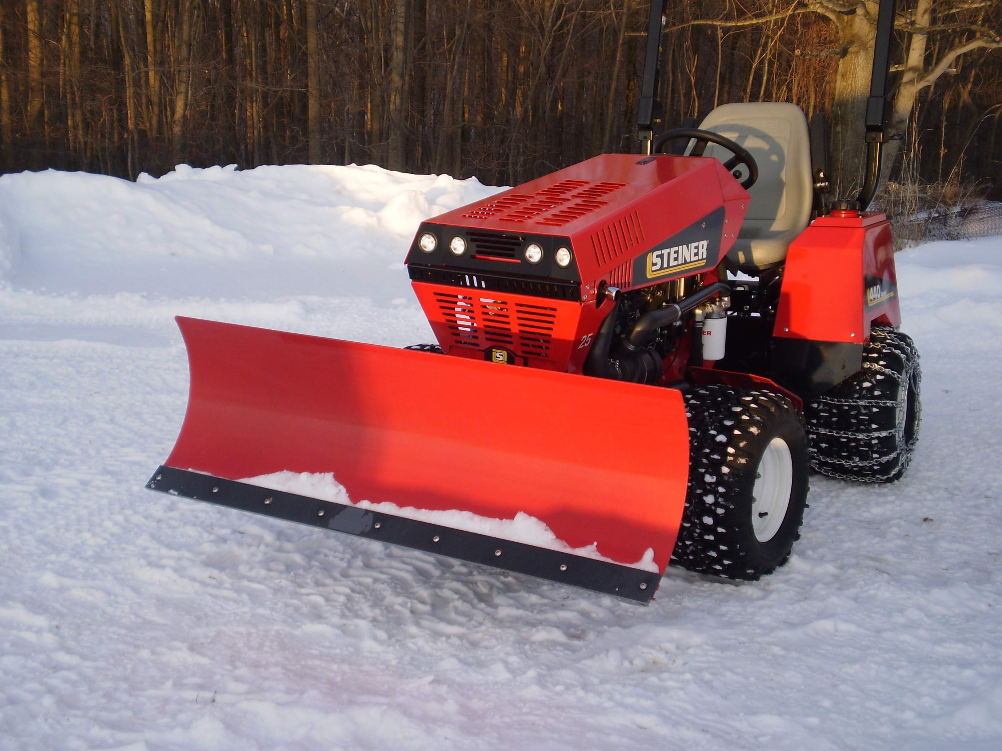

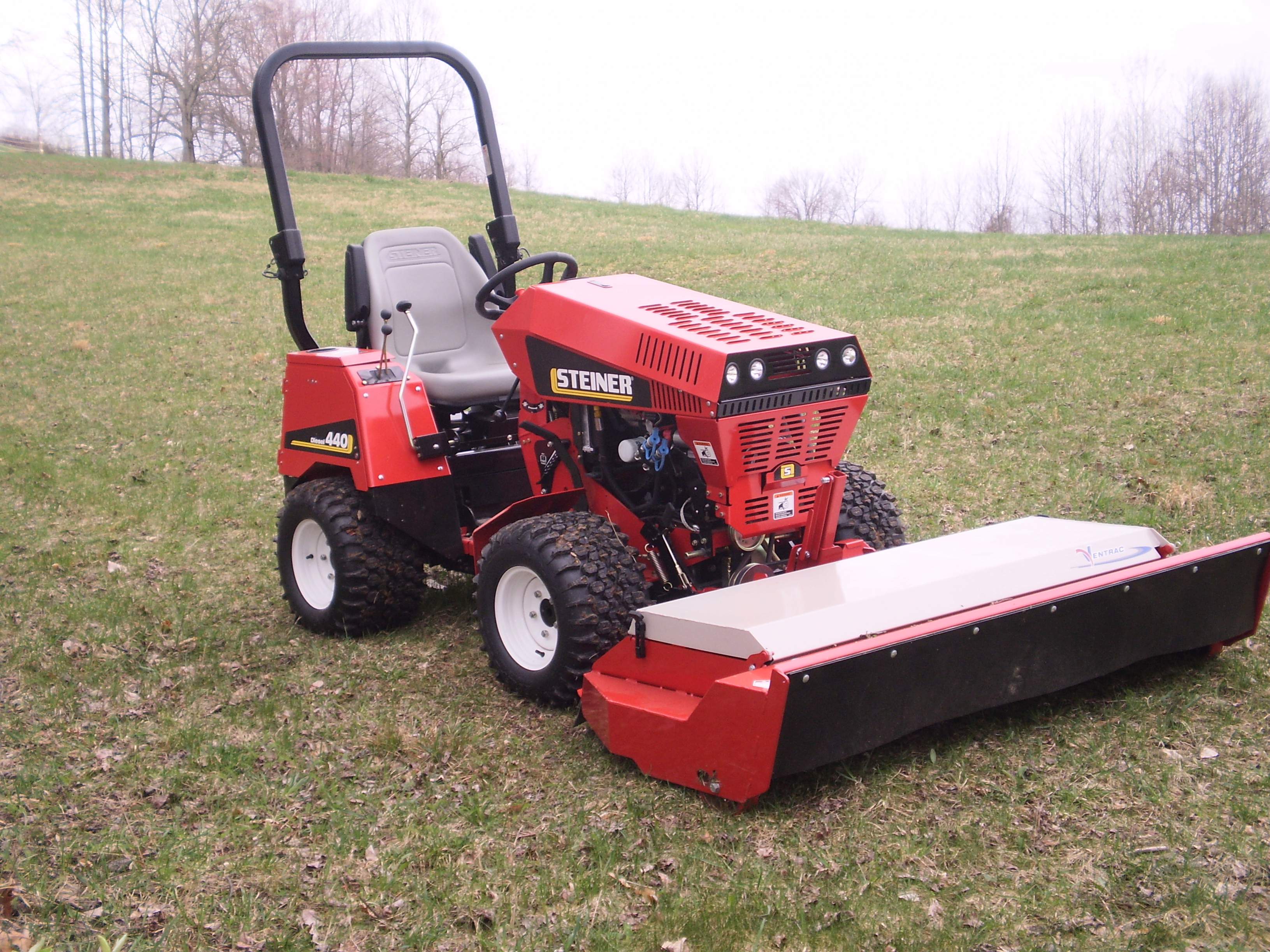

I have the 440 with the deisel. I would say that the power is adequate for it with the 60" finish mower and the Ventrac tough cut mower I use on mine. I also have very hilly terrain. I have the wheel spacers on mine but duals are also available for the Steiner as well. As Raw Dodge stated keep the radiators clean and you will have no problems with them. I bought mine the first year out for the new model and have had several problems. Steiner and my dealer have been excellent about fixing the problems and most of them were repaired with upgrades. I think both the Ventrac and Steiner models have been out long enough that they should have most of the new model bugs worked out ( I hope). JackIL recommended the weight transfer to me and I in turn recommend it also. It makes a big difference with the finish mower on the hills I mean night and day difference. It is an option on the Steiner that can easily be added by yourself later on. I love mine and would buy it again.

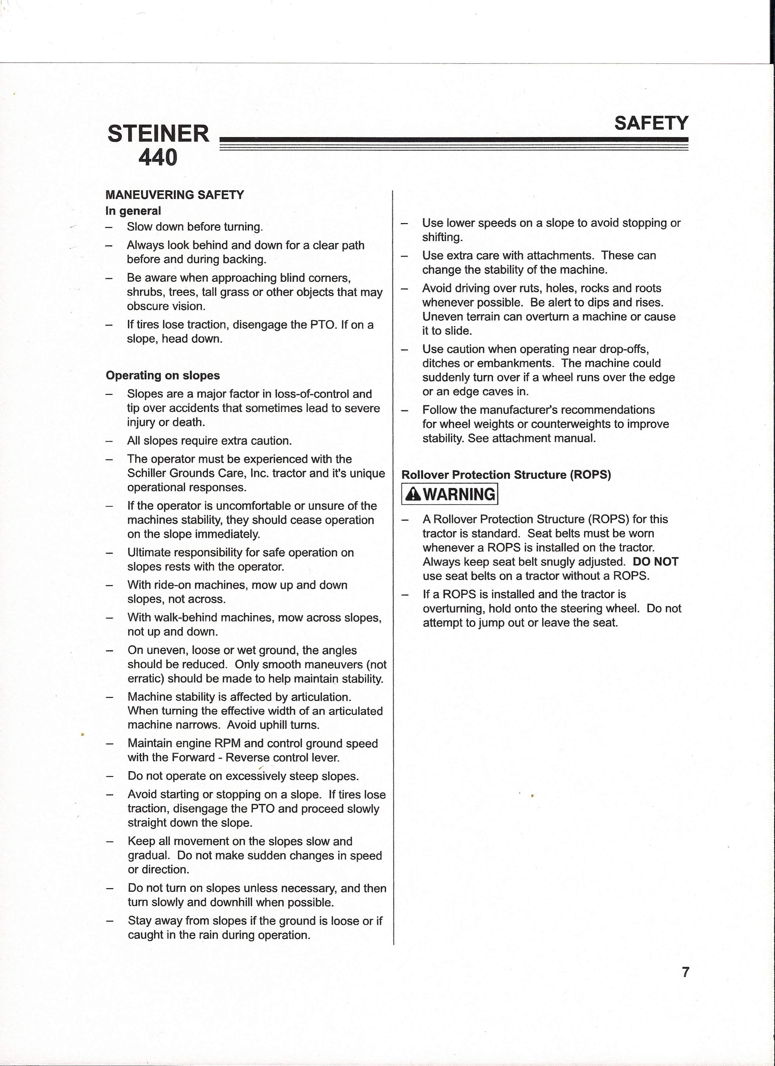

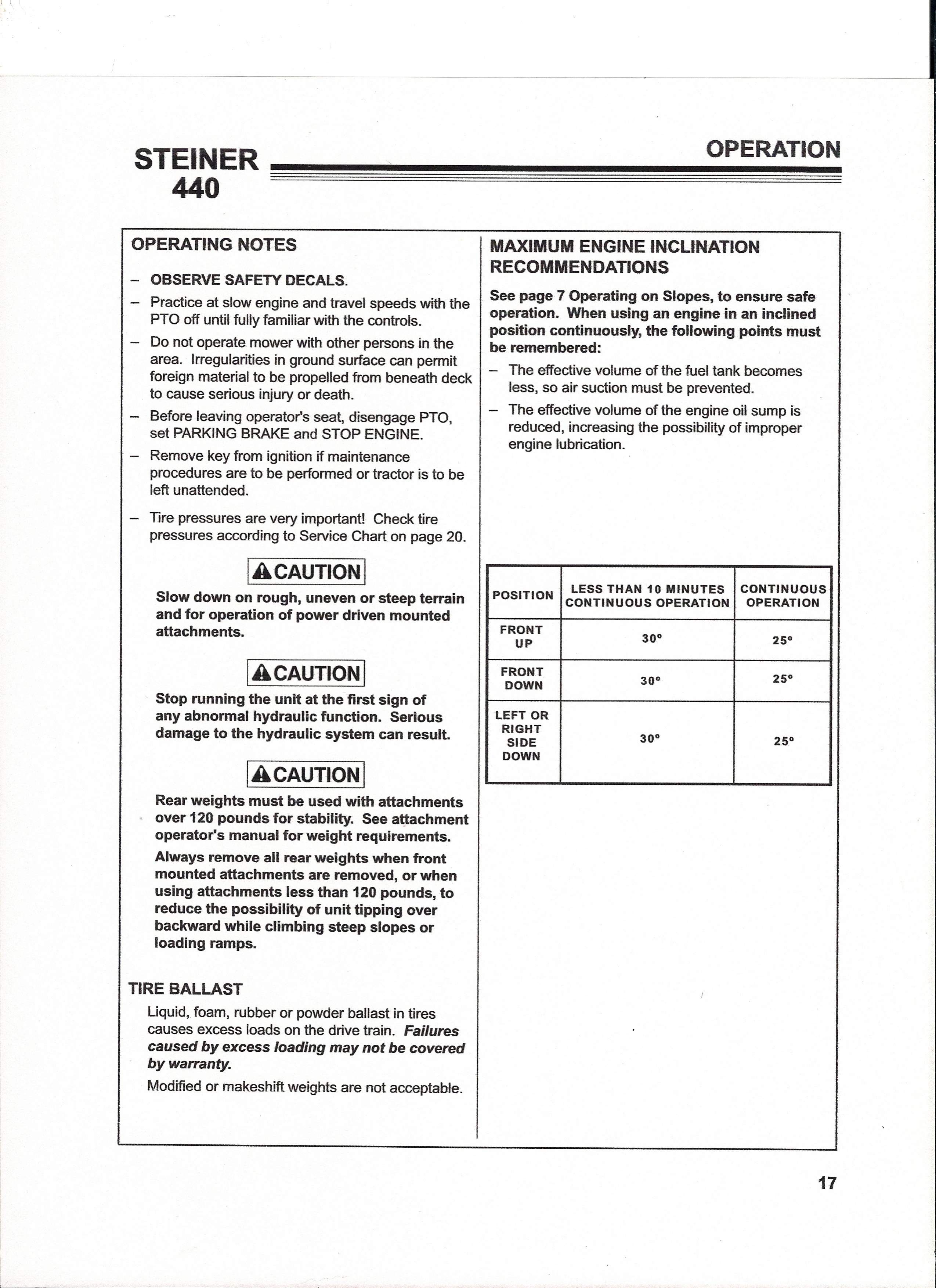

Was hoping to hear more on why Steiner doesn't brag about slope mowing capability.
Another question that just came up was how do either do with the Tough Cut mower in wet conditions? The trails we have to mow do have wet spots.
   / Ventrac 4500 vs Steiner 440 #10
It will cut wet material fine. I do not have wet spots that I mow with mine. I would think the lack of ground clearance can be an issue with them if the areas are fairly mushy or swampy. Don't know why Steiner does not brag about slope capabilities. They do not have a very informative website either. I did scan a couple pages out of my owners manual about slopes for you.
