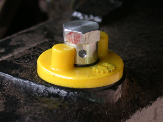

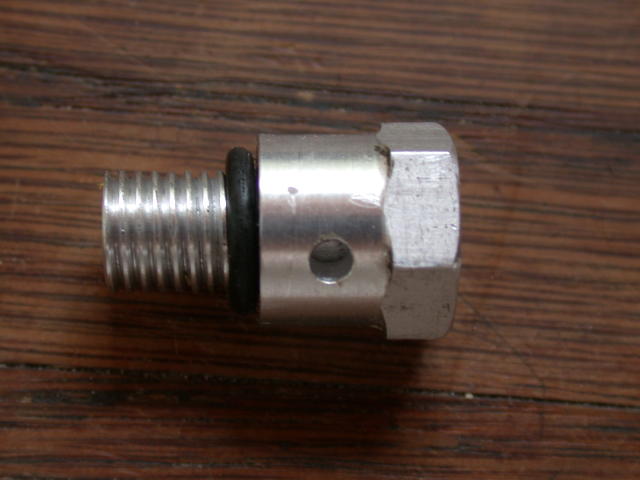

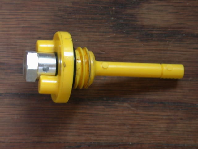

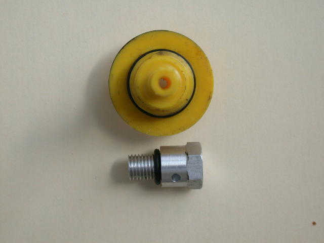

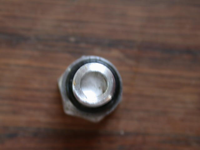

When I sold my last tractor the new owner said the front axle was dry! Yikes! I only had 100 or so hours on it, how could that be? When I got the new tractor I tested my theory that the front axles build up pressure from heat and it pushes the oil through the seals. (I found the same problem on my friends 990 (now the 4005) and we added a quart of 90 weight gear oil to it.
Time to make a vent:
I wanted something that would allow me to still use the dipstick and I didn't want to drill a separate hole in the casing for the vent so I incorporated the vent into the existing dipstick. I also didn't want it to stick out too far and get accidently hit by branches or rocks.
First I drilled a hole through the dipstick (photo 1) with an 1/8 inch drill. Then I machined out the end of the dipstick and tapped it to 5/16-24. I then made the plug out of 2024-T6 aluminum and filled it with material from an N95 breathing mask. ( I made a little punch to give me round padding that I packed into the plug. Lastly I put a gasket on it and screwed it in, then blew through the dipstick to make sure it could breath before I put it in the tractor. Walaaa! It works great and after several hours of work my front axle has no pressure build up.
Rob

The final version has the tube closed off and two holes drilled at the top of the tube by the thread.
Rob
