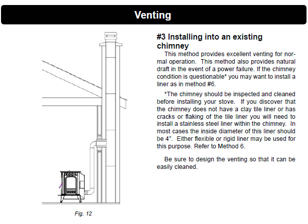

I'm taking delivery of a pellet stove this week. I had planned on venting through a wall, but I have an existing masonry clay lined chimney I had used for a wood stove years ago that I'm thinking about as an alternative to going through the wall with a vent kit. From the pellet stove instruction book this appears doable and will provide a natural draft in the event of a power failure. The stove dealer had suggested/recommended lining the existing chimney with stainless piping. I'm not sure he is simply making this recommendation so he can sell the pipe for lining the chimney or if there would be an issue of drafting properly. The chimney is lined with 8" clay tile.
Wondering if anyone else has vented a pellet stove through an existing chimney and has it worked out OK.

Below is a screen shot of the manual (Harman pellet stove) regarding a chimney install. The chimney is in good condition with the clay tile liner, so according to the manufacturer an install without a liner should be OK. The stove dealer recommends a liner, as well as some of the posters here, so I'm still not sure which direction to head in regarding going into the chimney.
My alternative install would be about 72" of pipe at a 45 deg angle from the house wall to clear from under a porch roof and would be cheaper than the chimney liner.

Stove shop told us that the liner is used to ensure no leaks and it is the right size (not too big). If your clay liner is in good shape, and not way big, sounds like it would work to just use it.
   / Venting a Pellet Stove in Existing Chimney? #10
Big problem without a liner, with an exterior chimney, a pellet stove doesn't produce enough waste heat via exhaust to make the chimney draft well.
