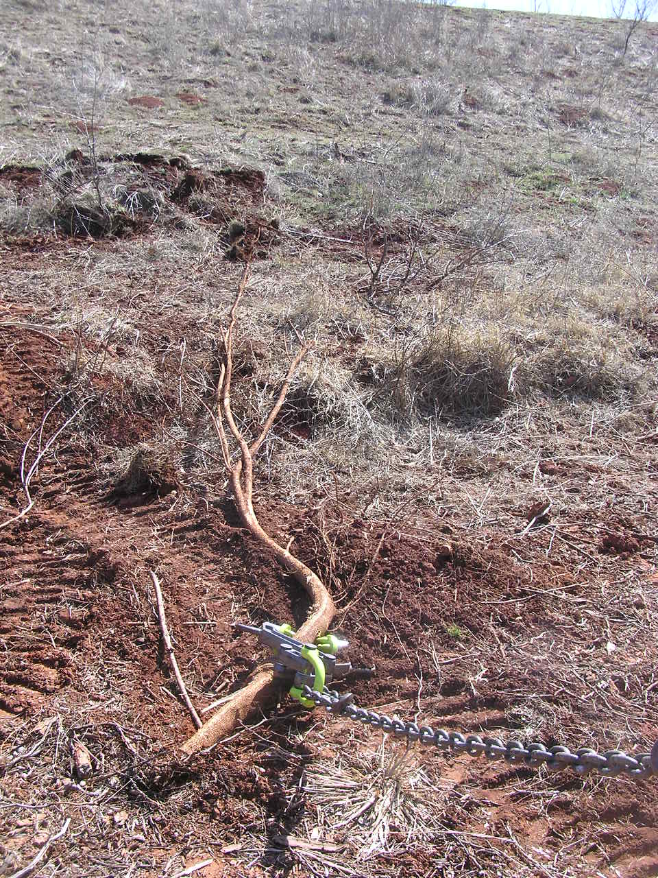

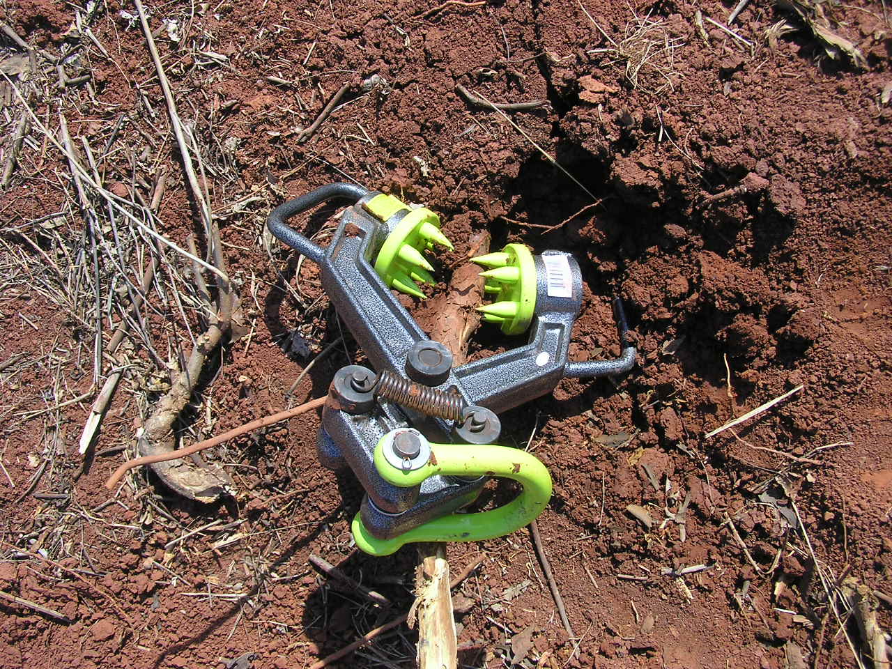

VENDER FOR STUMP REMOVING TREE HOOK ?

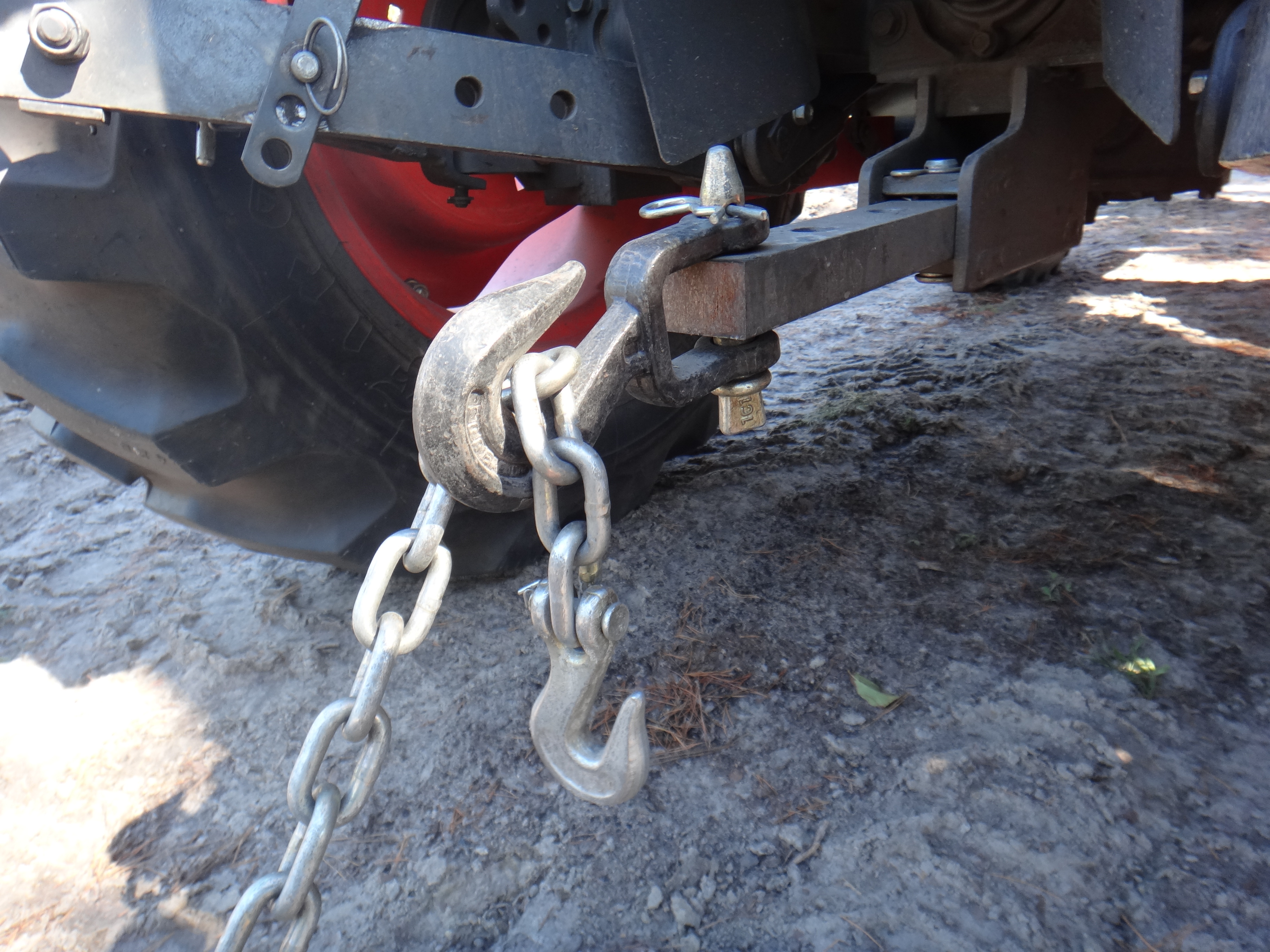

The maker of that hook has probably been out of business for 100 years. :)
And someone needs to buy that man a drawbar hook.
Bruce
   / VENDER FOR STUMP REMOVING TREE HOOK ? #3
Take that ball off the tractor drawbar and put a clevis on it. And lose the bent blue drawbar. This is not the correct application for it.

I'm not sure why people try to use chains to remove stumps. If something goes wrong and the chain snaps, or the clevis doesn't hold the chain, is going to whip through the air and destroy anything in its path.

Totally agree, nothing better than chain for pulling mainly because it DOES NOT stretch and build up a reactive force like cable, rope, nylon straps etc does should it break. At most it may react by recoiling a few feet. As long as one uses the correct size and grade chain that exceeds the strength of the pulling component, there is not much likelihood of a break.
   / VENDER FOR STUMP REMOVING TREE HOOK ? #9
Chains can recoil long distance. Long ago I tried to move an old stump from where a dozer left it after removal. I had been dragging brush, so I only had two 1/4in chains, about 30 feet total. Chain broke near the stump, recoiled about 20 feet and broke the window on my 4x4.
A chain stretches before it breaks. That energy release can really send the chain flying. I think the stories of a broken chain just falling is when there is a bad link that fails before the chain stretches.

If it were me I would dig out the stump. I wouldn't pull it with anything until it was mostly free... Many ways to skin the cat.
