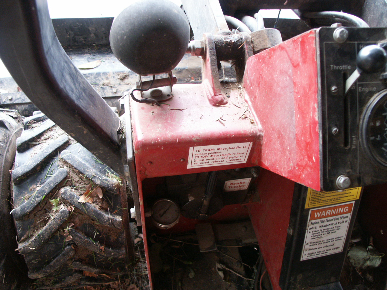

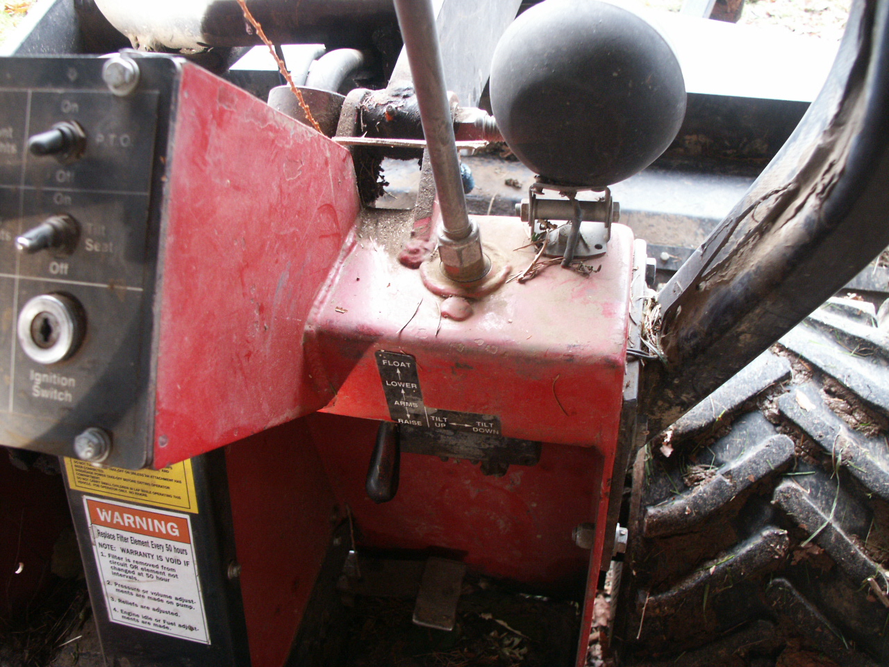

JJ, look at the photo of the top of my PT where the control arm comes up. The lift arms are welded in the same area, so I am not sure if cutting that area open would be a wise idea. Your thoughts?
Carl,
First, try and determine if your valve has PB. The lift arms on your machine and mine are similar. As far as you have enough space to fit the valve, I would call Baileynet and ask them for dimensions on the valve. That is a six station setup, which should satisfy any future needs.
I have two of these valves that are PB capable, and they are small. might be enough room for both to go in the same spot as the three gang valve, or remove the three section valve, fill in the hole, and bore new holes for the two new valves. Will control four cylinders
https://www.surpluscenter.com/item.asp?UID=3836011719354492&item=9-7401&catname=hydraulic
If you click on DRAWING, it will show the size of the valve.
