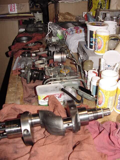

P.S. If you are interested, I attached a photo of what my 2T72 looked like at one point...
