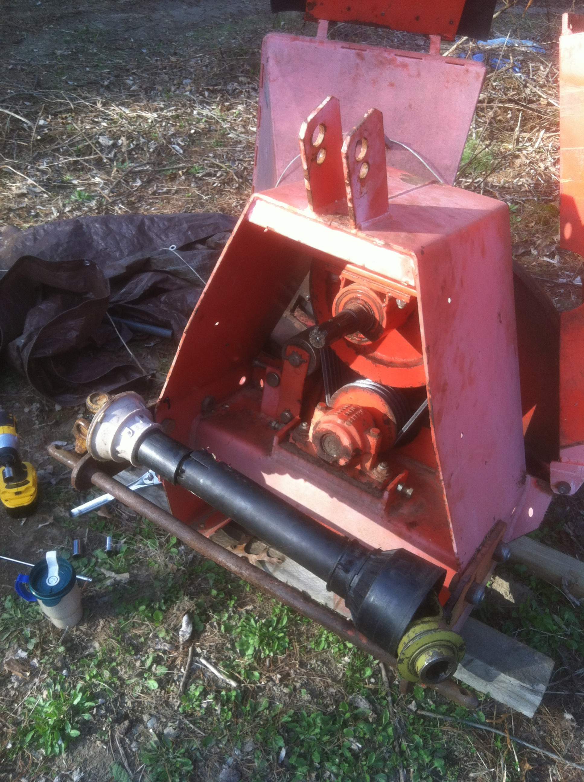

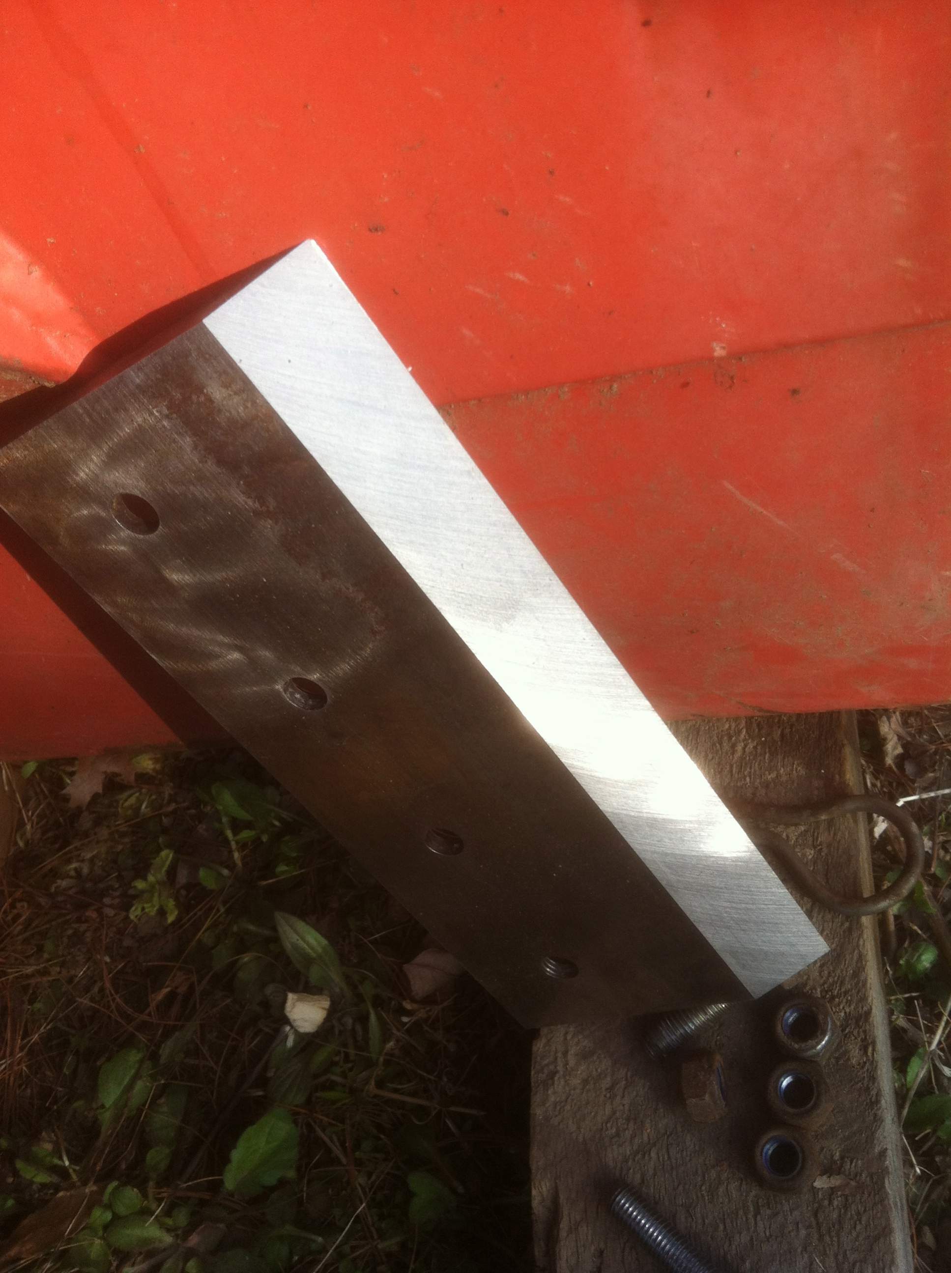

I started running mine before I totally understood the machine-ended up breaking a belt-So I replaced those- not a fun job- the top pulley weighs about 60 pds and the flywheel is about 220. ended up using the Deere to pick it up enough to get the four belts around the shaft. also had the blades shapened.-see attached. I'm having trouble now however as it won't self feed and if you throw a 4" piece in, it will bang around instead of feeding. I will call the distributor in NYS tomorrow for advice. I believe I have adjusted the blade to anvil clearance to spec but something is not right-
Stay tuned
