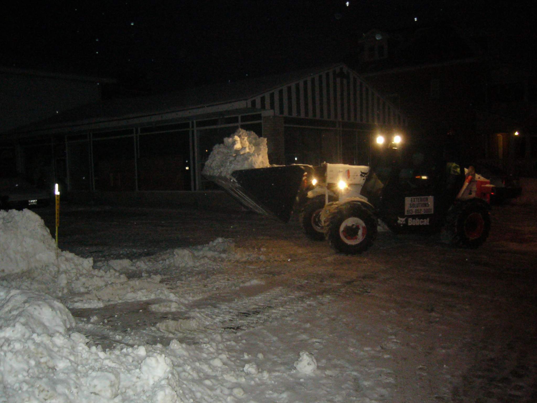

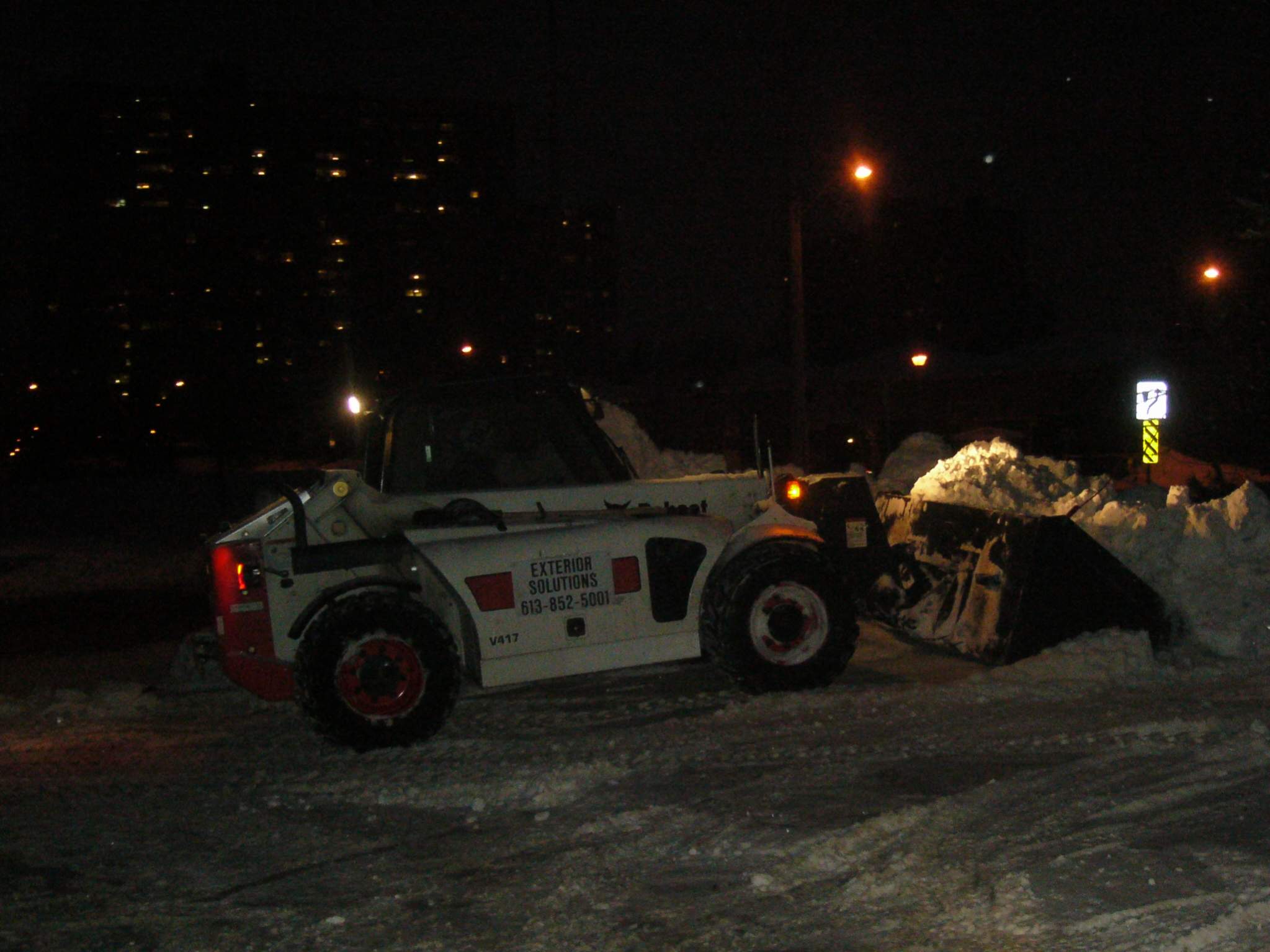

Well, i purchased the V417 last month and now have 200 hours on it. I'm very impressed so far. It is much more machine than the toolcat but really over kill for small applications. I use it on large parking lots with a 100" snow bucket. Just pushes like you would not believe. Stacks very well and is easy to handle. I hooked up my tc blower for a day. It throws the snow twice as far as the tc. the creep setting takes a bit to get use to. The blower does not work well in residential settings. too awkward. If I need to do residential with it, my 10' box blade is the easiest to use. I've found the blade does not work too well on parking lots as the v417 sits higher than my tc and the attachment point is too high so it does not clean very well.
