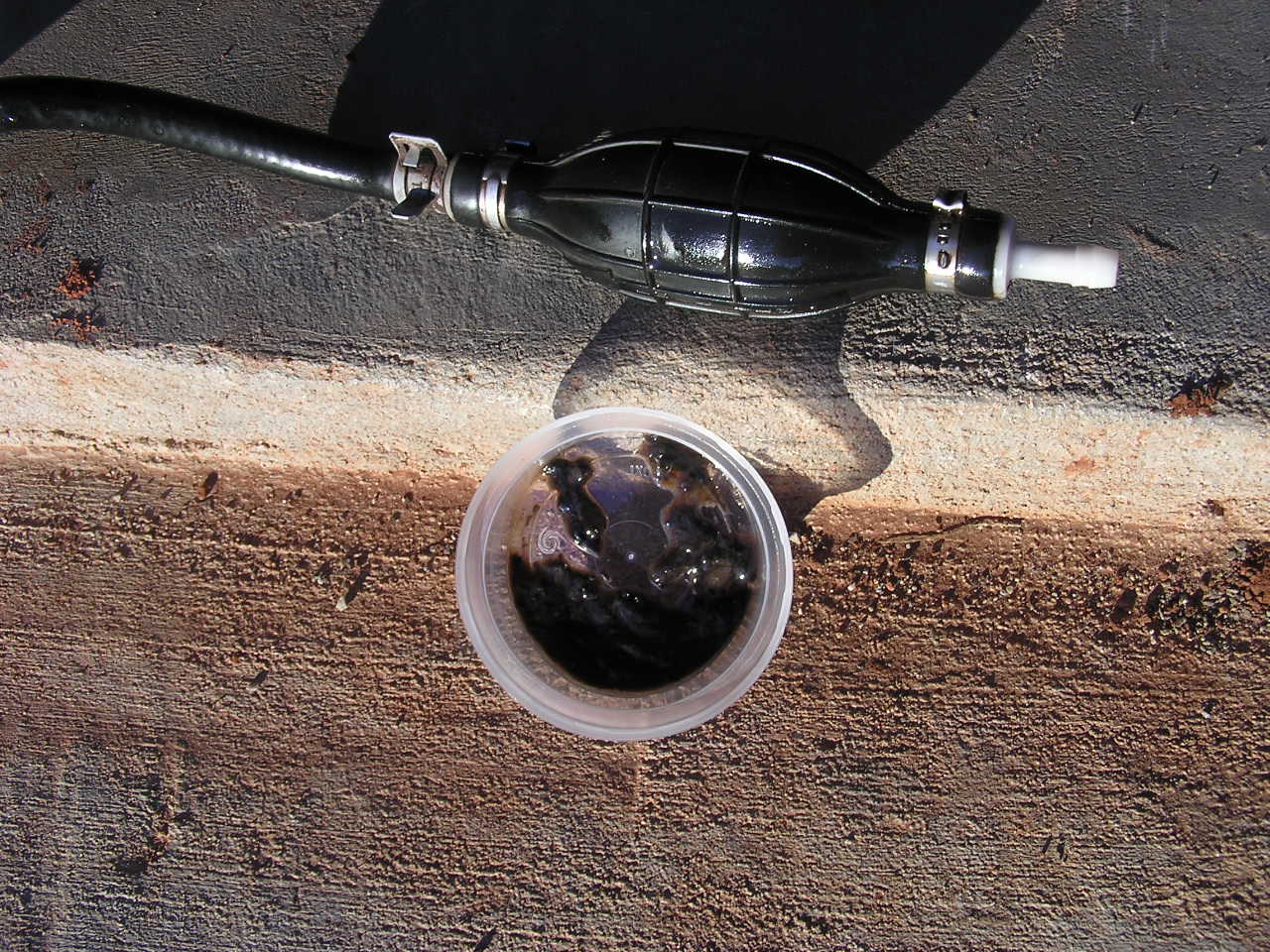

Had been pulling cedars for an hour, the last 5 minutes on a slope with the right front low. Moved to a level area and the rpm's dropped like it was running out of fuel, turned it off, knew there was about four gallons in the tank.
Opened the hood, checked for water in the fuel filter, just red diesel came out. Tried to squeeze the primer, no give, it was solid.
Removed the hose at the lift pump, squeezed as hard as I could and this is what came out.
Removed the hose from the tank at the primer and got red diesel. Cut a piece of fuel line to bypass the primer, primed it by wrapping a rag around a short hose and blowing into the tank at the filler. Started it and drove it to the shop.
Can I just flush the primer or should it be replaced?

I would replace it. Primer bulb isn't expensive, that stuff might not clean out of the check valve.
   / V417 Versahandler Quit Running. Look what came out of the primer. #3
OH, yuck - - that mess has the look of tadpoles. You can take the primer bulb apart - clean the bulb & the check valves and reassemble. You can easily check all three components, visually, and see that you got them clean. You might want to drain the last few gallons out of the fuel tank to be sure none of the crud is in there also.

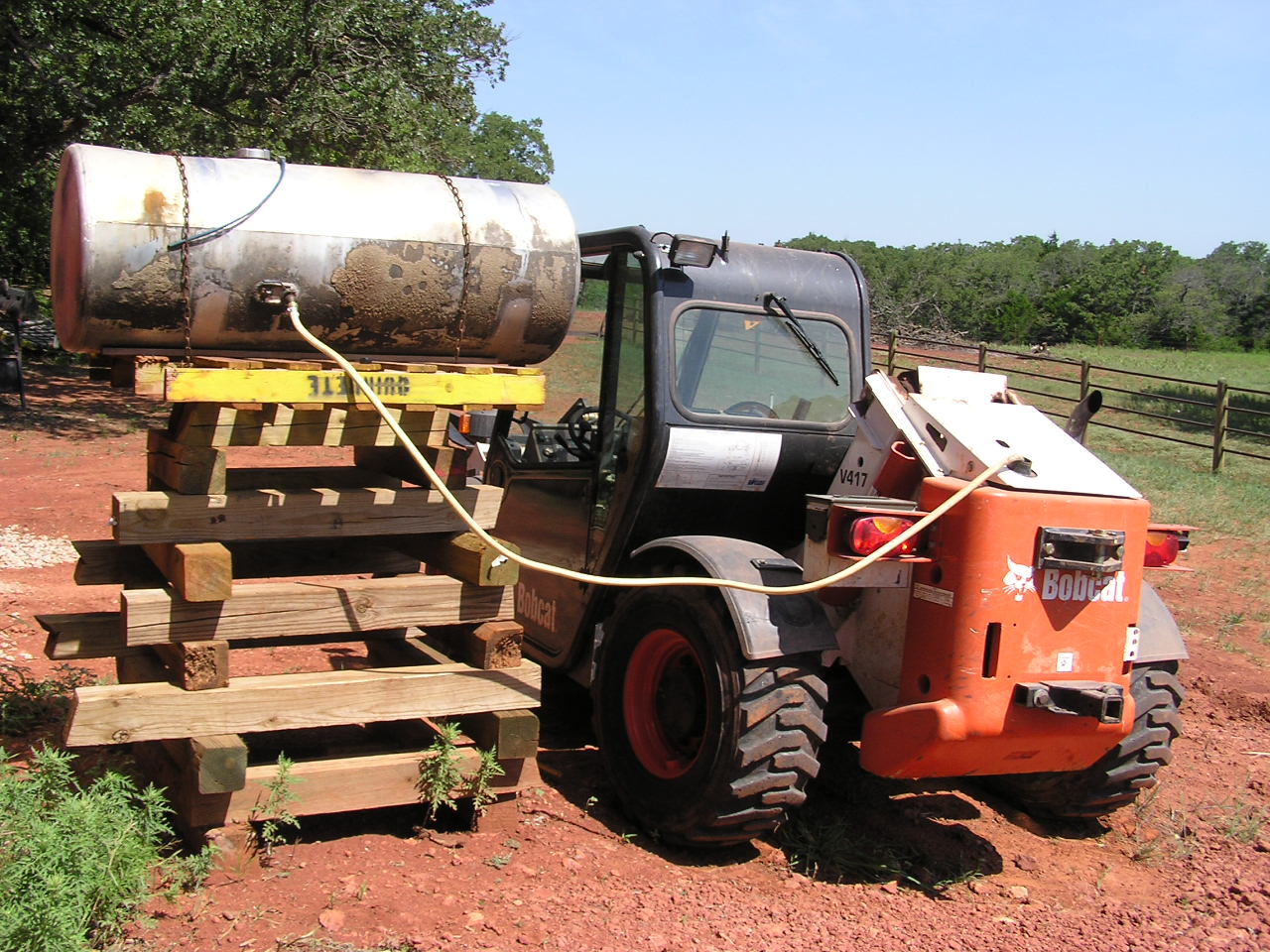

I think the fuel tank is steel. The "stuff" came out of the primer bulb that was not allowing any fuel to go through.
I have used it twice since, it is running fine with the bypass hose.
Have been using diesel equipment with off road diesel for twenty years, never had a fuel related problem, never used any additives. Up until three years ago, 99% of it was bought at the local Co-op.
For the last three years I have bought 90 gallons at a time, at a Shell Station that has off road. I use this 100 gallon aluminum saddle tank on a skid, to keep it in.
Guess I should check the 4 other diesels that use fuel from the same tank.

If the other equipment has the same sludge, the fuel tank may need a filter at the hose connection.

Looking at your pic up close, I don't see a fuel filter on your transfer tank. If you don't have one, I recommend you get one ASAP. Older diesel in the tank can separate, grow organisms, etc. Napa and Tractor Supply sell a water/dirt block filter. You may need to run a powered transfer pump but it's worth it over gravity feed without a filter.
