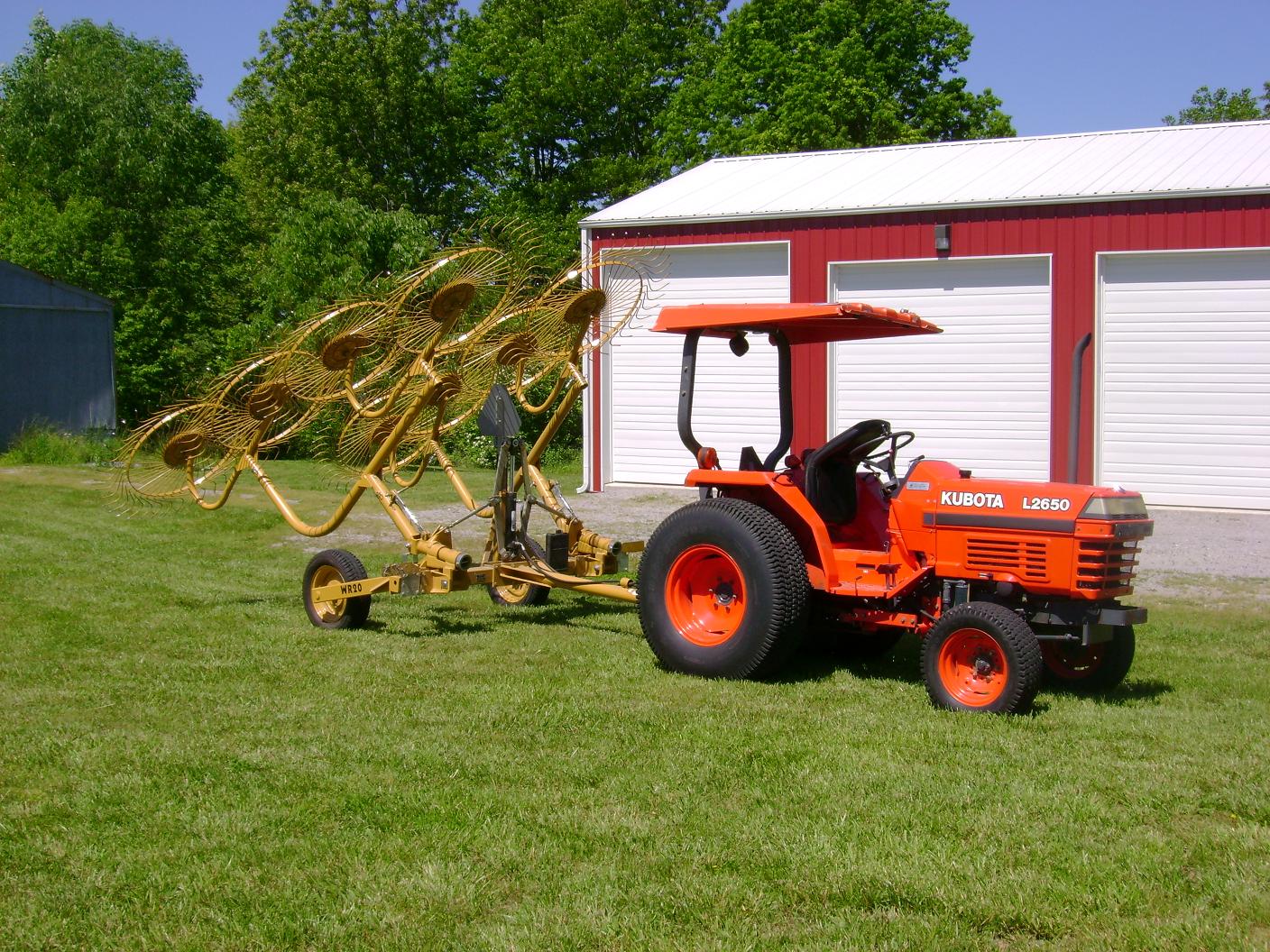

What is the best v rake for the money I have used a vermeer wr20 it seem to work good
   / v rake #2
Most of the V-rakes are very simple and work very well. In my area the Vermeers were a little less expensive than some of the others. Used ones are easy to find. It depends on parts availability in your area and what color you like best.
   / v rake #3
They are all similar in quality in my experience. I cant even remember who makes my eight wheel v, but it works great and it's never given me any trouble.
   / v rake #4
I assume wheel rakes are ground driven? Do they spin fast enough to do a good job?
It doesn't seem like a tractor would provide enough speed for them to work very good.
   / v rake #5
They dont spin very fast at all, but they do an amazing job. You dont have to pull them very fast either. I pull the 8 wheel rake with a John Deere 4100 CUT and it does a great job.
   / v rake #6
I have a WR20 and pull it with both the M9540 and the L2650. It does a excellent job. It is mostly behind the L2650 with the M9540 and baler close behind. I use a 2pt drawbar with the L2650, the hitch is a little to low and the rake does a better job when it is level. This way the amount of down force needed can be adjusted depending on field conditions. We used to use two rollbar rakes pulled with a dollie, one left hand one right hand. The V rake is so much better.
