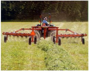

I own a H&S Hi-cap bi-fold 14 wheel rake that has raked untold 1000's of acres that I bought new in 2002. I owned a Vermeer R23 before I bought the H&S. I have yet to find a crop it won't rake. I have raked hay with my rake that was making 8(eight) 4X5.5 rd bales per acre.I rake 3 nine ft cuts unless the field makes over 4 rd bales per acre. The secret to getting the undisturbed hay picked up by baler teeth is travel the with baler the opposite direction that the crop stems are laying. I cut CW with a disc cutter that lays hay flat and I bale CCW. I personally don't like nor would own a "fold in the air" similar to a Butterfly rake. The frame on most of these type rakes obstructs the flow of the hay especially if hay gets very thick. Plus there's not good way to adjust amount of hay to be raked and windrow width. I can adjust windrow width with a crank on the rear and raking width with the touch of a hyd cylinder control lever

If you decide to get a wheel rake if you get one similar to the on I posted the photo of it will not ball up and it will rake around the corners.
