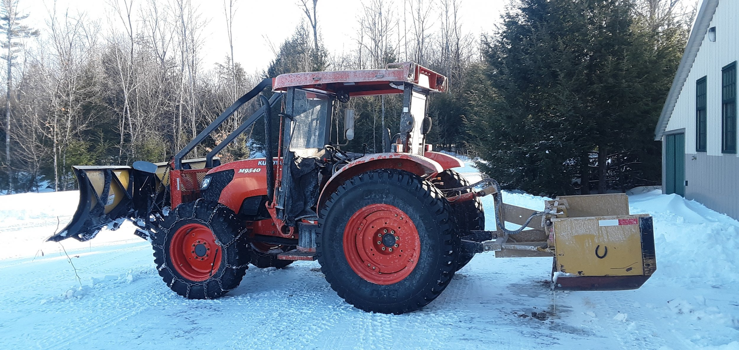

This might not be what your thinking about. I built a frame mount for a truck plow, that's a Fisher 9.5 xv2 on the front.
The only picture I have on my phone.
The wings are plumbed in to the loader valve that stays with the tractor when it's removed. The 3rd function works the lift cylinder for the plow.
