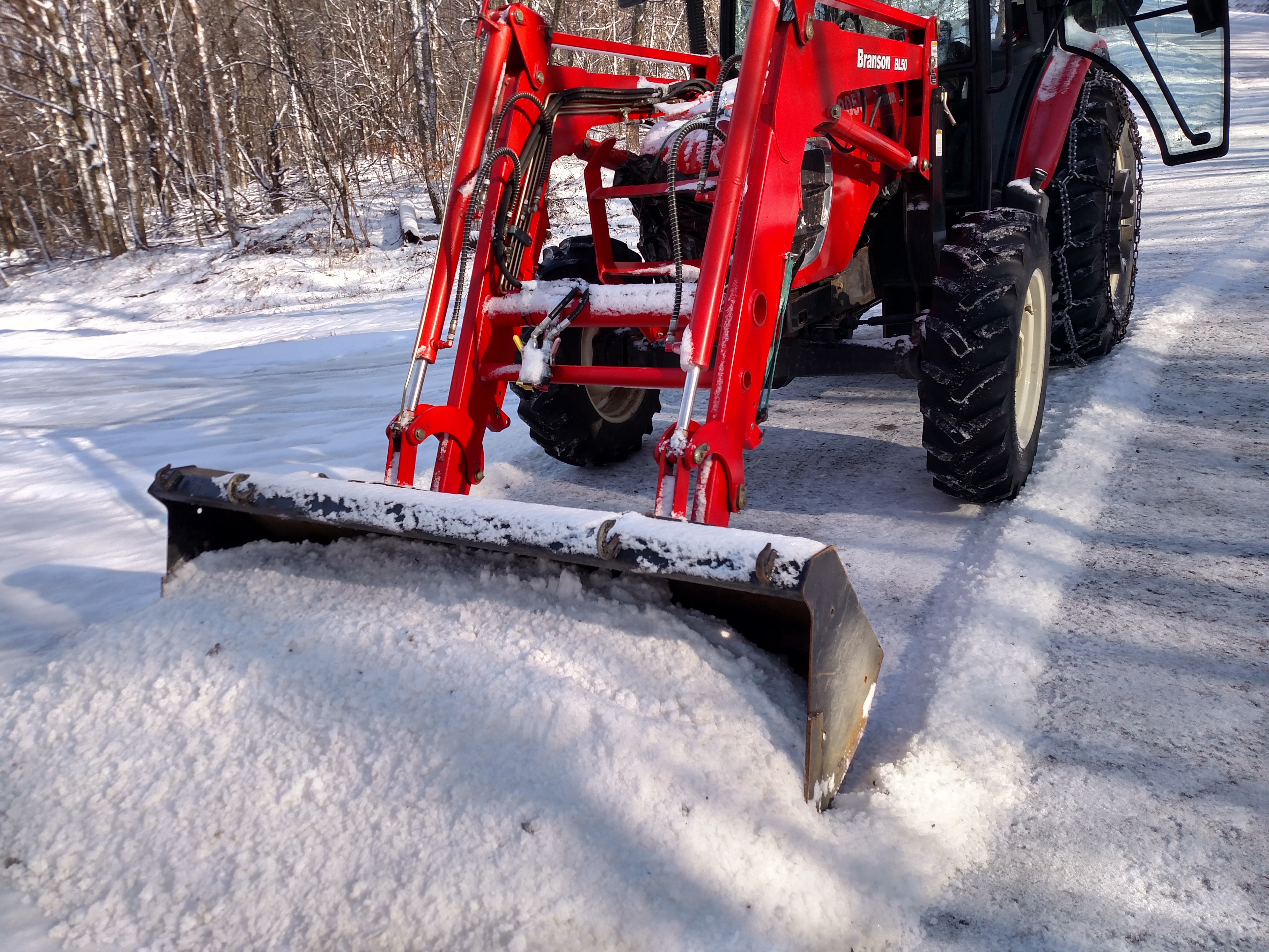

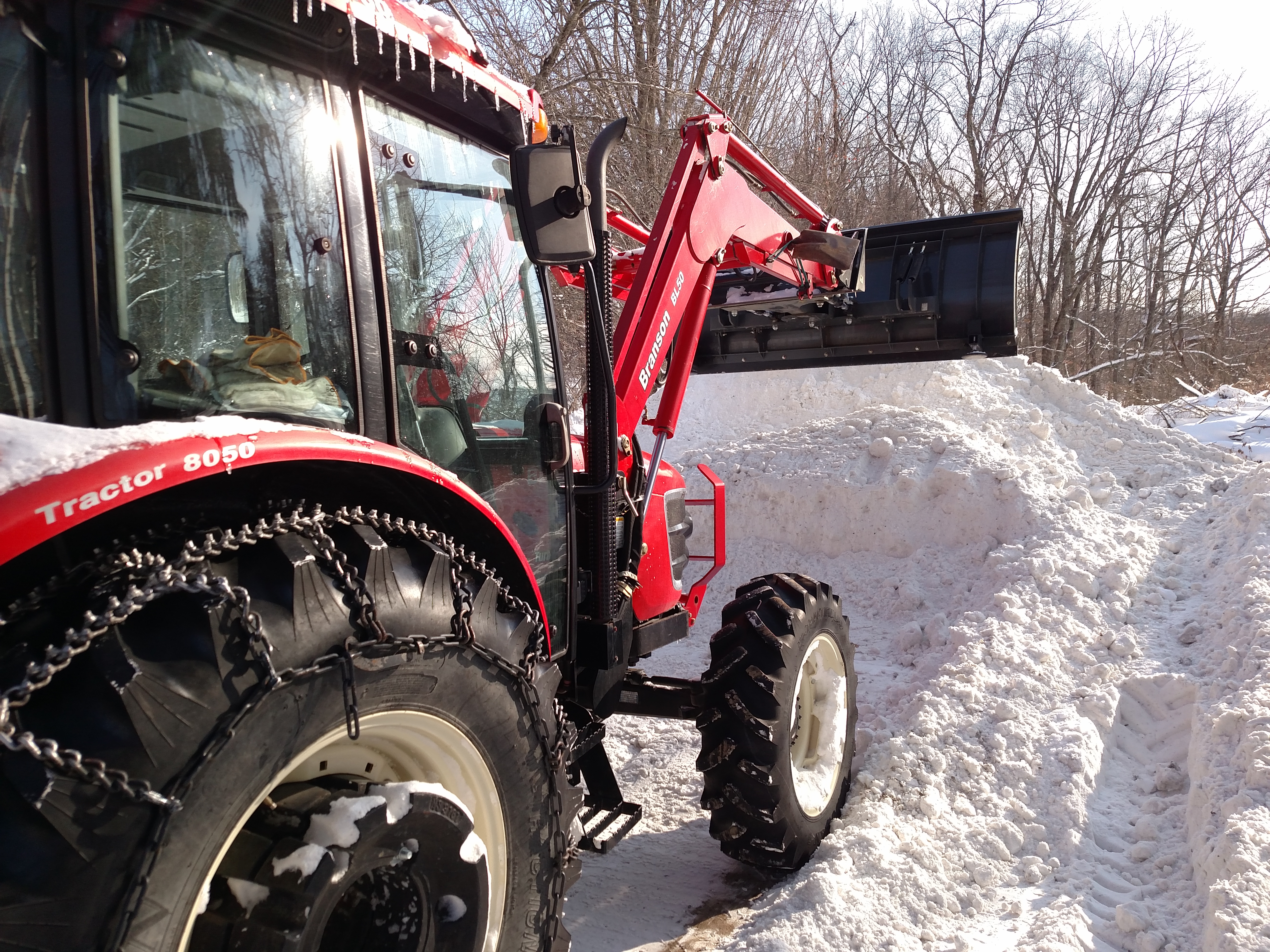

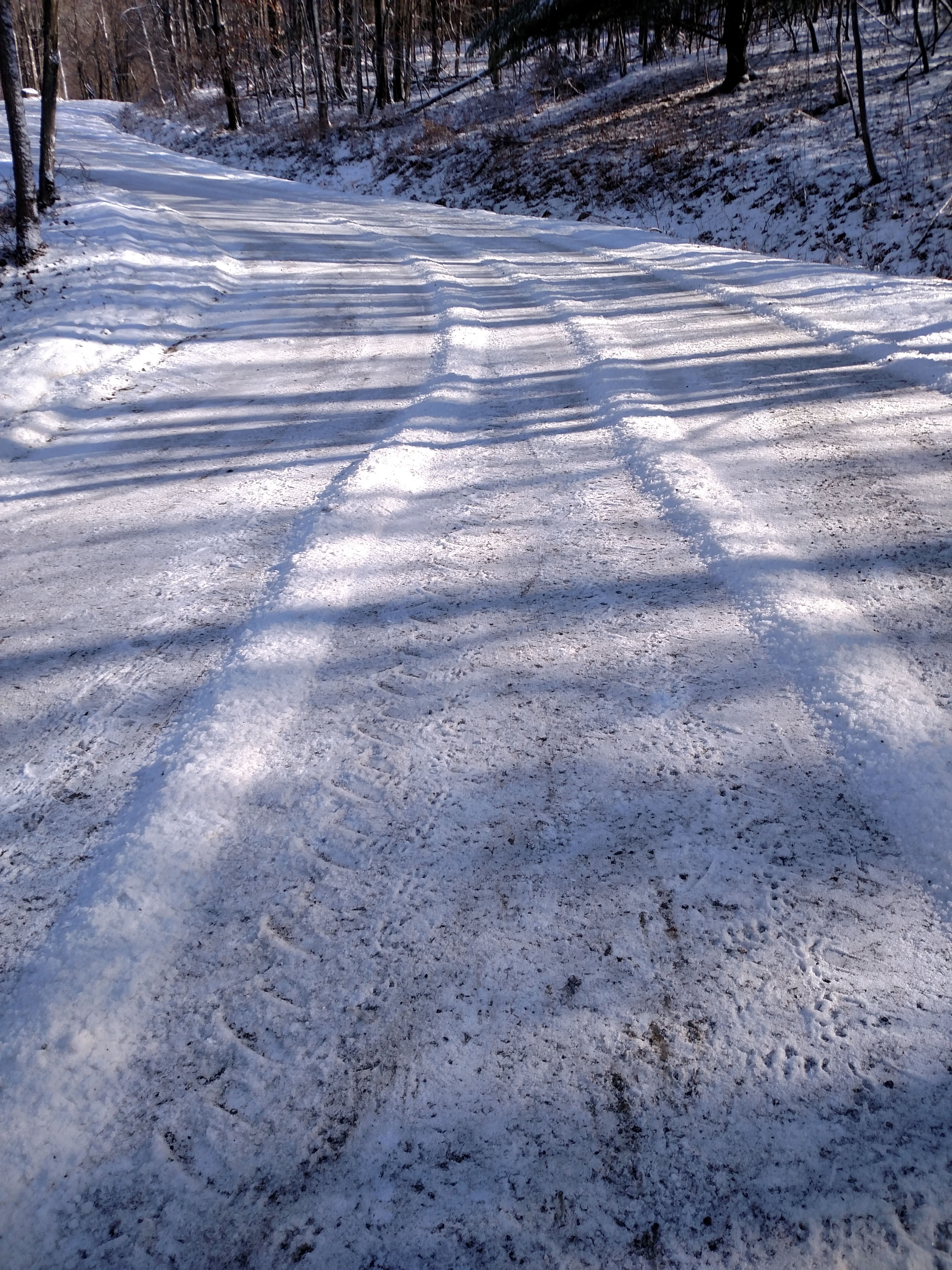

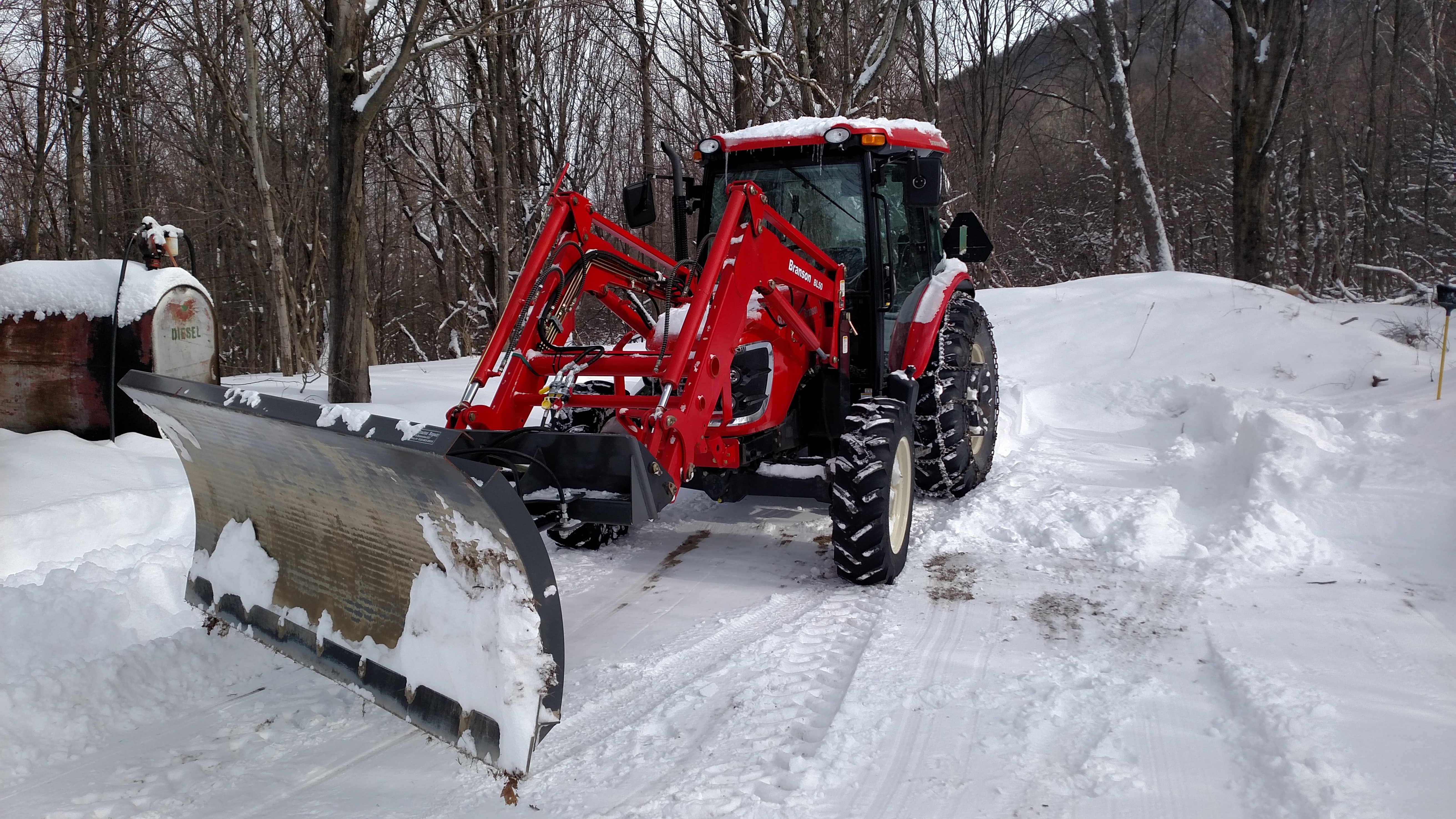

I wouldn't recommend trying to plow at high speed but using reasonable care;
Branson an blade.jpg View attachment IMG_20180205_104002041_HDR.jpg View attachment IMG_20180205_104017943.jpg
You can move quite a bit snow with a loader and blade or bucket, the first pics are using down pressure to scrape ice and frozen snow.
I also have a truck with a plow but I use the tractor to plow with and save the truck for sanding duty.

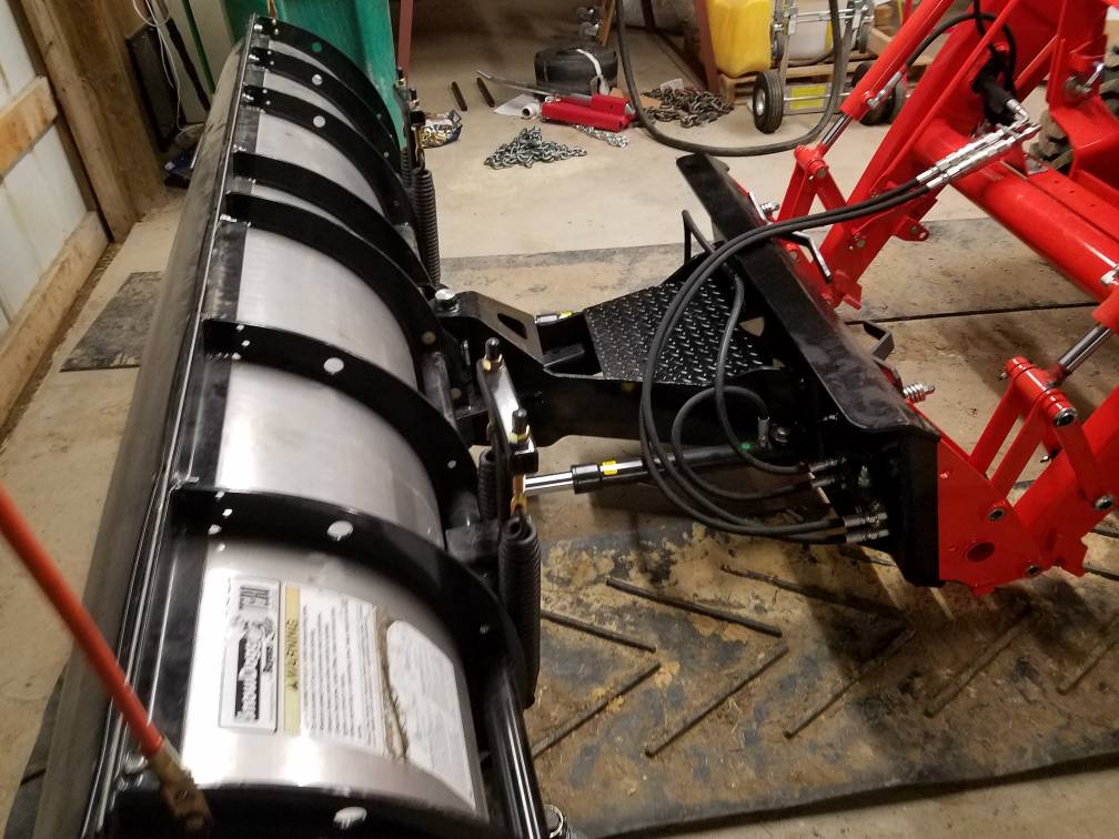

I have a power angle snow plow for my little machine on the FEL arms. It works GREAT! It has gauge wheels, so I can make all of the weight of the plow ride on those wheels if I want just by putting it in float. That helps greatly with undulating terrain. It also prevents gouging in grass and gravel. Not only can I angle it hydraulically, I can also lift it and dump it like a bucket. The plow works way better than a bucket for moving snow. Way better. My unit is small. If I had a larger machine, I would adapt a pickup truck plow with the trip mechanism. It's not necessary on my small machine, but from my past experience with pickup type plows, you need that trip mechanism on a blade on a larger machine in case you hit something solid or you may damage your machine.
I can also curl the plow down and take it off the gauge wheels and scrape right down to the pavement if I want to. That's handy for that last 1" of slush or ice. It's also handy to be able to drive right up to a garage door and back-drag away from the door while scraping the pavement. Again, you have to watch for solid objects, but you should know your area.
