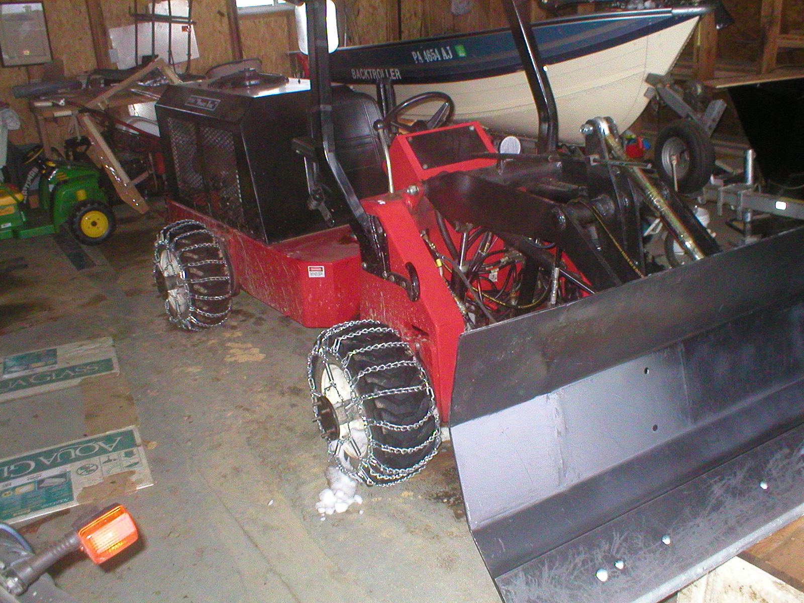

The v-bar chains would be good for ice and off road, but if you have cement or blacktop they will tear it up. I put regular 2 link ladder chains on my 1845 (R4 tires) and it goes good in the snow but I don't know how it would be on ice.
