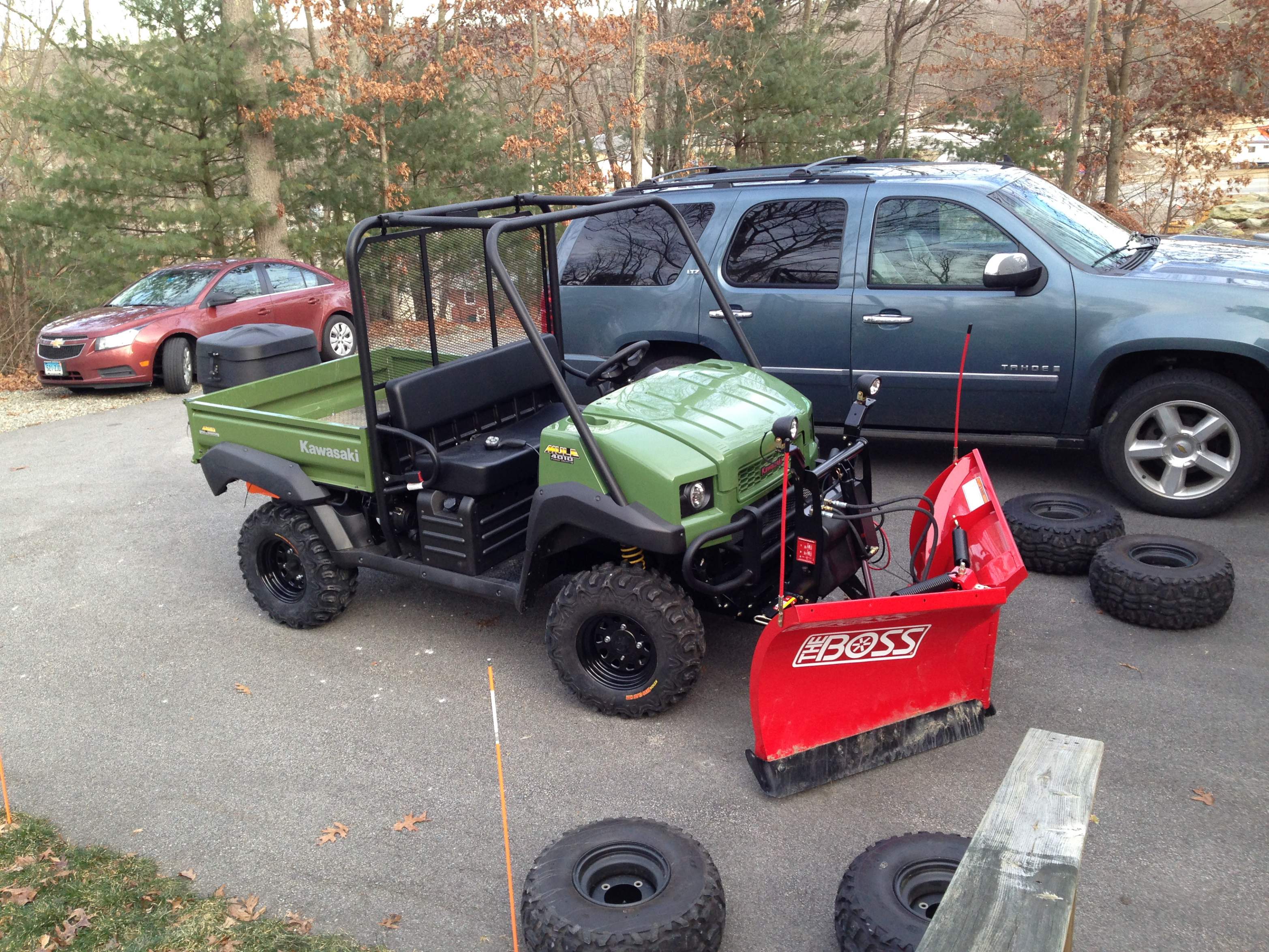

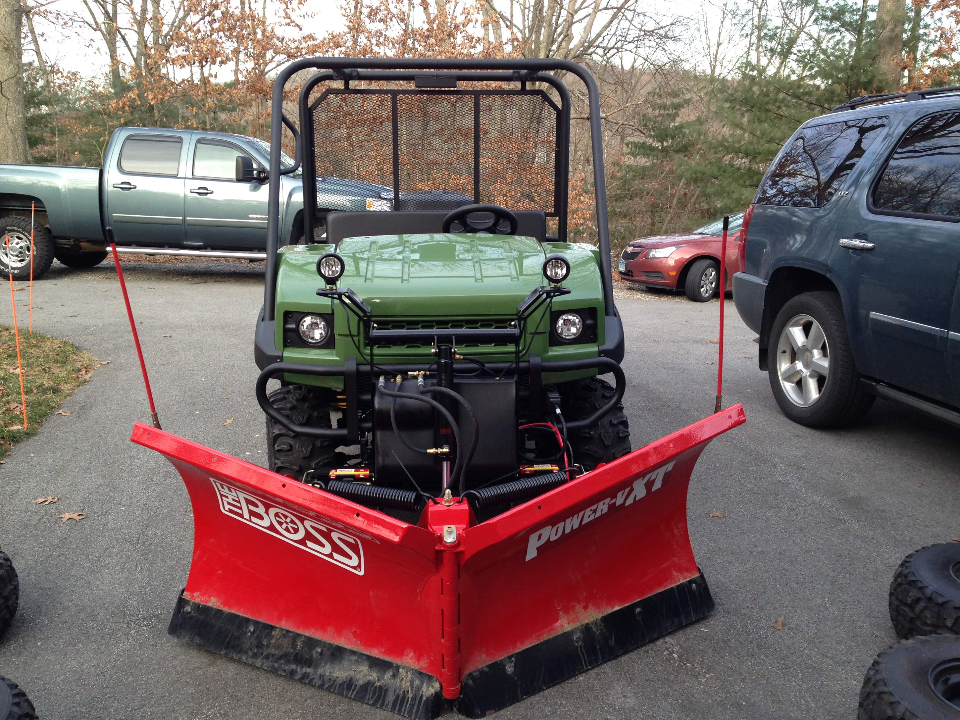

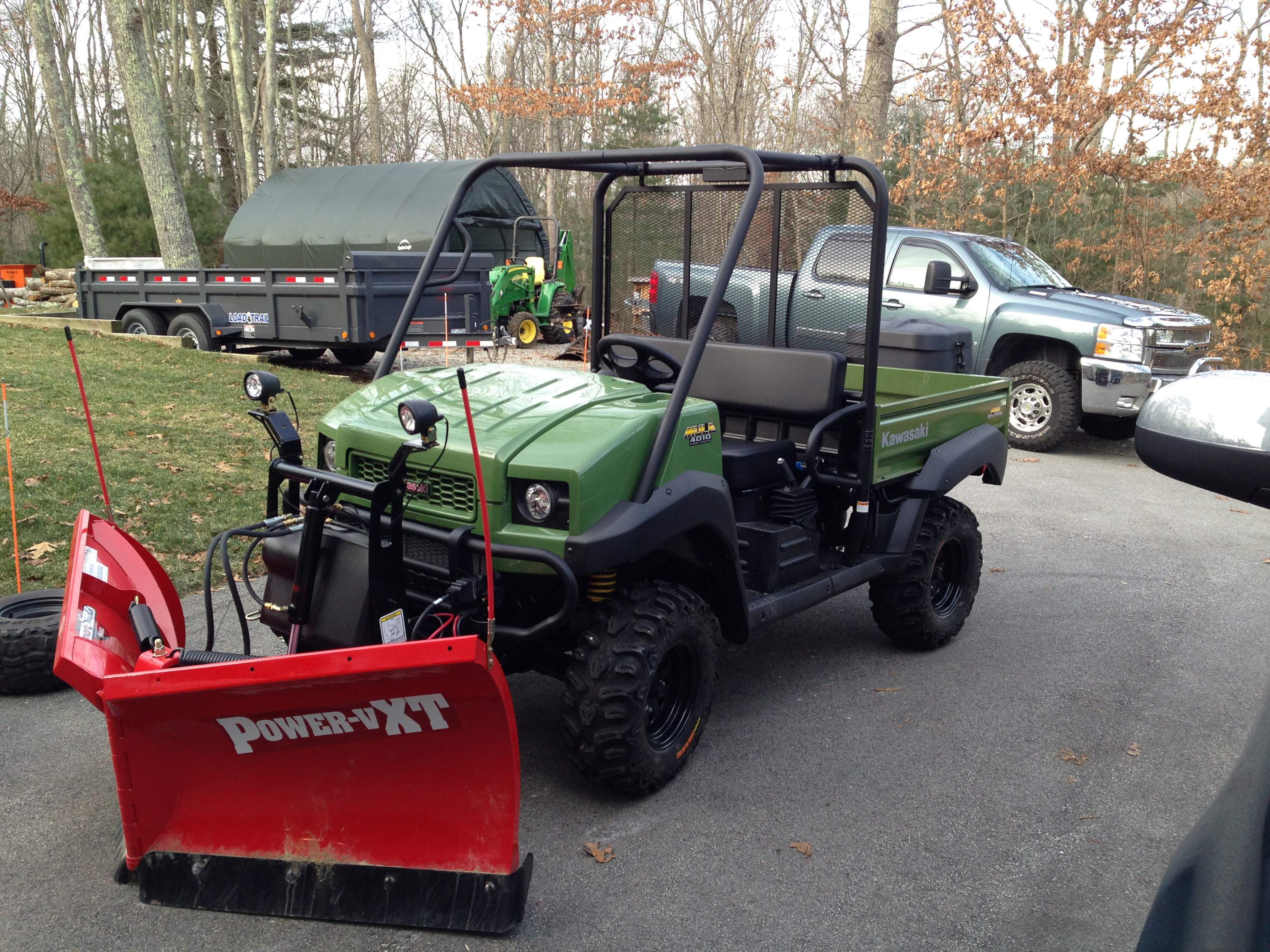

Thought I'd show pics of the finished install. All that's left is the cab and dump kit.

Looks good...you've got the first light kit I've seen on one. What did it take to wire in the lights with the Boss light kit?
   / UTV Vee Plow
It's plug and play to add the lights on the plow side, the switch is straight forward as well since it comes with it's own harness. The lights are very bright, since the plow lifts so high I can't imagine being without thens. I also end up doing 90% of my plowing at night so it's a big help.
   / UTV Vee Plow #9
So there wasn't any splicing at all?
   / UTV Vee Plow
Not really, I should note that I'm an electrician so my perspective may be off. But the lights get plugged into the plow side harness and the vehicle side requires mounting the switch and running a small fused harness to a 12v power source and plugging in(blade terminal) to the vehicle side harness. It was probably the easiest piece of the kit to install. The smart hitch 2 required a more detailed understanding of wiring diagrams. I contemplated tying the aux lights into the switch for my headlights but it's nice to have the flexibility to switch them independently.
