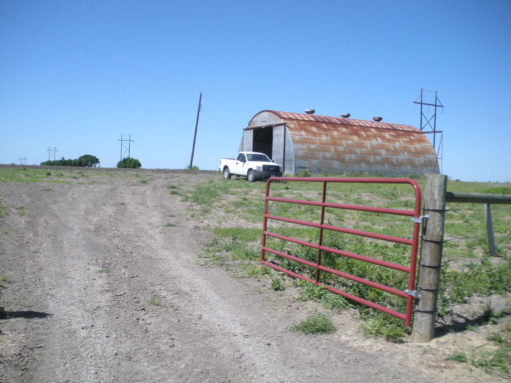

So I am thinking of buying a 1500 gallon water tank at TSC to put by the barn like this one:
Water Storage Tank, 1,500 gal. - 2126917 | Tractor Supply Company
I will also purchase a pickup truck style 250-300 gallon tank to tote water from my house which is about 40 minutes away. Since I go to the farm 2-4 times a week keeping the large tank filled should be doable.
What needs to be done to support the 1500 gallon tank on the ground?
Why are the black tanks priced higher than the white ones?

Not sure how to collect rainfall from my barn as its a quonset and doesn't have gutters. This barn has stood for 60 years in a very windy area and is in good shape other than needing a coat of paint. I am hesitant to make a bunch of penetrations on it to hang gutters and make it catch more wind.
There is a map of the county that shows all registered wells and there are none for miles around. Not sure if that means the water table is too deep or hard to find or what. There is an existing very shallow well at around 20-30 feet that can be pumped dry fairly quickly and takes a while to recharge.
I can get a water meter put in at the road for $3500 plus assuming its on the right side of the road and thus no boring charge but then have to deal with a 2000 foot run to the barn that goes uphill about 40 feet which means I would likely have to install some sort of pump with a very long electrical run from the barn......
The tanks seem pretty workable to me at a cost for both of around $850.
