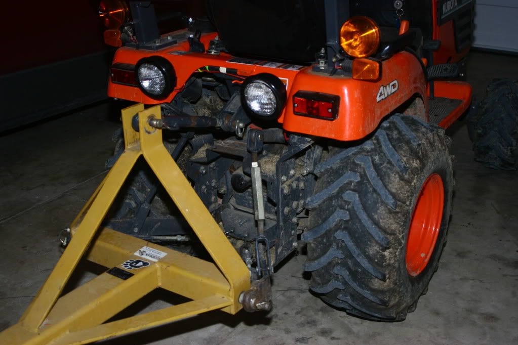

With winter coming upon us, I decided to install utility lights on the back of the tractor to make plowing easier at night.
The power source is the tail lights. The only way the utility lights can be turned on is if the headlights are turned on and then the utility switch is pulled. :thumbsup: :D

Weather proof swtich?

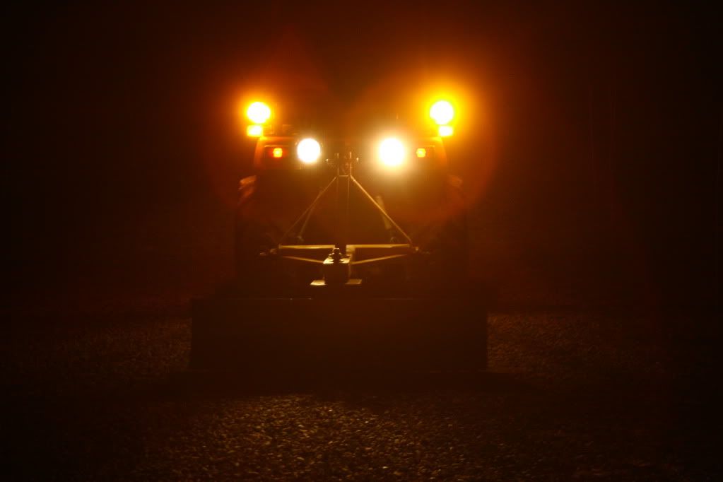

It's nice and bright :thumbsup:
The upper is, but the lower isn't, so I wrapped the contacts with insulation, finished it with half a roll of electrical tape, and used a heat gun to shrink part of a ziploc bag around the tape to seal everything up.
Very nice what size lights did you use and did you do the same for the front?
Thanks! They're just 35 watt lights....I didn't go for the largest ones available because I wanted to just wire in through the factory wiring harness without melting the 14g wire that they used. Just an FYI, I still used 12g wire for connecting the lights to the harness.
