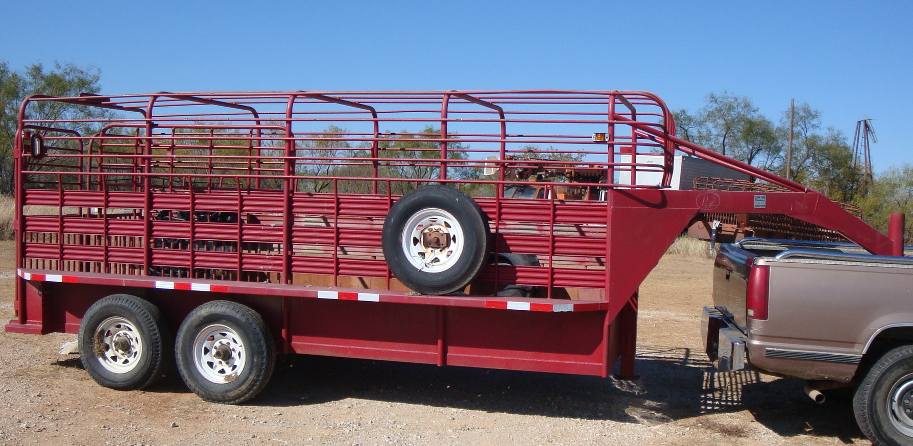

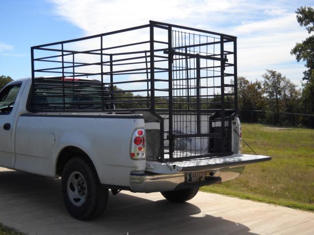

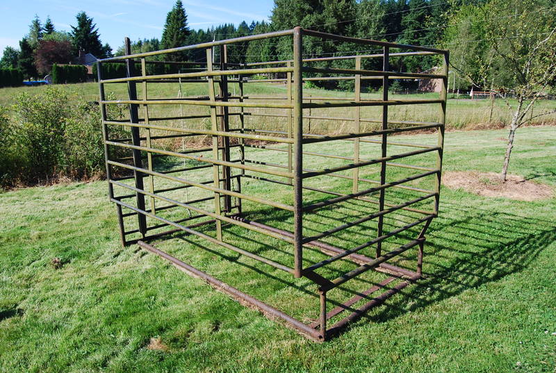

/ Utility/Cattle Trailer #2
the red unit is a stock rack for a goose neck trailer and the others are for a pickup box stock rack,
make sure there tied bolted down or on,

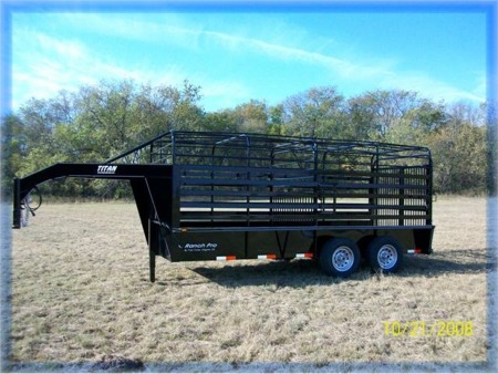

/ Utility/Cattle Trailer #3
here are two more actual stock trailers that are not much more than a utility trailer with a cage built on it, the red one is shop built the black is a manufactured unit,
Oh how those pickup stock racks bring back memories of loading and un-loading. And then a neighbor ask me to help him with a set he had borrowed. Rather than pipe construction they were built using sucker rod. I bet they weighed nearly a thousand pounds.

Hay..the red cattle rack/slide in type, is what I am looking for. I have a 16 ft gooseneck dump trailer...71 in inside width. Who makes these? I ask about them, and everyone looks at me like I'm crazy. Thanks for any info

On occasion 16 foot stock racks that were used 50 years ago in farm trucks can be found abandon out back in the weeds and sometimes appear at auctions. Sixteen ft. was common for single axle trucks in those days. You could modify the width or maybe have a shop do the work if it was too wide.
An add for stock racks in the classified section might turn up something.
Sir..do you remember who makes the red slide-in unit? It is exactly what I am looking for. Thanks for any help.

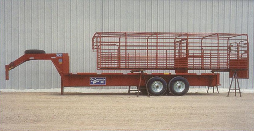

found one company that makes one, I am sure there are others,
Gooseneck Trailer Mfg. Co. - Custom Trailers, Frac Tanks & Truck Beds
I would think if one did a search and find companies that build utility and stock trailers they could build you one if you wanted, or even possibly they would build you a slide in unit, you would just have to contact the companies and see what they would do,
also do not over look local welding shops and fabricators, and or trailer shops,
(my guess is this is a one peice unit not a removable stock sides)
but plans for a build it your self, trailer
Trailer Blueprints — Livestock Tandem Axle Gooseneck Trailer | Trailer Blueprints | Northern Tool + Equipment
I really doubt if it would take much to make it a slide in unit like the above manufacture unit,
(one difference on a stock only trailer is usually the top of and the sides of the trailer are part of the support system, (usually no real frame or sides for support) but a utility trailer is self supporting (if one cut the top off a stock trailer one would not have much of a trailer, as some times the only "frame" a stock trailer is two angle iron on each side, where the springs attach to,
(so I would probably build a utility trailer and then add the stock panels on it),
(not built a stock trailer and cut or remove the stock panels top),
