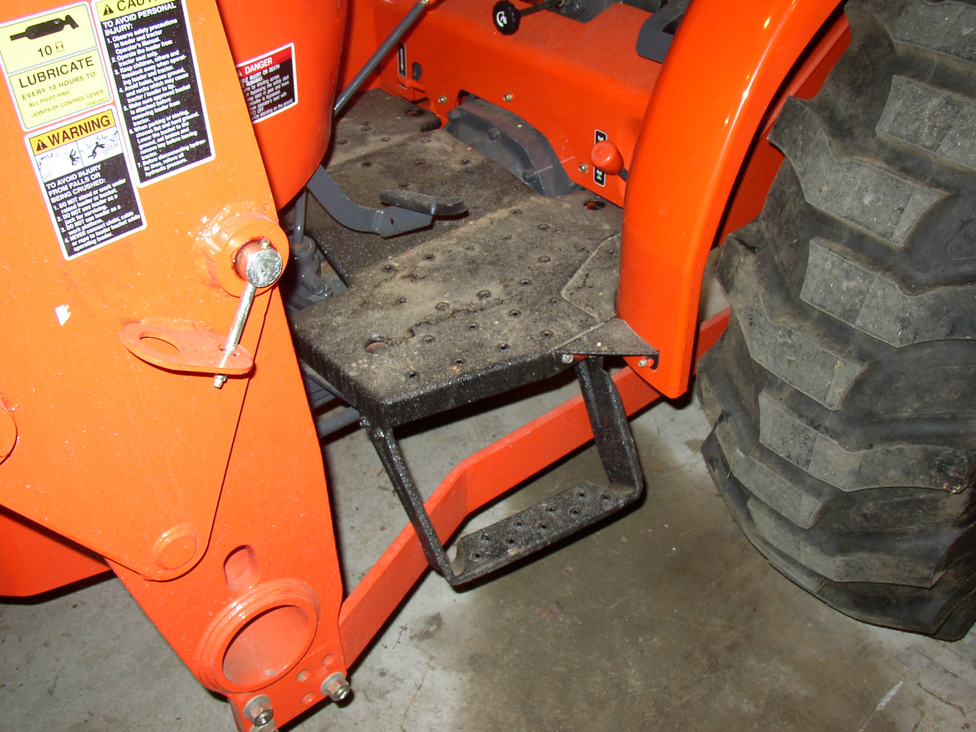

Has anyone ever used any of the Herculiner or Plasticote truck bed coating material/coating on the steel floorboards of their tractor?
my old b7500 had a rubber mat over the metal, but my new L3400 just has painted steel (perforated) for floorboards. It is very stable, but is showing some wear already, (20 hours). and I have seen other posts of these types of tractor floorboards which show a lot of bare steel. Of course I could repaint it easily, but I was looking for a more long term/longer wearing coating. Also these type of coating can be redone easily again also. The Grand L version's of these tractors have the mat, but mine is just an L. I bought a gallon of the Plasticote brand, (not much more than the quart) at Tractor supply. and coated the handle of a large pair of Channel Locks tonite that were bare metal, to see how it will do before I go rubbing it on my new 'bota. takes a lot of stirring to bring up the rubber particles in the bottom of the can!. If anyone has done this let me know. I was going to mask off the rest of the operator station and just get the surfaces your feet touch.

should work. I dont know anything about either of those brands, so depending on the thickness when it drys, you may want (if the material allows) to give it two or 3 coats for added thickness.
Thinking in terms of Rhino-Liner, from what i've seen of it, it would be tough to wear through.
I would suggest testing it out on a piece of scrap, mainly to learn how it applies and determine how many coats for the thickness you'd like to have.

There is a thread on here where someone did just that on his kubota. man it came out looking good, he even did his step.
I too am disappointed in how fast the floor paint has rubbed off.

There a bunch of options available. I used herculiner in a truck bed a few years ago. It is tough. What I didn't like was the chalkiness and it was pretty bumpy. I thonk now they have some type of UV top coast or stabilizer. I recently did some research for repainting a trailer. There's some stuff called Raptor that you spray on. I think the raptor you can get tinted. It looked pretty neat. I ended up using rustoleum's truck bed coating. You can buy it at Lowes/Home Depot and Walmart. If you want it in a quart you can get it anywhwere I bought a gallon at WalMart (in the automotive body repair section). I wanted to be able to roll it on. It was cheap also 45 for a gallon 20 for a quart. You can also get it in spray cans for touch up (or application). I haven't used my trailer much but it seems pretty tough. It also rolls on almost flat which would probably be good for slip resistance. I top coated mine with black spray paint to better match my trailer.
   / Using truck bed coating on Floorboards of tractor #10
I had the floor board of my MX5100 sprayed with Line-X. They charged $100 for it to be done, with me bringing the floor board to them.
