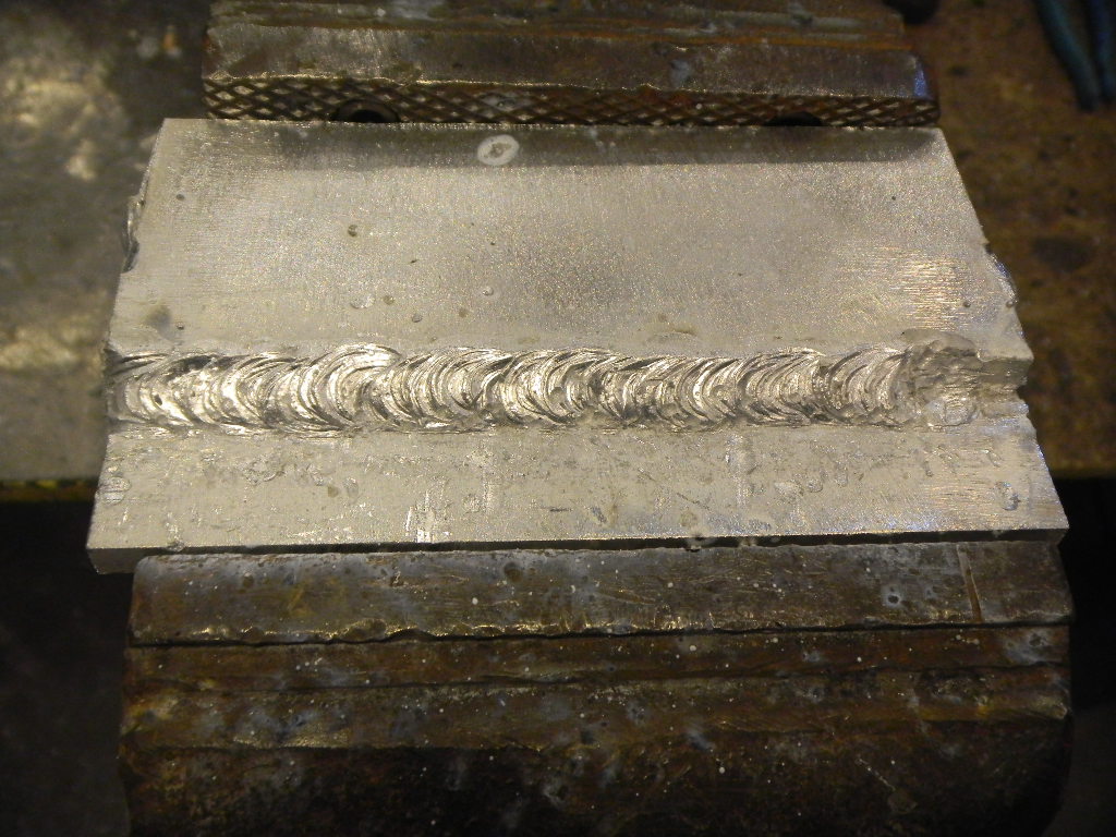

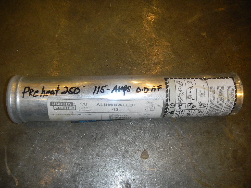

   / Using tig foot pedal for stick welding
Yes they do.
I knew that, just acting silly. Does make a case for ft control with stick tho, flux coated rods, no need for gas, control the heat with the pedal. I will have to look for a small pack of rods and give it a try.
