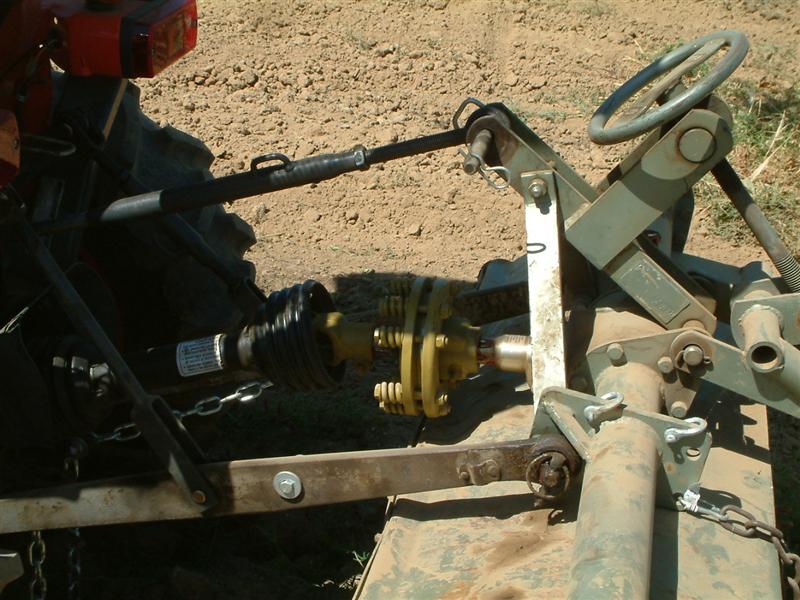

Finally got it all in order. Had to extend the three point connections out about a foot and get a longer driveshaft. The first extensions didn't hold up. The 1/4 inch steel bent all to heck and I ended up with another blown Ujoint. After cutting out the old ones and welding in channel steel extensions, finding Ujoints with actual bearings in them (the Italy made drive shaft I bought had Ujoints without actual bearings in them), and heating and hammering the driveshaft yoke back into alignment so the new Ujoint would fit again, it's working fine now. As it should be, since I've put about 2 1/2 days and a couple hundred bucks in steel and a driveshaft and Ujoints into it. Did the wifes and neighbors gardens. The darn thing actually tills so deep it finds rocks the Troybilts been missing for years. It's a long post, but it's been a long week.

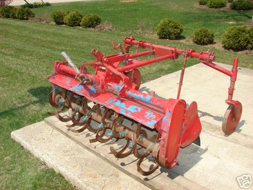

you wouldn't happen to have pics by chance of what you did.
i am having a heck of a time getting my iseki tiller attached to my yanmar. there is not enough room to attach a pto shaft. thought about making longer "arms" for the lower 3 pt links to attach to then i could get a longer pto shaft made. i have enclosed pics of my tiller. any help would be appreciated as far as pics thanks dave

This might help: Here's an old ebay auction with some photos showing how an Iseki tiller fits an Iseki tractor.

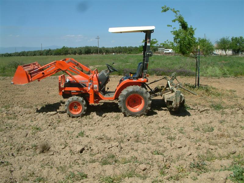

Here's what flusher offered on another tiller thread. He used Massey Ferguson lower arms to project the tiller away from the tires.
He wrote:
"I have a Yanmar RS-1200 rototiller that I use with my Kubota B7510HST (21 hp engine, 17 hp pto). It came with a 3pt setup so I can't help you with mods to your 2pt rig. Maybe the photos will help you to come up with an easy conversion.
"I could not find a shear pin anywhere on the tiller and the male pto connection on the tiller is splined. So I had to get a slip clutch and a shaft extension to keep the clutch from rubbing on the tiller sheet metal.
"The pto shaft that came with the tiller had bad U-joints, so I bought a new one from TSC and cut it to fit.
"The lower lift arms on the b7510 are only 26" long so I had to use the longer 35" arms from my MF-135 to get enough room for the pto shaft, etc."

what i did after some thinking was order longer lift arms.. mine were 27.5 inches i ordered 32 inch ones and some quick changes so it should give me some room to work with.. the problem isnt a to short driveline its no room for a shaft to fit.. literally have 8-9 inches to work with.. add a couple u-joints and there is no room for a shaft at all. so hopefulley this works.. need to find that 2 piece upper link any suggestions on where to pick one up?
