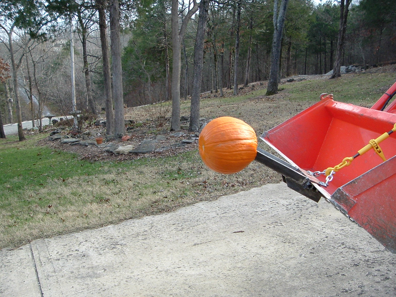

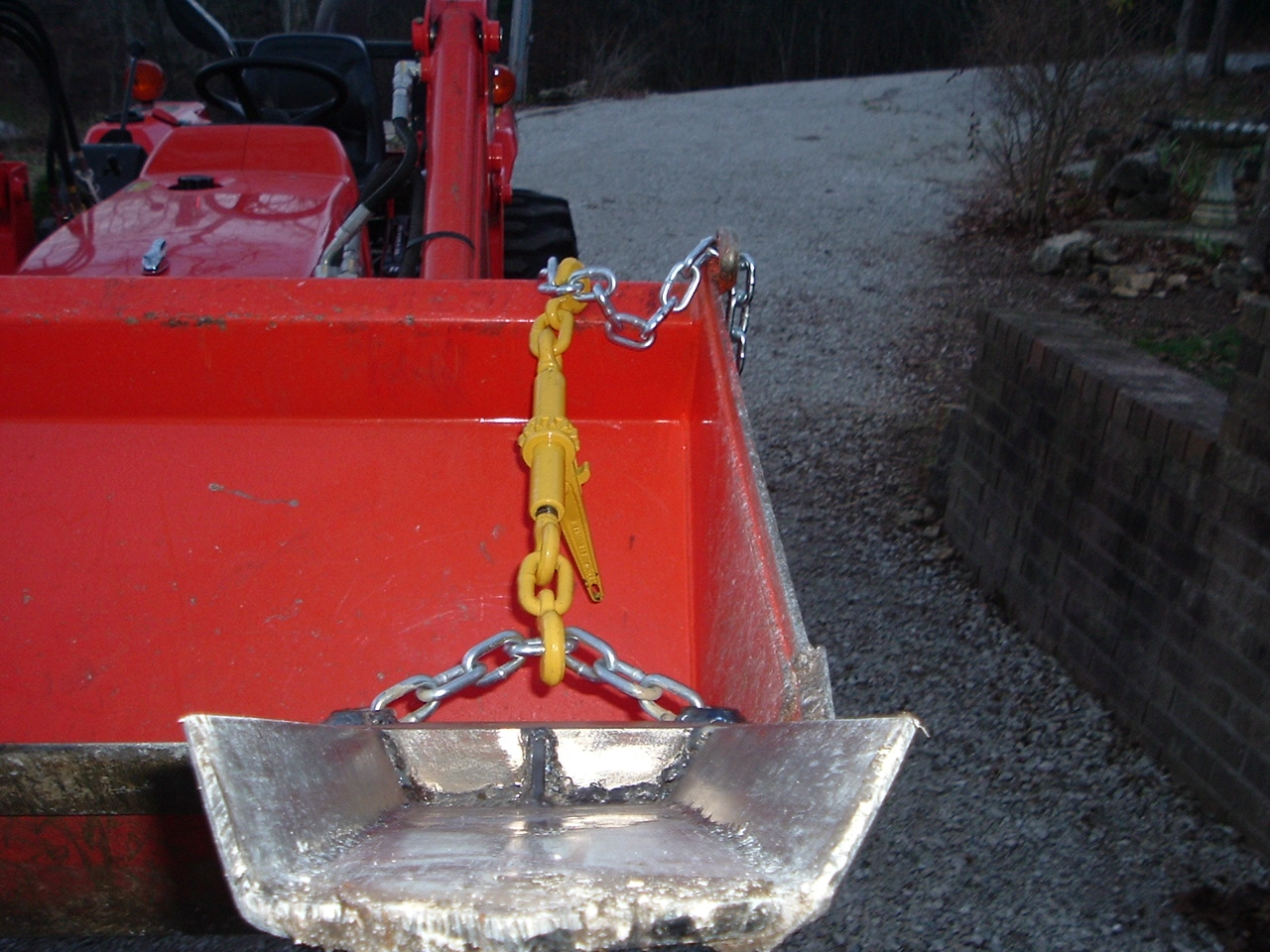

Jeff it looks like you are getting your moneys worth out of your Bucket Spade. While the home made one I have may not be quite as capable, it was cheap!:) I have less than $10 in it. I used it to dig out a very large and persistent stump, and many rocks in the yard. And have sadly used it to dig several burial graves for our pets. We have planted flower bulbs and dug several roadside trenches with it. A rather handy thing to have for little money.

I did do my own welding, and design.. I learned both the design and welding along the way (well OK, I had been welding for a while), But still the welds while strong, (they must be as none have broken) are not all that pretty, they have sufficed. The engineering I did was telecommunications engineering. That followed 21 years as a telephone technician. And that followed radio and television technician. So my design skills ain't quite up to par. And my welding skills, while greatly improved in the last 5 years, ain't nothing to really brag about.:) I might brag some, but I really shouldn't.
My point is that even though a persons skills might not be all they should be for such a project, I would encourage them to to just jump in and start doing it. It can't hurt, you will learn lots in the process
If anyone wants to see my design and fab up of my little home made shovel, and the mistakes I made along the way you can click here.
If you would like to see my fabrication mistakes and struggles with my Pin On to SSQA conversion on my old Kubota you can click here.
As you can see, I am not very skilled, at least not like some of the guys on here who are really engineers and fabricators.:) But everyone has their niche, and everyone is good at something. :thumbsup:

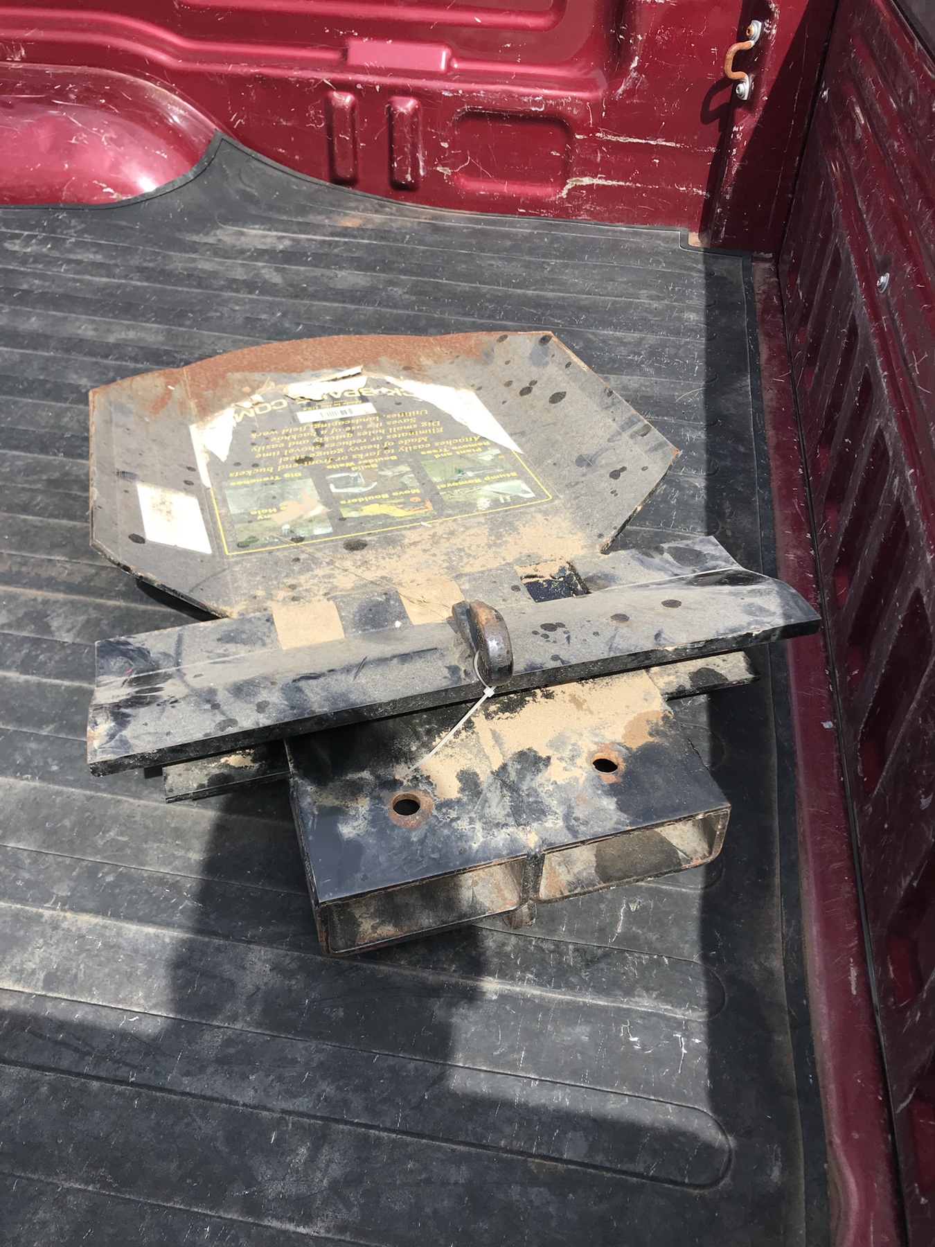

Hi guys old thread, but have found a great deal on a bucket spade. Just wondering if this has caused any damage to your bucket lip?

I have used my home built one for years now, on two different tractors the Kubota L3400hst and my current tractor the Mighty Kioti :) DK35se. have dug many different ditches with it in rocky soil. I haven't broken or bent anything yet on the bucket. Several hundred feet of drainage ditch was dug last fall for a neighbor. More rocks and roots than dirt. Use some common sense and all should be well.

Thanks for the input guys. I picked it up because it was a good deal at $75 couldn’t pass it up. Do you guys have any pictures how you secure it to your bucket? IMG_6710.JPG
