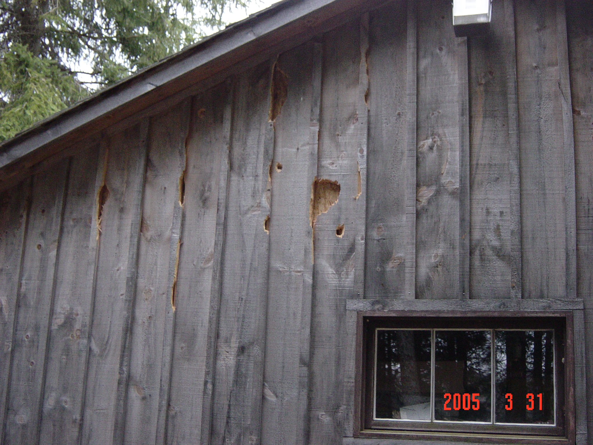

I like it and used it on several outbuildings. But the key is to keep it off the ground and most of our buildings have a four foot concrete wall.
Woodpeckers are another matter!
   / Using pine for outbuildings? #8
I've never see woodpeckers bother with sawn siding...but the carpenter bees can be a problem...
Any worms or borers (that might attract woodpeckers etc.) can be treated with Lindane
   / Using pine for outbuildings? #9
We have cluster flies and I think that is what they are after.

Pine makes fine construction lumber and decent siding too and .25/ft. is pretty cheap, I won't mill a log that cheaply...
Here's white pine board/baton siding,
Other styles of siding can be made too, no problem at all...
