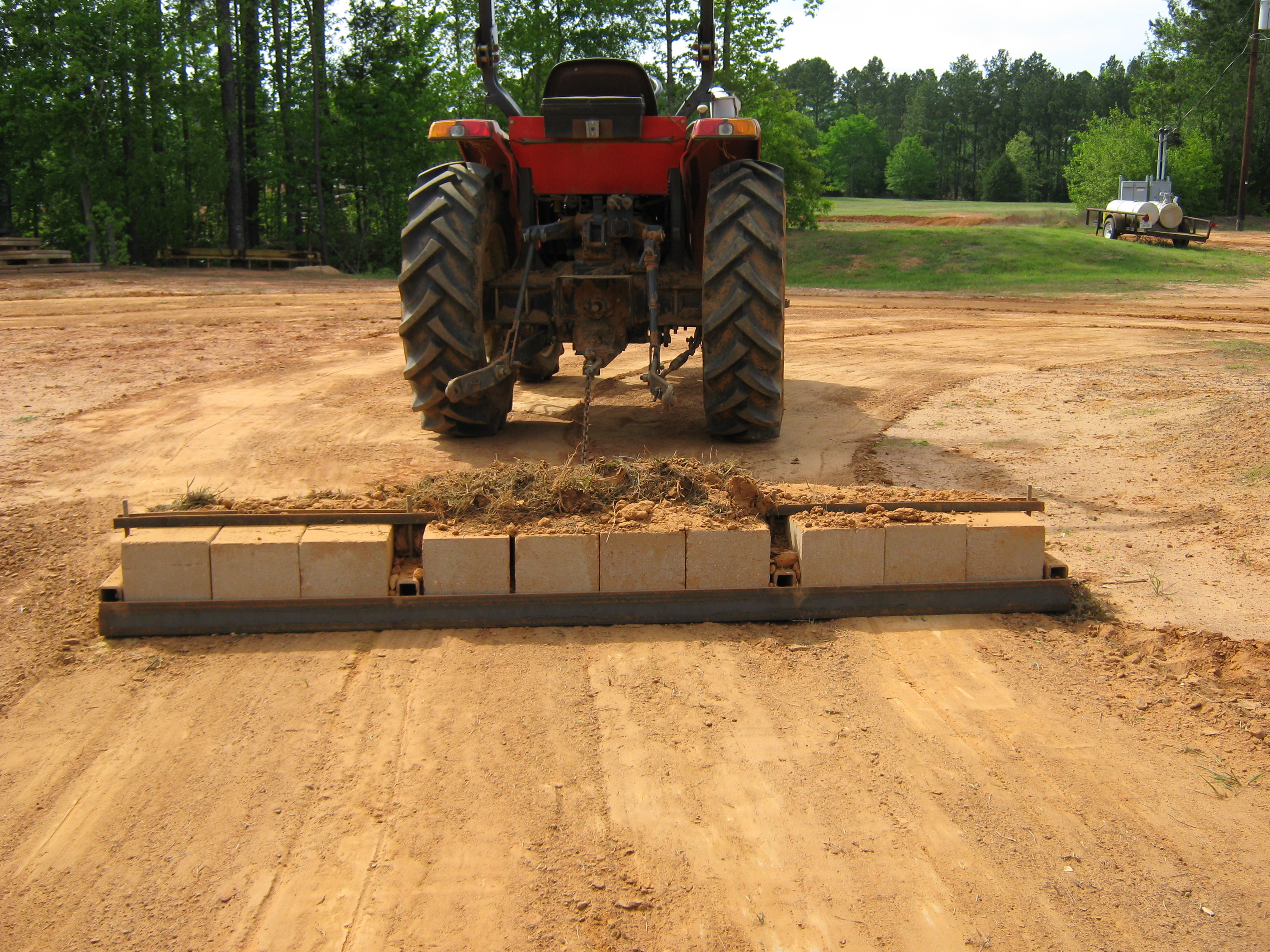

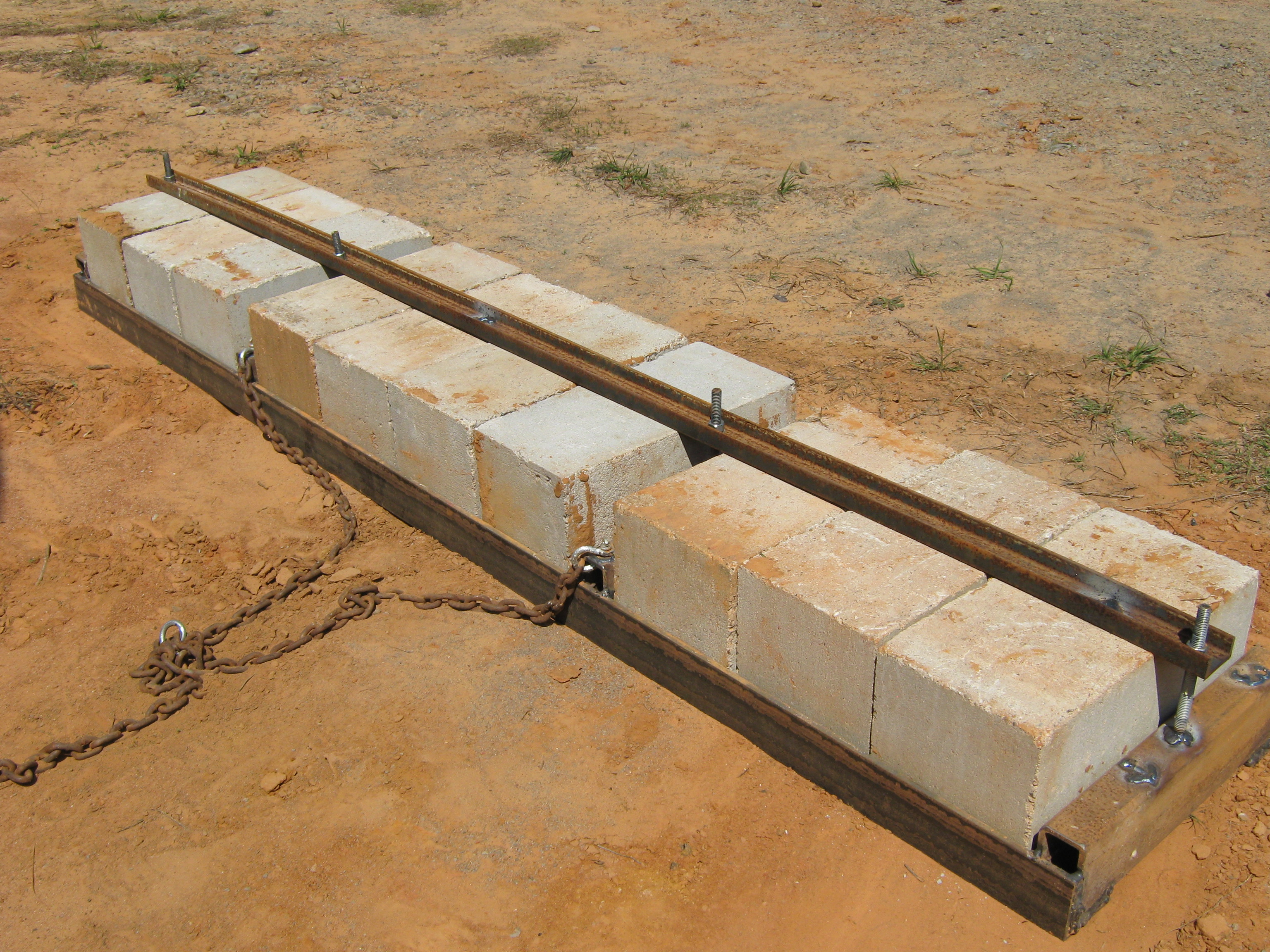

I've had some good success dragging oak logs around behind my tractor, so I don't think a drag has to be square to work. Having said that, the one I built after the log rotted away is out of angle iron and it holds solid cement blocks for weight. It cuts of high spots and it pushes the loose dirt to fill in low areas.

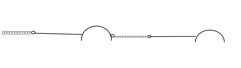

If I had those pipes and wanted to use them for a field smoother, I would cut them in half lengthways, then make a rigid hitch at least a couple of feet long to keep them with open face down when pulled, sort of like a long eye-bolt.
Several in line behind should do far more than just pulling a round pipe.

This is what I built. It's a little heavy for my 35hp tractor, and if I get into some soft soil, I stop moving and my tires dig into the ground. But my 80 hp 2wd backhoe can pull it easily no matter how soft the soil is.
