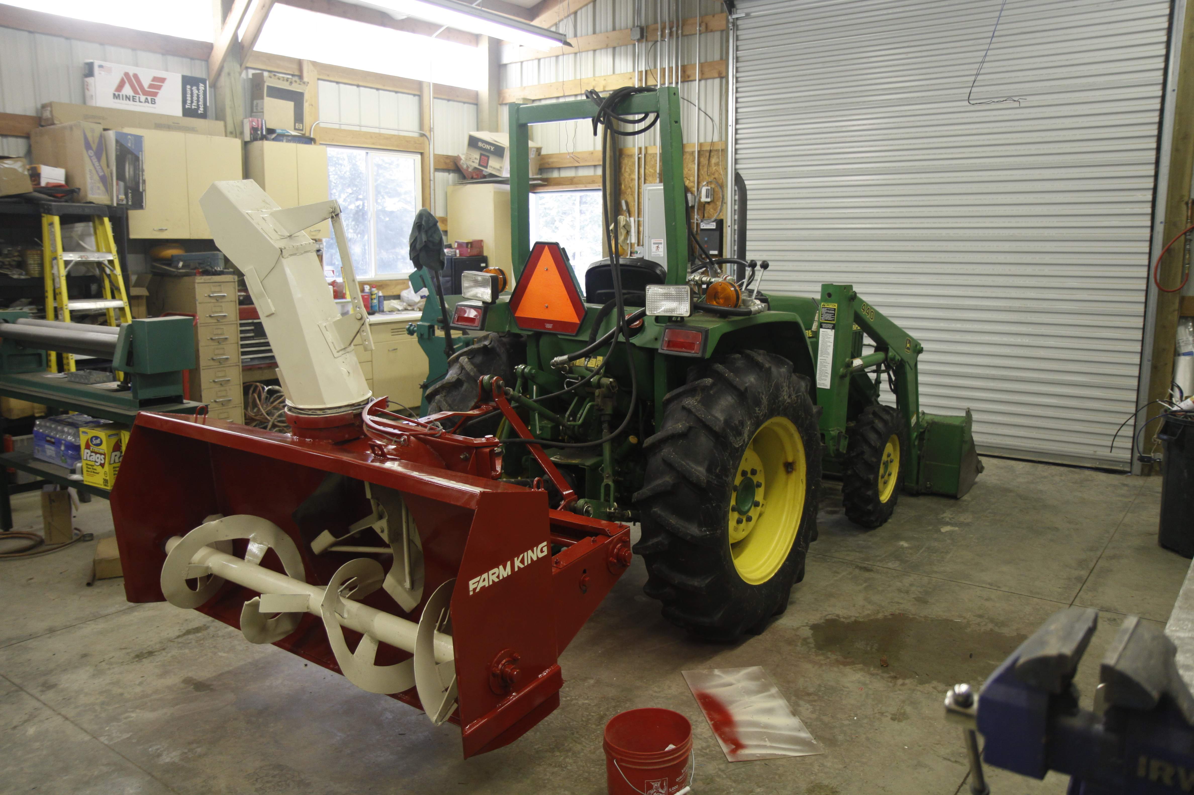

now mind you mine isnt pretty, but it works great and easy reach while operating tractor. i hope it shows up ok on the pic. the power behind are the twin connectors behind the seat. the valve is on the fender.
