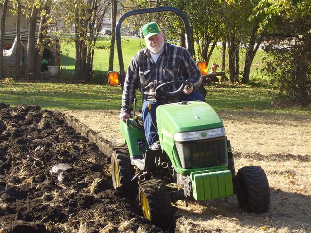

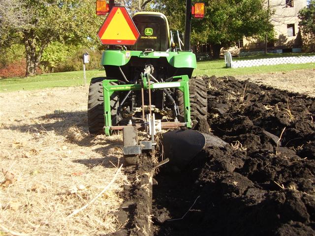

Here are a couple of pictures that were posted here, perhaps in the attachments forum....

I think that guy actually built a plow!!! That's cool. Looks like it does a great job also. Notice how he installed a "land" wheel to overcome the lack of "draft" control on the 3pt. Very cool idea.

That "idea" goes back to the '50s when IH used such a wheel on the side of their 2pt fasthitch plows as the original fasthitches didn't have draft control. Looks like JD finally caught on.....(grin). BobG in Va

That's not a JD plow. I have one exactly the same... white and all . Came with my 1978 446 Case. I think it's an IH impement. I use it on my Kubota BX 1800 with good results.

That's my smiling face on the 2305.
It is a Brinly plow with a home made hitch to fit the I-match quick hitch on the tractor. It is all stock other than the hitch. The only difference between Brinly and JD is the paint and decals.
