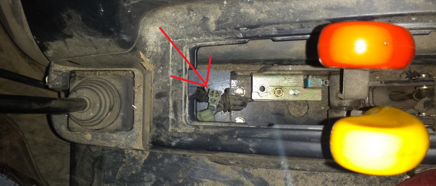

Anyone know where the User Power Plug location is on the DK## Tractor? My tractor is a DK40SE.

Well after a some wire chasing I found it. See attached picture, I removed the draft levers plastic trim to get at the plug. The plug has two 20amp fuse circuits, these are shown as "User Power" in the fuse panel and service manual for user installed electrical devices. Already fused just not connected to anything.
