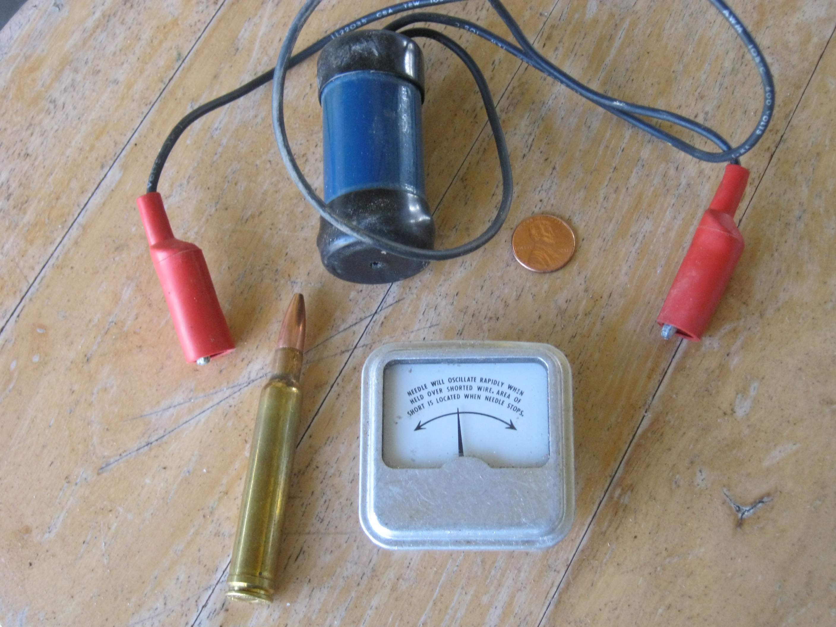

I've owned that electrical / short tracking device maybe for 20 years.
I almost jumped out of my chair when I saw the price that there selling for nowadays.:eek::shocked:
With my pic I took it with a pennie and a round from my Weatherby 300 magnum so you can get an idea how big it is. Amazon.com: SG Tool Aid 25300 Short Circuit Detector: Automotive
Btw its something I don't use much but good to have. Might have originally purchased it to work on bigrigs or trailers but don't remember that either.

Yes I agree it is somewhat pricey, but I already paid a guy to find the short a couple of years ago and figured this might be cheaper in the long run. Especially if you consider the cost of fuses. Put in a fuse, try to figure out what made it blow, put in another fuse, etc. And...can't tell when the fuse blows unless you are looking at the tail lights. Being able to have the device furnish power to the circuit and buzz when there is a short, and quit buzzing when there is , gives you at least a chance to find the problem. This might be the only time I find a use for it but if it is fixed it will be well worth it.
