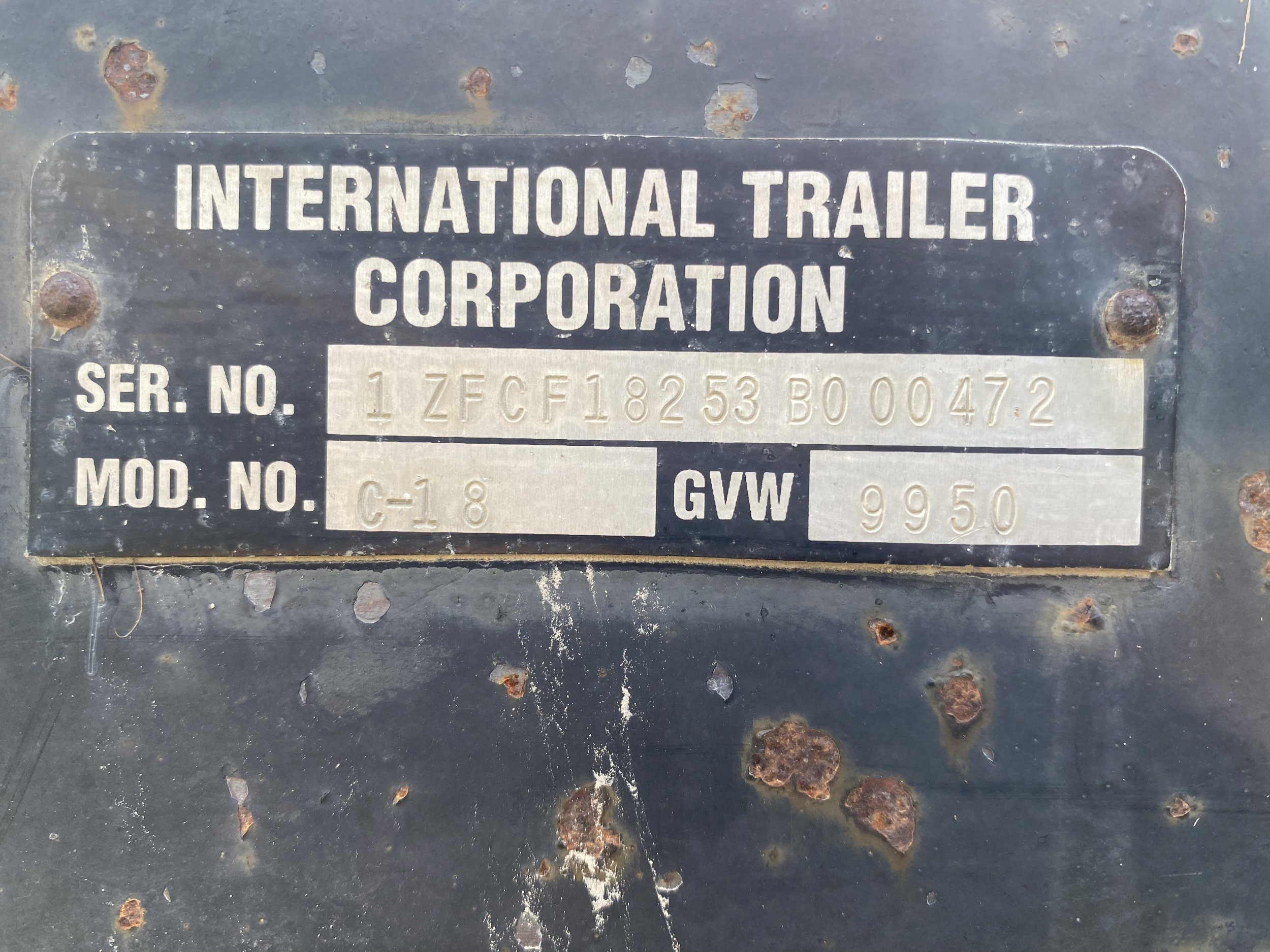

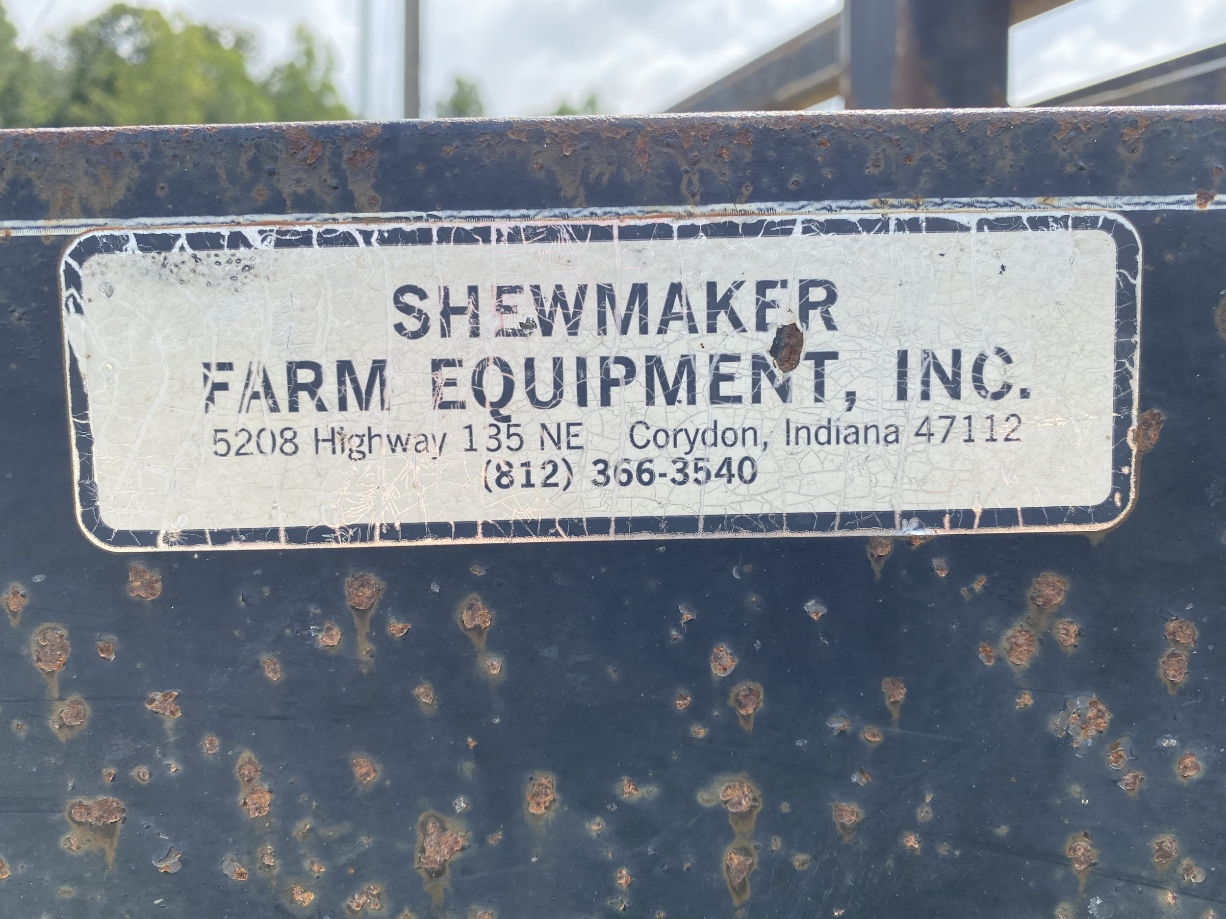

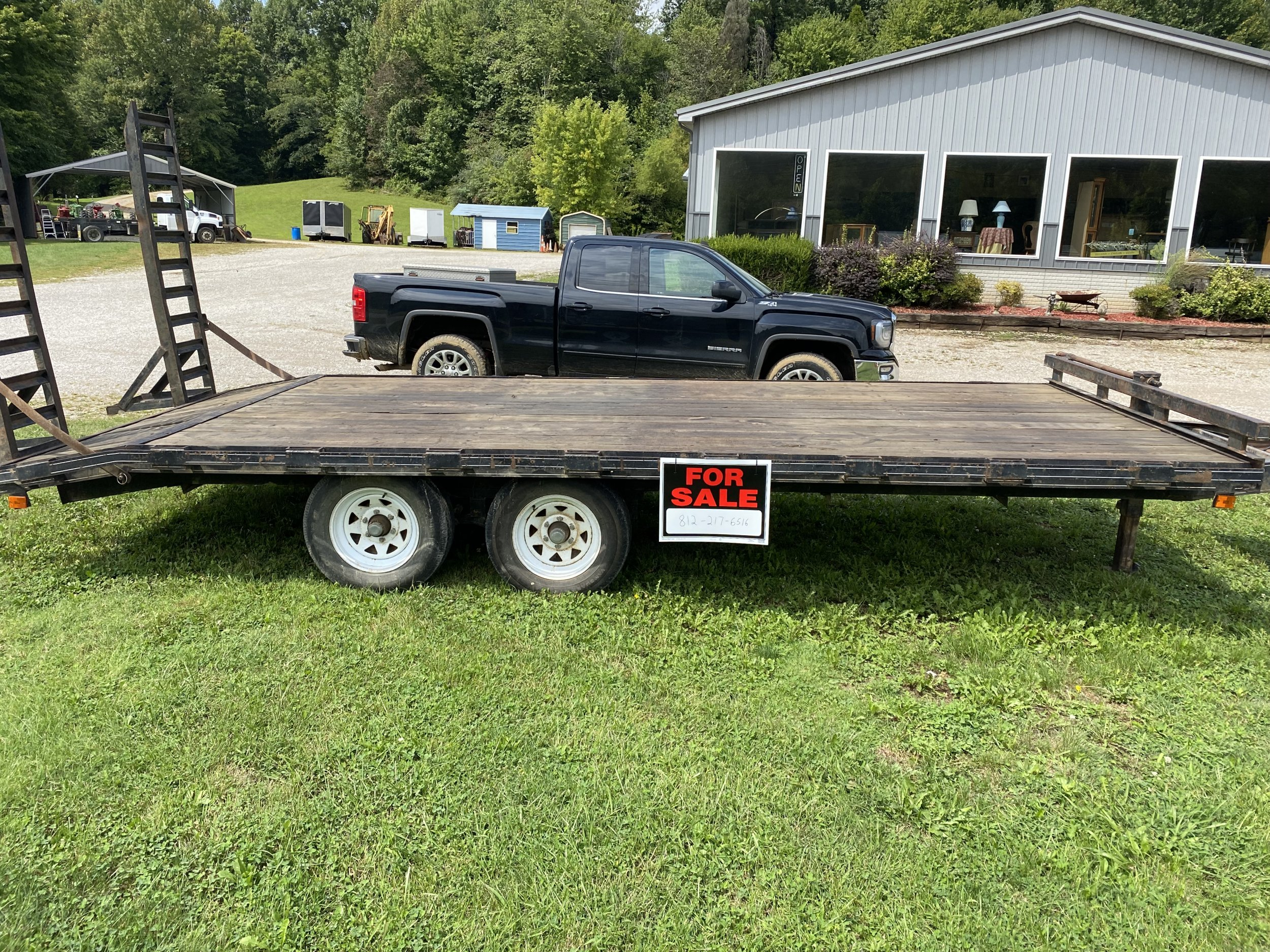

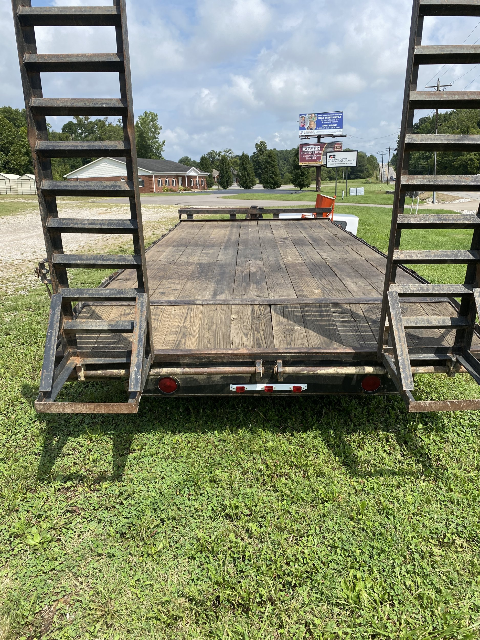

So I’m not knowledgeable on trailers what so ever. Just upgraded my tractor and seen an old trailer from 1999 for $3,000 that is rated for my tractor/backhoe.
The guy is a farmer and the trailer has been used to haul hay and a 75hp tractor. Never had brakes, axle or suspension replaced. I’m surprised he’s used it for 20 years and never needed new brakes.
What do I need to look out for? I have a nice new trailer about 2 years old 18 foot, 5,250 pound pay load. I could probably almost come out even after selling it. My Tractor/backhoe weighs 6,700 pounds. Thank you.

If you purchase maybe wise to replace brakes,also look under trailer check metal cracks and welded joints...20 years.
   / Used trailer what to look for #3
I’d check to make sure the axels aren’t bent or springs or spring hangers damaged from overloading. Also check the tires for visible dry rot. I’d plan on spending about a hundred a wheel for new brakes.
   / Used trailer what to look for #4
Besides checking tires visually, find the date code. You may be buying tires right off.
   / Used trailer what to look for #5
guessing the trailer with that load has to have brakes to be legal on the highway.
I paid just over $3000 two years ago for a 18' trailer double axle 8lug wheels and 12 ply tires to match. also ramps. It will easily (and legal) carry my 6500lb mini-x.
Also if you are border line on max weight you can move the tractor forward on the trailer to have the truck carry some of the weight.
shop around...
   / Used trailer what to look for #6
That’s probably heavy duty enough for your load but not by much. I’d probably jack it up and spin the wheels and check for play.
   / Used trailer what to look for #7
You can tighten up the spindle nut and fix that. Even if it needs bearings that’s a cheap and easy job.
   / Used trailer what to look for #8
Brakes may have never been replaced because they were never hooked up.
