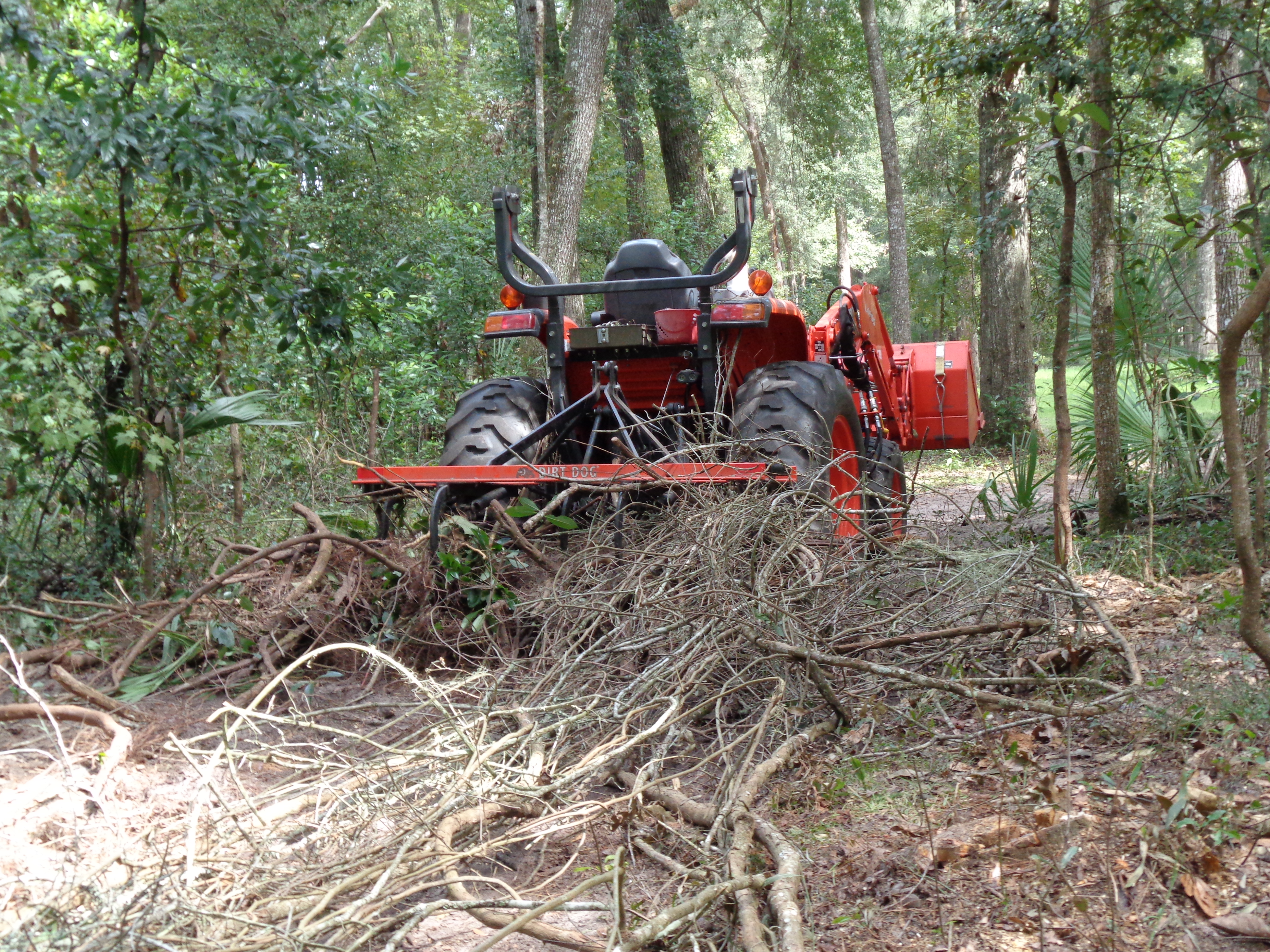

Another option is a three (3) tine, spring-protected Field Cultivator for garden prep and for dragging debris. Dirt Dog builds compact tractor implements in Georgia.
3-Point All Purpose Chisel Plows
A third garden option is a Ratchet Rake bucket attachment. Photo #5 - #7. Ratchet Rake will grade your two drives easily.
Ratchet Rake will pile and pull/transport Bouganvilliea trimmings moderate distances.
VIDEO: ratchet rake brush clearing - YouTube
I recommend against a grapple on a subcompact tractor. The thin front axle is a weak point and a grapple puts more weight there. Also, grapple loads reduce tractor stability.
