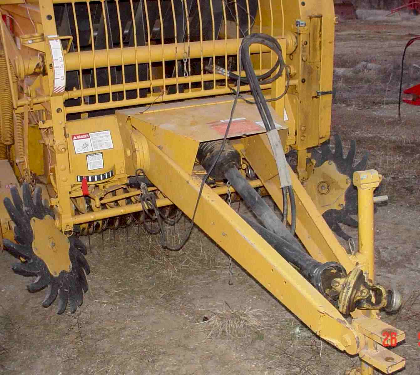

Guys,
Its time for a round baler.
One of the options is a vermeer 504 Super I.
This one is used, not sure of the year, and pretty clean other than the usual mud and left over hay in a few places.
Anyone familiar with this partciluar design?
Good expereince bad expereince?
What would you look for and what would it be worth?
Thanks for the input.
Fred

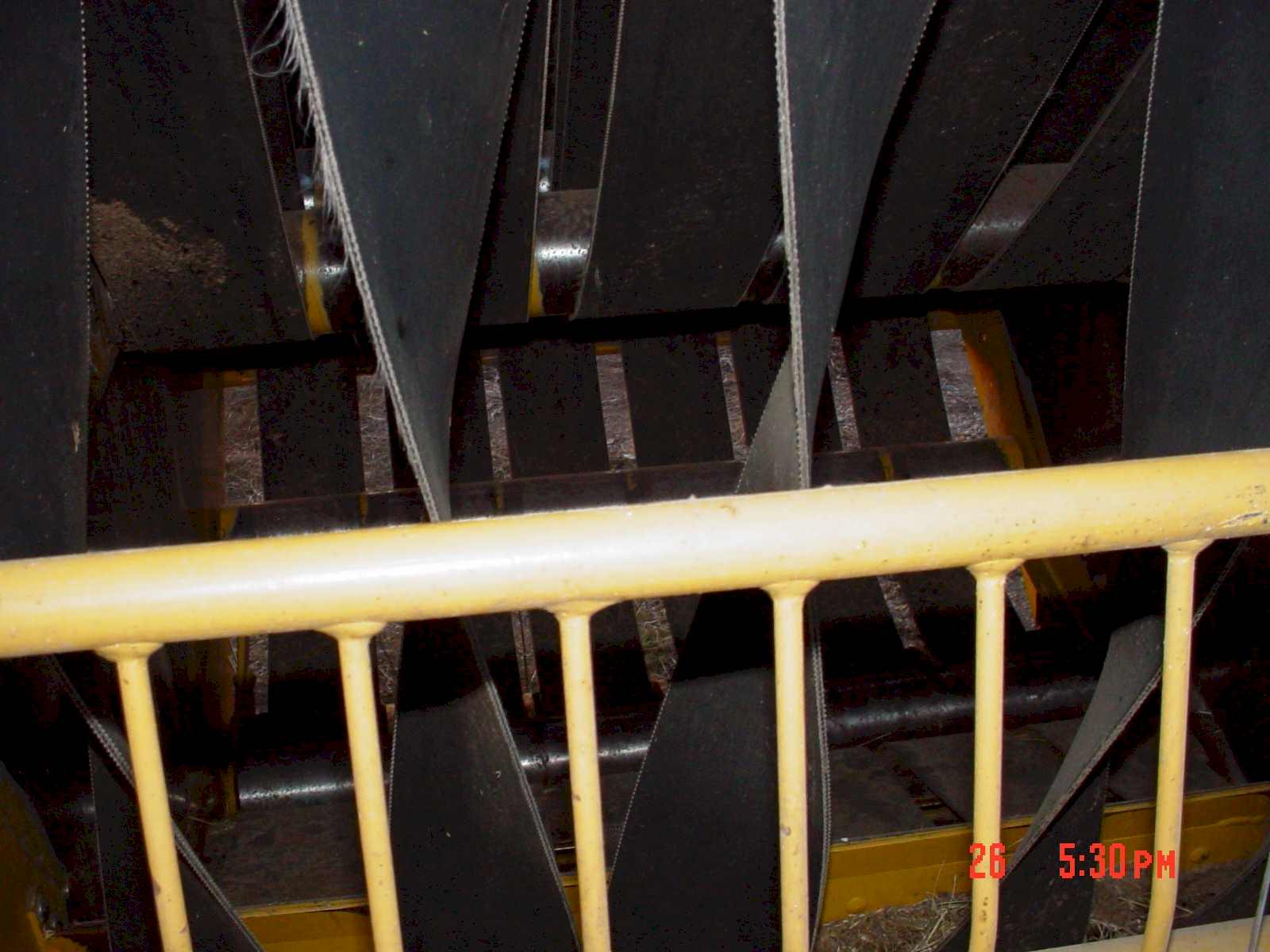

Here is another shot of internal workings.

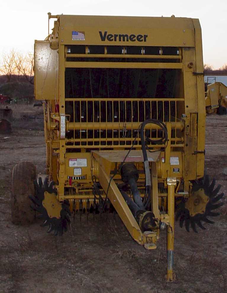

Close up of front end.

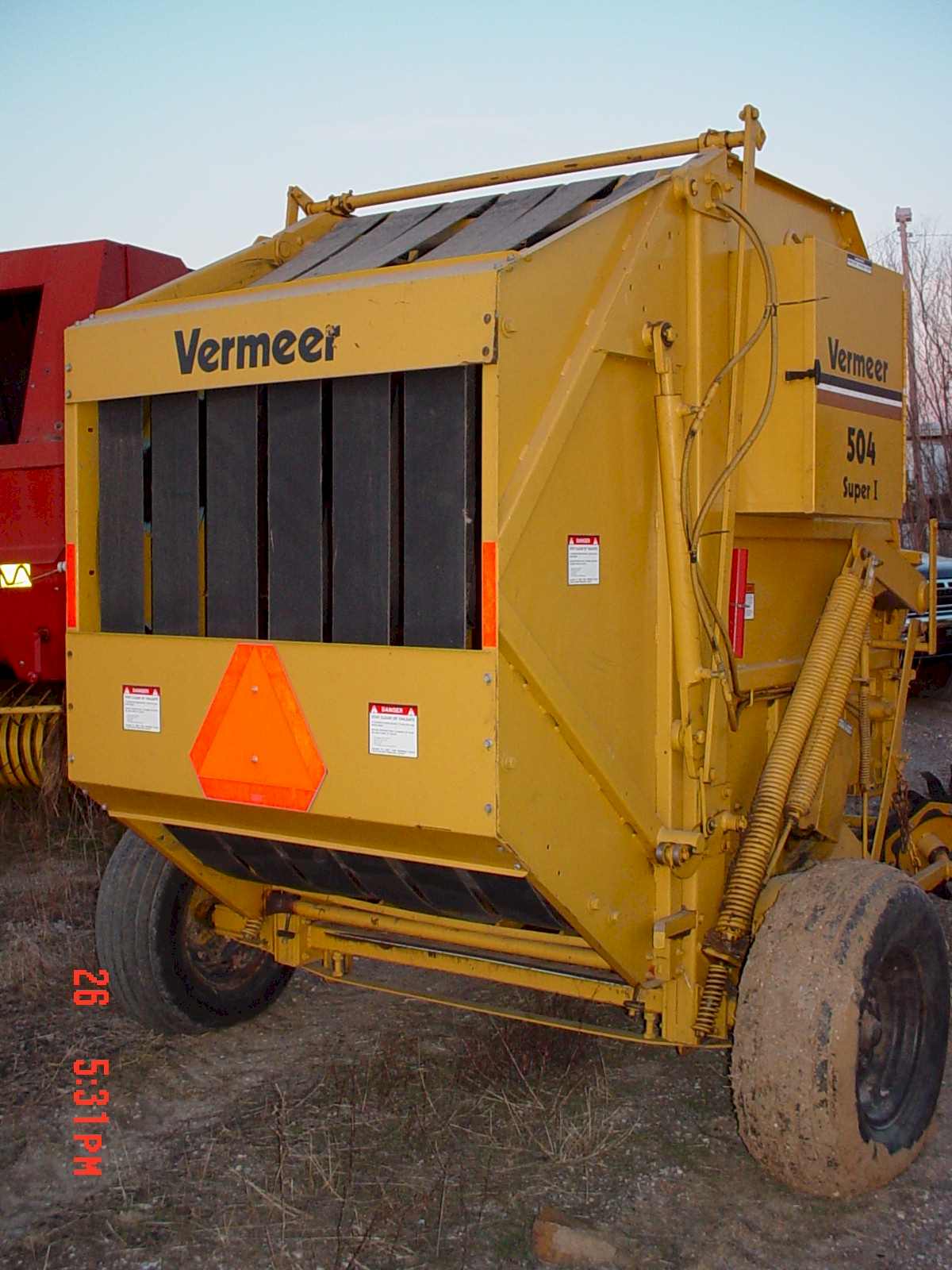

Shot of backside.

   / Used Round Baler #6
Phred,
This is a 1992 model baler and is in good shape. It looks like it has been kept in the dry. It just needs some adjustments but it is worth $5000-6500 in my area. We sold them new that year for $10,500 and the rule of thumb is a Vermeer baler can be run for 10 years and its worth at least 50% of what its sold new for. The baler needs 40 HP min and makes a bale up to 5' tall and 4' wide, about 1200 LBS in dry hay.
If I traded for the baler I would do the following.
1. Lace all the belts to the exact same length
2. Clean out the dirt in the belt tension springs
3. Track the belts by using the alignment adjustments built in the baler. The belts have some frayed edges on the twisted belts meaning they need to be tracked so the run true.
4. Advance the pickup timing 1/4-1/2" to make up for some wear.
5. Adjust the pickup teeth to within 3" of the square starter roller.
6. Adjust the wind guard so its travel is restricted to 1" below the top of the pickup teeth.
7. Repack the wheel bearings
8. Check and adjust the double twin tie and put new knives in it.
10. Check the toggle roller on the tailgate to make sure the allen head bolts are tight.
The condition of the baler is better than average. The hay saver wheels do not show much wear so that is the first sign it has not baled great amounts of hay. The stripper bands,guide fingers, have most of their paint on them and seem to be in line. If they are in line that means nothing in the pickup is bent from hitting a stump or rock. The pickup is designed to bale 50,000 bales before the cam bearings need to be looked at. This baler has baled 2,000-5,000 bales which is nothing. Sandy soil is harder on the pickup but if it was in much sandy soil the paint would be all gone off the stripper bands. The tongue looks to be straight so I do not think it has been turned over. Check to see if the door on the leftside is true.
