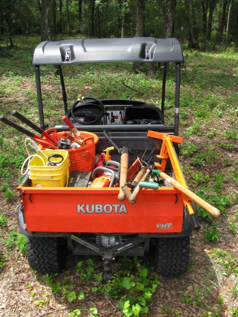

I have an RTV500 with 700 hours. I would say mine gets medium duty use. Absolutely no issues beyond recommended service intervals. I intentionality let the gas tank get almost empty before filling with FRESH gasoline.
I have optional roof and optional turf tires, turf give a smoother ride on roads. I have never been stuck, with or without trailer, in 700 hours. Rarely use 4-WD. Less noisy than the diesel RTVs but I still wear ear muffs when operating. (At age 67 trying to preserve the hearing I have left.)
Max speed 25 mph.
