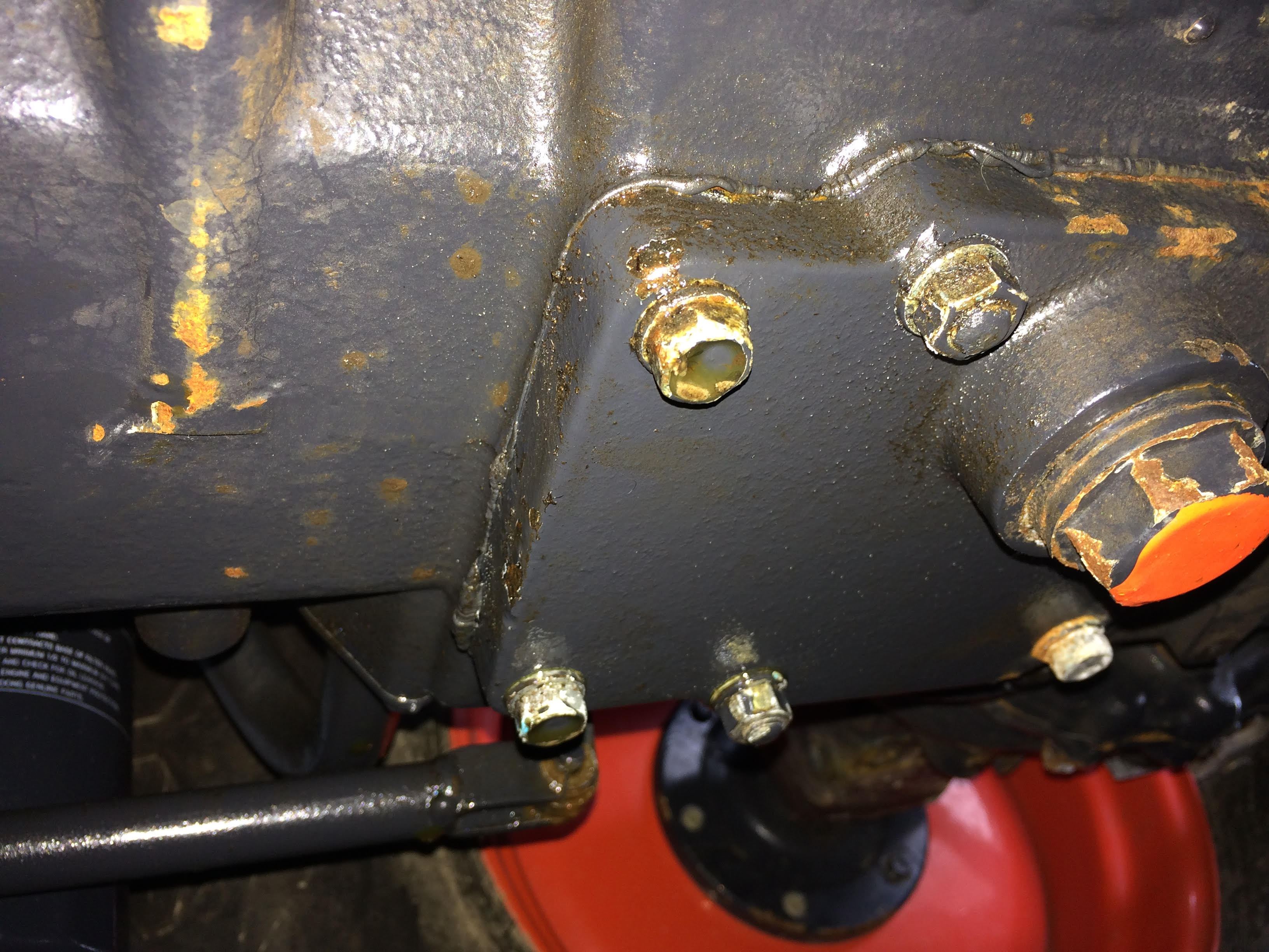

I am looking to purchase my first tractor and am looking for some advice. I have about 2.5 arces of property that is a mix of yard and woods. I have a lot of large rocks (3-6ft) that i want to try and move on the property. In addition to that i plan using the tractor for general stone and dirt moving and firewood hauling. At this time i have no intentions on using anything off the PTO. Down the road i want to get a 7.5-8ft backhoe. I do have a small landscaping business and it will be used to load mulch and transport a large amount of mulch.
My local dealer quoted me 17,898 for a ck2610hst. He did say there was some wiggle room on the price since they have had the tractor for a while. At that price my payments would be 298 at 0% for 60 months.
There is a used 2014 ck35hst 140hrs that i look today that appeared to be good condition. The owner said the main valve for FEL was replaced by the dealer due to a lack of power in the front end loader. In addition to that the hydro fluid was low (right at the low mark on dipstick) and and there appeared to be a leak around the drain at the rear differential. See attached picture. He said that he would have the dealer take a look at it. I got him down to 13,700 and that includes a 6 or 7 foot rear blade and a sunshade. I would have to finance this as well. So basically with the given interest rate i would pay 16,300 if i don't pay it off early. I do plan on paying it off early though.

I'd stay away from the CK35. You're new to this, and it look like it needs at least a good check up. Nothing wrong with the 2610. The price on the CK is high IMO. 2.5 acres, you are going to run out of room with the CK35, it's not exactly small.
   / used ck35hst vs. new ck2610 #3
I had my CK30hst for almost 11 years now and 800+ hours. I've only had to replace the fuel gauge sending unit while under warranty. Mine doesn't leak anywhere. I know the dealer said he would take a look at the leak but that should have already been done along with a good going over so the dealer knew he was selling a good working tractor. 140 hours on the CK35hst isn't much and I guess each tractor can have it's problems but what did the previous owner do or not do to it. With the 2610 only @400lbs lighter but a little more fel lift, I would just load the rears if your worried or run with an implement. 9hp more would be nice but you said you won't be using the PTO. I think I would go for the 2610, have a full warranty, and enjoy your first tractor purchase.

jMO, I would stay away from THIS CK35. Has had loader valve work, leaking and the warranty is probably just about up.
I would think about getting a cash price for the CK2610 hst with backhoe and get your financing elsewhere. Agri credit, home equity, wherever. With 0% financing you are paying for the financing up front. You will have to run the numbers yourself to decide. Search TBN about financing for other opinions.
