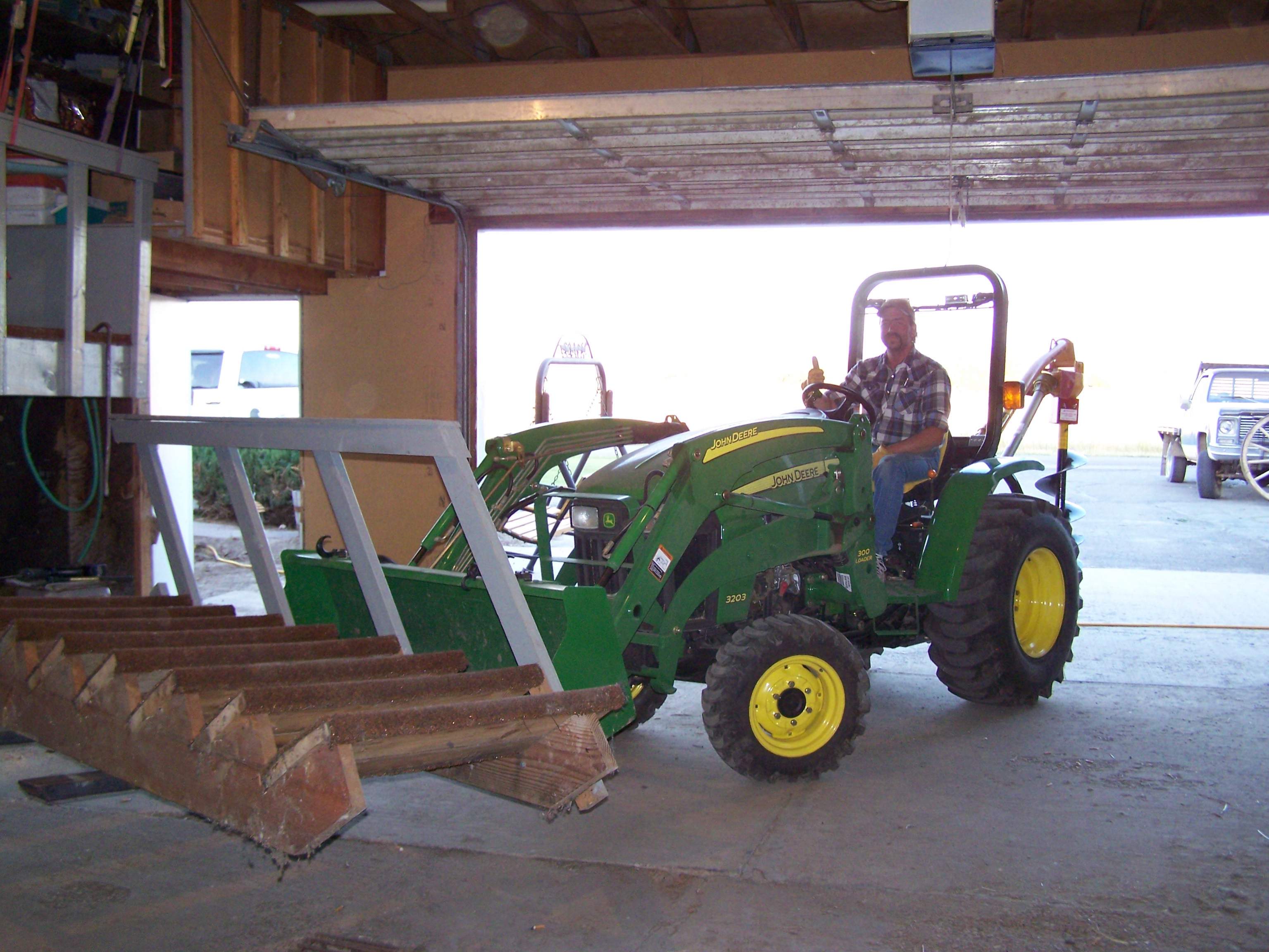

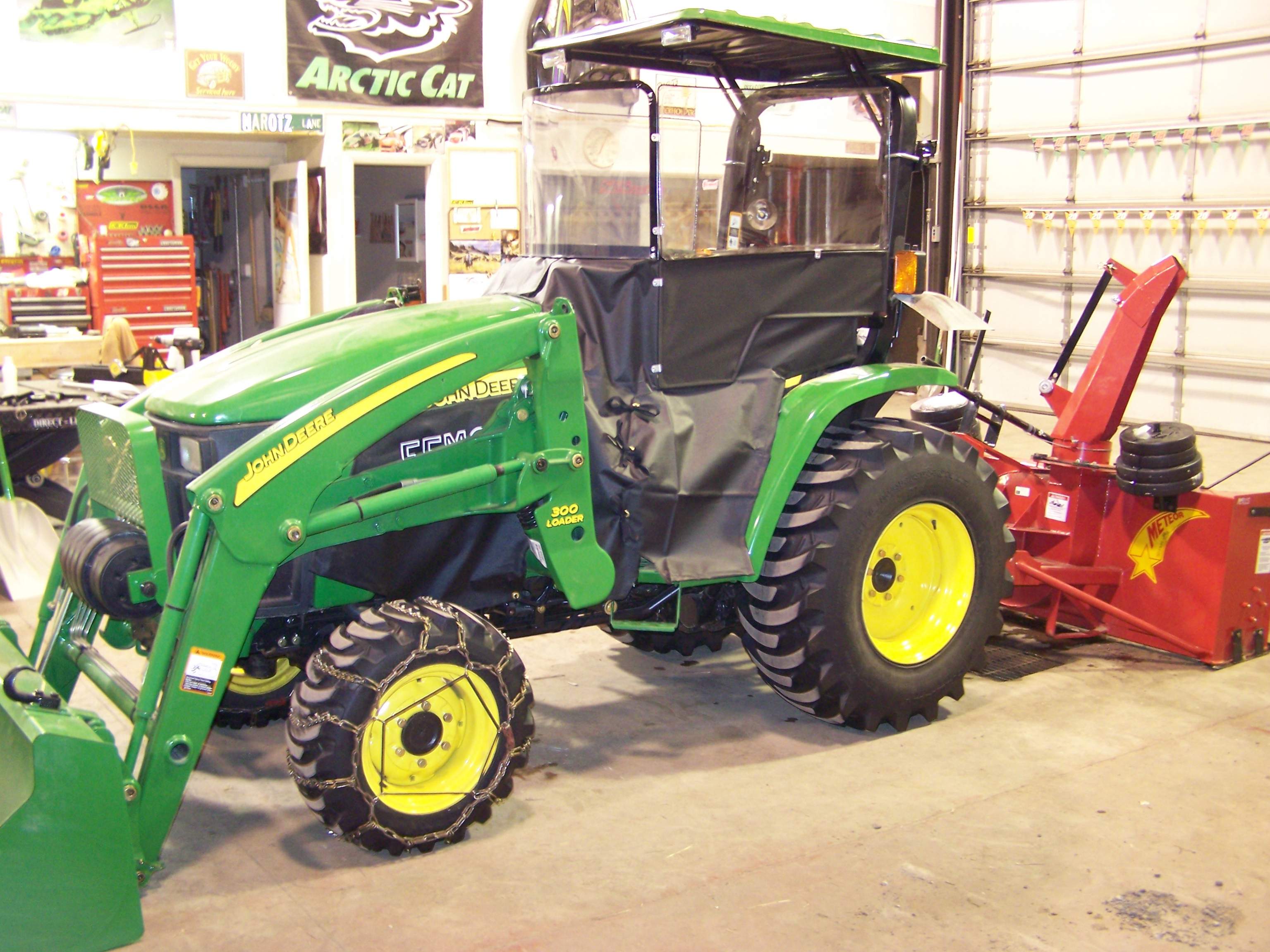

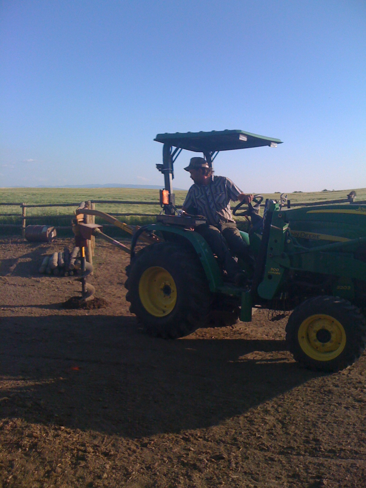

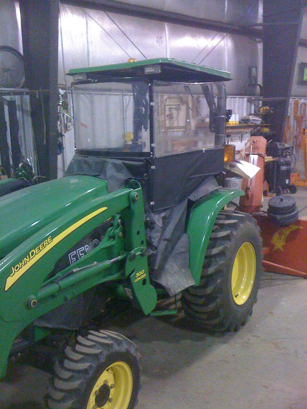

The 3203 is a very nice intro tractor with capabilities that MORE than surprised me when I bought mine. I put 380 hrs on it without it ever seeing a wrench other than oil changes and add ons I did. She helped me install close to 400 fence posts with auger, load literally tons of scrap steel to make room for horse corrals, blow snow, load horse manure, subsoil pastures, move snowmobiles, haul gravel, you name it she done it. Sometimes you would lug down a bit, but easily regain your power by backing off the pedal.
My wife, ( with NO experience) with tractors picked up on how to run this machine in little to no time!!! Heck, even my daughters helped a bit with it, (under supervision).
Spring of '10 I did upgrade to a cabbed 3720 because our needs for larger tractor with more capabilities arose. All in all I would recommend a 3203 to anyone for ease of operation, simple no frills extra gizmos to worry about, and just plain good lil tractor. As for the seat PTO switch...(that can be solved in under 30 seconds;))
