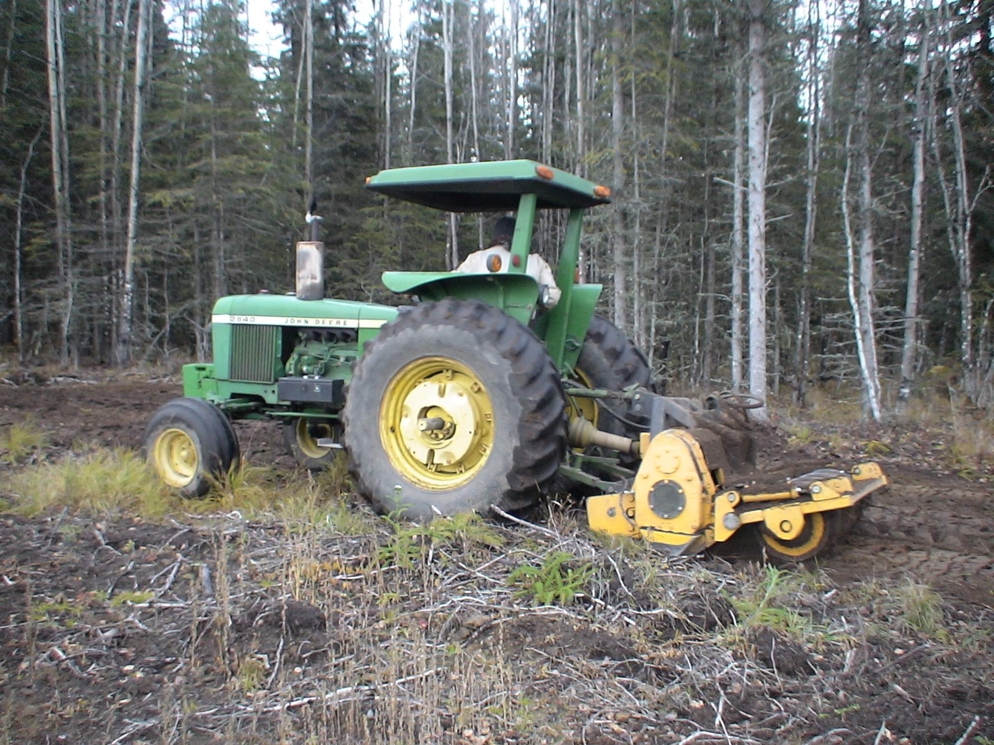

I used a friend's 2640 this past fall to work up a new, 3 acre pasture and get it ready for planting.
Great tractor! Lot's of power for the frame size! Needed full wheel weights to keep traction.
My friend has owned a couple of 40 series utility tractors and his take on problems with them was to avoid the machines with the reverser tranny or the overdrive tranny.
He said the tranny won't hold up with the rest of the machine for the number of hours that the tractors will normally run before a major rebuild.
If you find one with the 8x4 tranny - get it!
