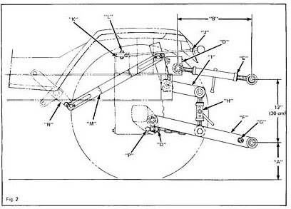

   / Upgrading/Upsizing 3 point hitch... Need your honest opinions and fabricator leads #4
These might help.
You could search eBay for three point hitch kit or buy the parts at Tractor Supply.
Keep us posted. :D

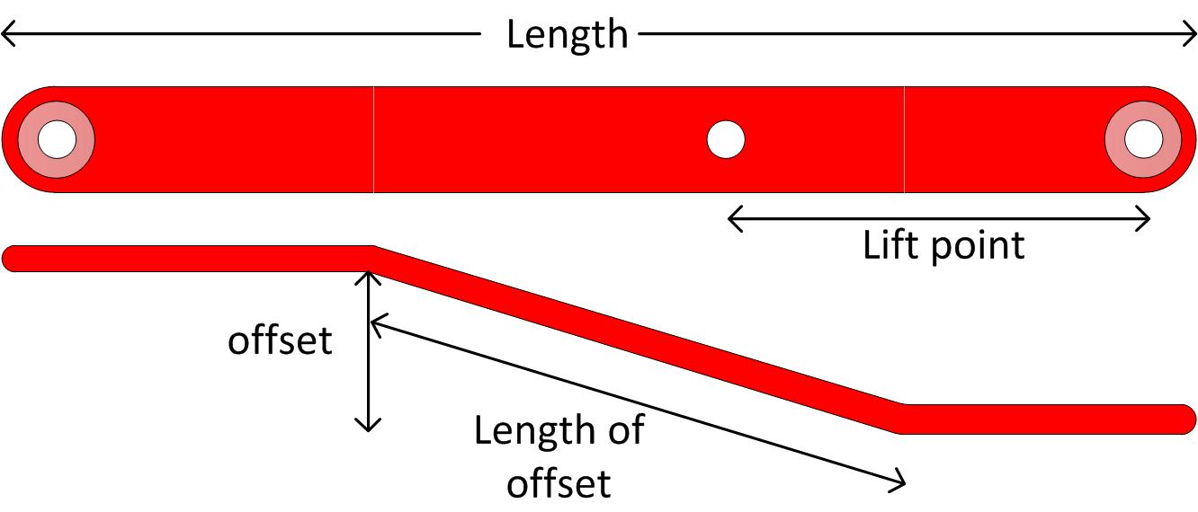

Keep the arms you have now if you can get the 26 inches between the arms. Chop off the ,"0" end for the implement and weld on the cat 1 ends. same can be done with your top link. I would go with a type 1 top link and buy the bushing to reduce the Tractor end back to 0. I do know the top link used to be 19.99 and the reduced bushing was 2.99 at TSC.
I actually don't want to start hacking up the HH34 hitch, come spring I can quickly sell it for 7-800 dollars. Perhaps even now.
Doing what you suggest, wouldn't I still have Cat 0 hitch geometry ? Still 12" instead of 18" (distance between lift arms and top link)
