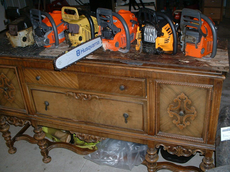

   / Upgrading Husky 550 to 7/32 chain; good idea or bad? #4
I always ran my 50cc saws with balls with 3/8. Was always faster bucking with 3/8 back then with 346, 5000, Gen1 550 545.
325 is smoother and use it on 50cc for limbing etc and bucking now days too.
325 chains has got better now and caught up with 3/8 stock for stock if running the stihl RS pro narrowr kerf
